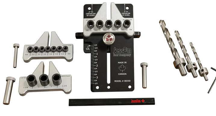

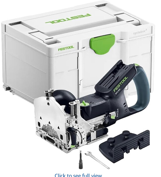

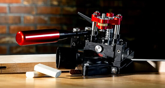

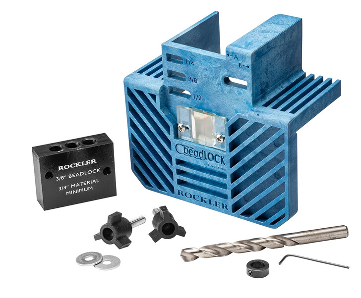

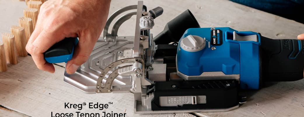

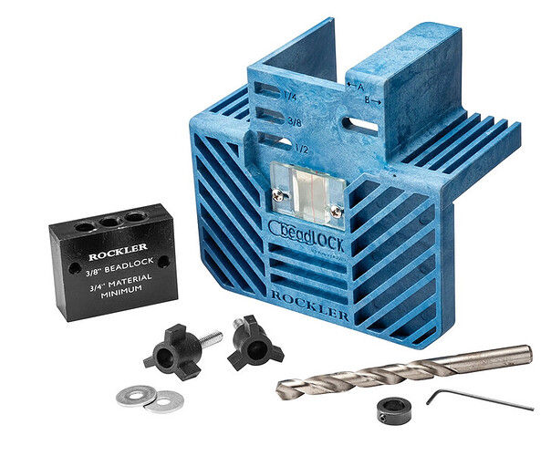

If you need structural strength in joints than Domino loose tenons are much stronger and the Dominos fit much tigher in their mortises. There are also things like Rockler’s BeadLock and even dowels are stronger than biscuits. Kreg is coming out with a cheaper Festool Domino alternative. Jessem makes a jig to make Domino mortises and Kreg also makes a similar jog to the Jessem one. The Festool Domino has been around a while but it is expensive.
