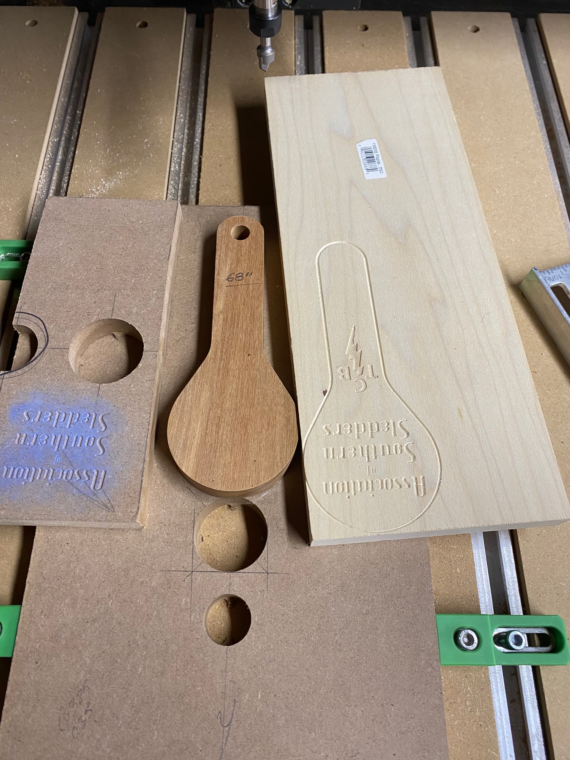

I have a Pro5 2x4. On the table I have MDF that is 0.765” (Z) clamped as my fixture to hold the product part to engrave text. The product piece is 0.63” (Z) thick. I have preformed this once on a final stock sized piece with success, but did not like the way the text looked. I switched to MDF to try other text styles. I went in the CAD file I changed the stock thickness to 1.53” (0.765x2=1.53) and ran my trials again with success. After deciding on what text to use I affixed the product piece (0.63”) to the MDF fixture and went back into the CAD file and changed the stock size to 1.395” (0.765+0.63=1.395) SAVED the file, loaded the new file onto Motion and ran program. The result was the cutter appeared to be referencing the MDF height (1.53”) cutting the air above my product piece. This is clearly not a case of the table not being true as it has worked before and the only thing that has changed is the stock thicknesses. I have tried this several times. I have shut everything down, restarted, reinitialized the cnc. Went all the way back to the point of performing the first starting the cnc steps. Reinstalled/initialized the bitsetter (the Z reader). I have saved the file as new tool path with no success. I even reset the VFD height ensuring that it would be able to reach required depths. Also, the machine goes through all the steps with bit setter checking each bit change and bit setter seems to be working fine, green lights at each touch off.
Cliff notes:
Machine appears to be still referencing the previous stock height of the two MDF boards and will not engage in the new lower stock height even after saving new tool paths. I thank you for any help and insight.

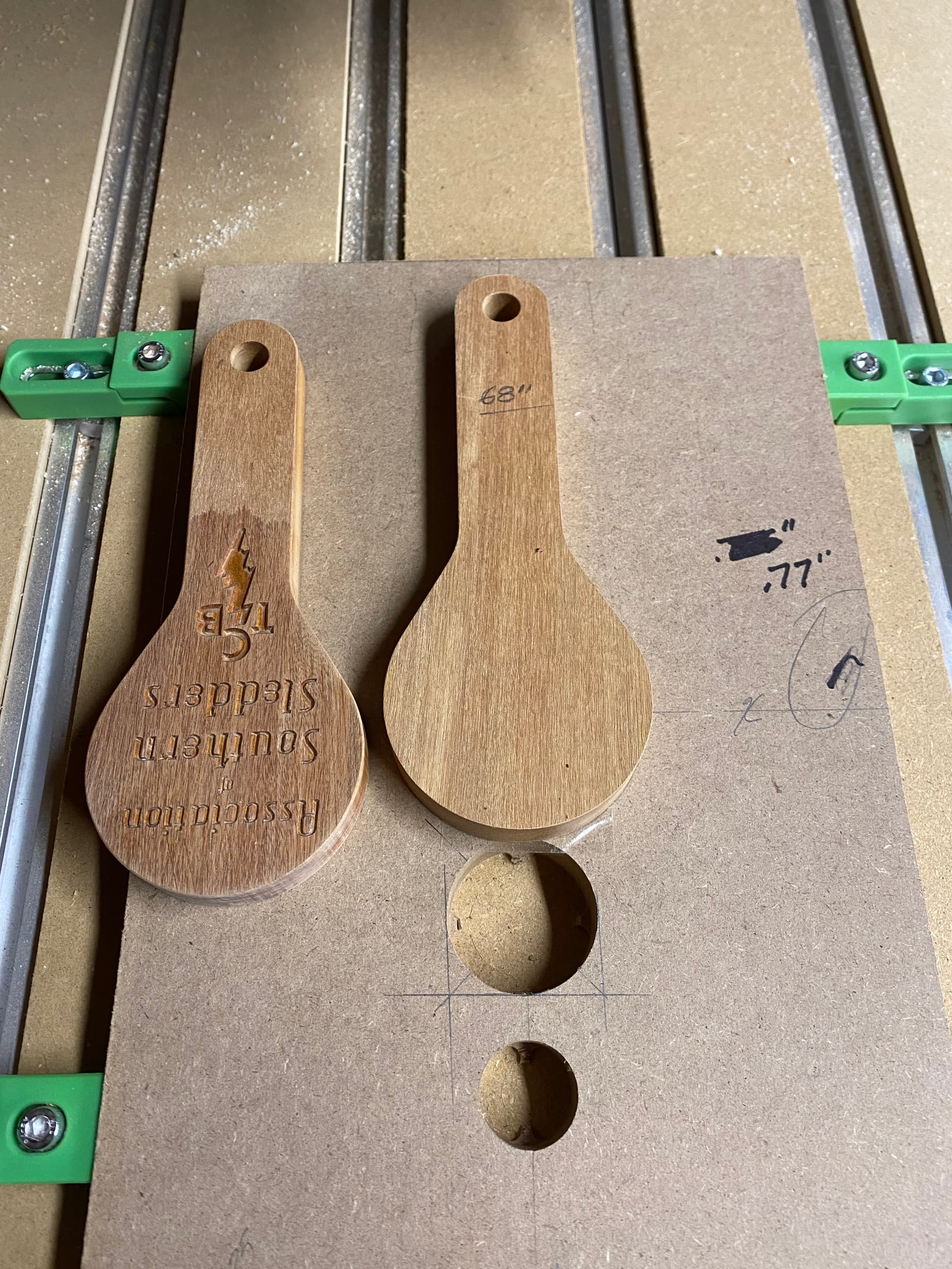

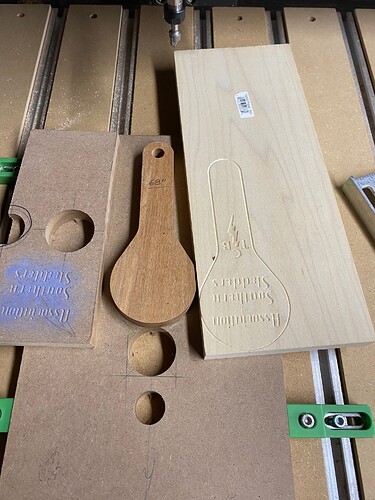

Thank you for your help. I am sorry for the long delay of my response. I am not sure what I was doing wrong but I went back to my Create files and changed the Z height to Bottom of stock and now when I run various thicknesses of stock, I just change it in the Create file and re-save it and re-load on to Motion and all is well. I just wanted to run the same text, symbols basically surface carvings on different thickness of stock without physically resetting the zero each time.
In the attached images I wanted to be able to crave this on different stock thicknesses with as little set up as possible due to the amount stock I have available I didn’t want to waste anything. It is faster for me to change in the file and resave each time. Yes it can be a risk if I forget to do this but I have a check list, that and I talk it out loud to myself as I go along! Many thanks again!!
