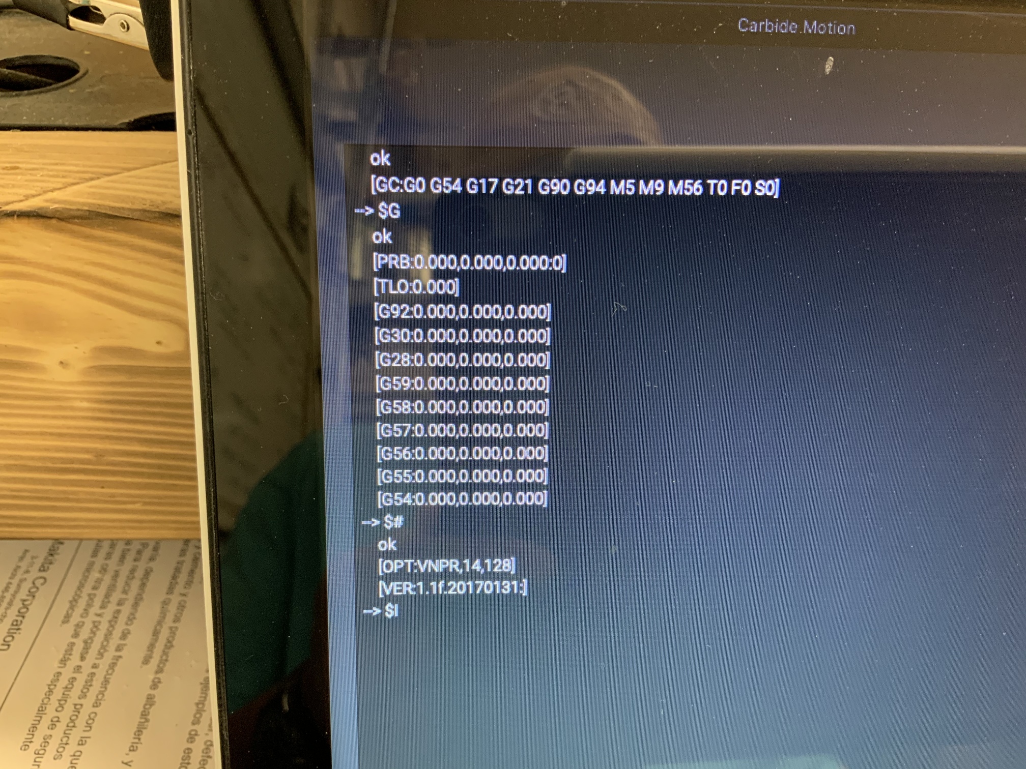

On mine it says this:
$I
[VER:1.1f.20170131:]
[OPT:VNPR,14,128]
ok
I just want to check if maybe the replacement board you have may have another GRBL version for some reason.
Going to try it right now!!
Thanks Julien.

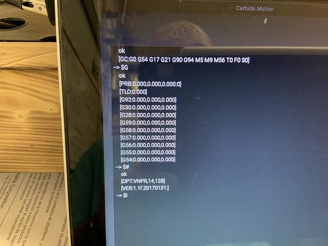

Looks like mine is the same. Including a pic so you can verify.
What version of CM are you using ?
It says version 513 ion the lower left side of the screen.
Mmh. So you are using the same version of CM I do, and supposedly have the same firmware, and yet it behaves differently. My bet is still that the firmware is not quite the “usual” one, but I may very well be wrong.
A final test in case it provides any clues: can you try and do a Pause during a cut (it can be an air cut) with the log window open, and capture the text ? (using the “copy all” button in the log window). There could be something interesting there.
I would have told you to try and reflash the GRBL firmware, but I would rather let support decide if this is the best course of action (and tell you how to do it).
Will do that next, I have to step of for lunch, so I will get that done when I get back.
I really appreciate the help and I love that I’m learning more about this machine.
