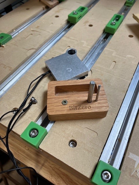

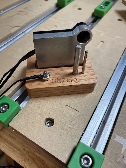

Do you have a bitzero also? If so make sure the bitzero is not touching ground as you have stored it (the wire or other source of ground). Apparently, it uses the same controller input as Bitsetter.
I made a storage block for the bitzero with a screw to keep the ground and bitzero apart.(There was a thread that I posted in that was a discussion of storage for the bitzero recently–just not sure how to search for it while drafting a reply)
John
Found it.
Here is the link to how I store the bitzero
The thread has other solutions to storage that keeps the parts separated.
