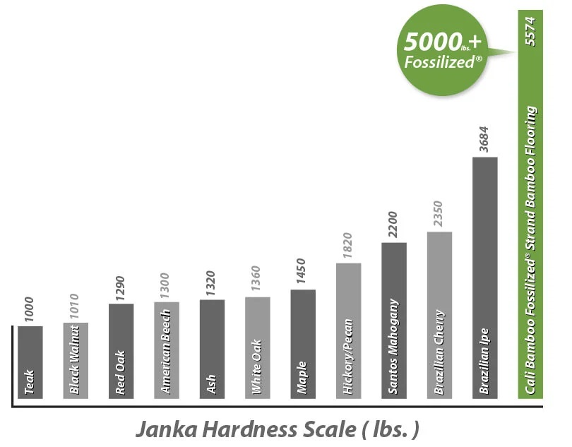

Here is a hardness scale of wood.
You can see that just plain maple is 1450 on the Janka Scale. That is pretty hard. Since you are doing roughing there is likely a lot of vibration. That vibration may be causing your collet nut to loosen letting the router bit loose.
You might try to lower your feed rate to help eliminate the vibration. If it is not vibration then you have a defective collet nut and/or collet. The elaircorp.com has collets at reasonable prices to replace your original one. Be sure you clean out your router shaft cavity and your collet and collet nut. Any lubricant even your skin oil can cause the collet to slip. I use brake cleaner. Just be sure if you do clean your collet it is clean and dry before reassembly.
