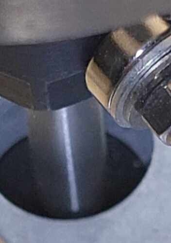

I recently set up my shapeoko 5 pro and am trying to get the bit zero v2 to work for it. The bit setter appears to work fine. But when I attempt to use bit zero I’m getting an error: “The probe did not contact the workpiece within the programmed travel.” The dowel hits all 4 sides within the bit zero’s whole, and then lifts up and moves north of the bit zero and lowers about a mm from the device.
The abnormal thing I had setting up the machine related to the bit zero is that it fits in the bitsetter spot and the bit setter only fits in the bit zero spot (as labeled in the instructions). Not sure if this was a recent change or not but the bit setter is working fine.
How deep into the BitSetter hole did you position the bit? It sounds like you didn’t go far enough.
I’ve tried Pretty close to the bottom of the hole. But also just below the hole’s surface
From looking at other videos it appears that the spindle is moving in the wrong direction after it touches all the sides of the hole. It’s going up on the y axis insted of down. (this is on the top left corner of the stock.)
Did you configure for the correct type of BitZero?
Could you send a video showing what it does to support@carbide3d.com
Yep for bit zero v2. I will go ahead and send a video to the email address. Thank you!
What happens when you do the Zero alone with the setter laid on top of the work? I don’t know what the instructions you are reading say, but I have always lowered the bit slightly below the opening as that is all that is necessary to make contact going through the routine.
Support solved this really quick for me. I thought I saw someone place the bit zero on the top left corner of the stock, and since the graphic in the probing screen shows the top left corner, assumed it must be that corner. I should have read the guide where it specifies the bottom left corner instead. Sorry for the trouble. It’s working fine now!
