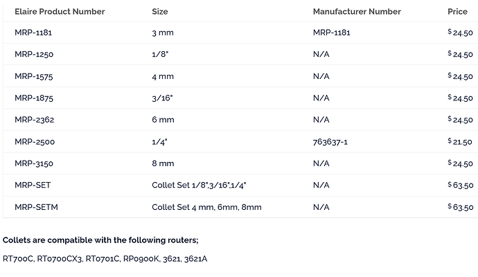

After cleaning those parts and you still have your bit and collet getting stuck then replace the collet. elairecorp.com sells individual collets or sets.
Just make sure you have picked the collets for the trim router RT0701C and not for the larger Makita routers.
