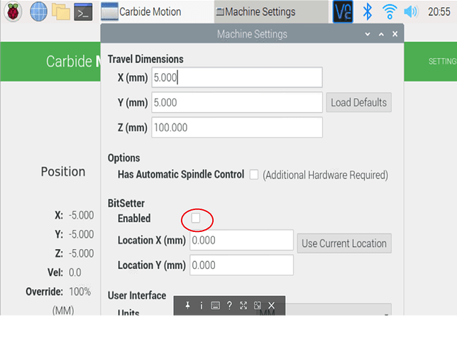

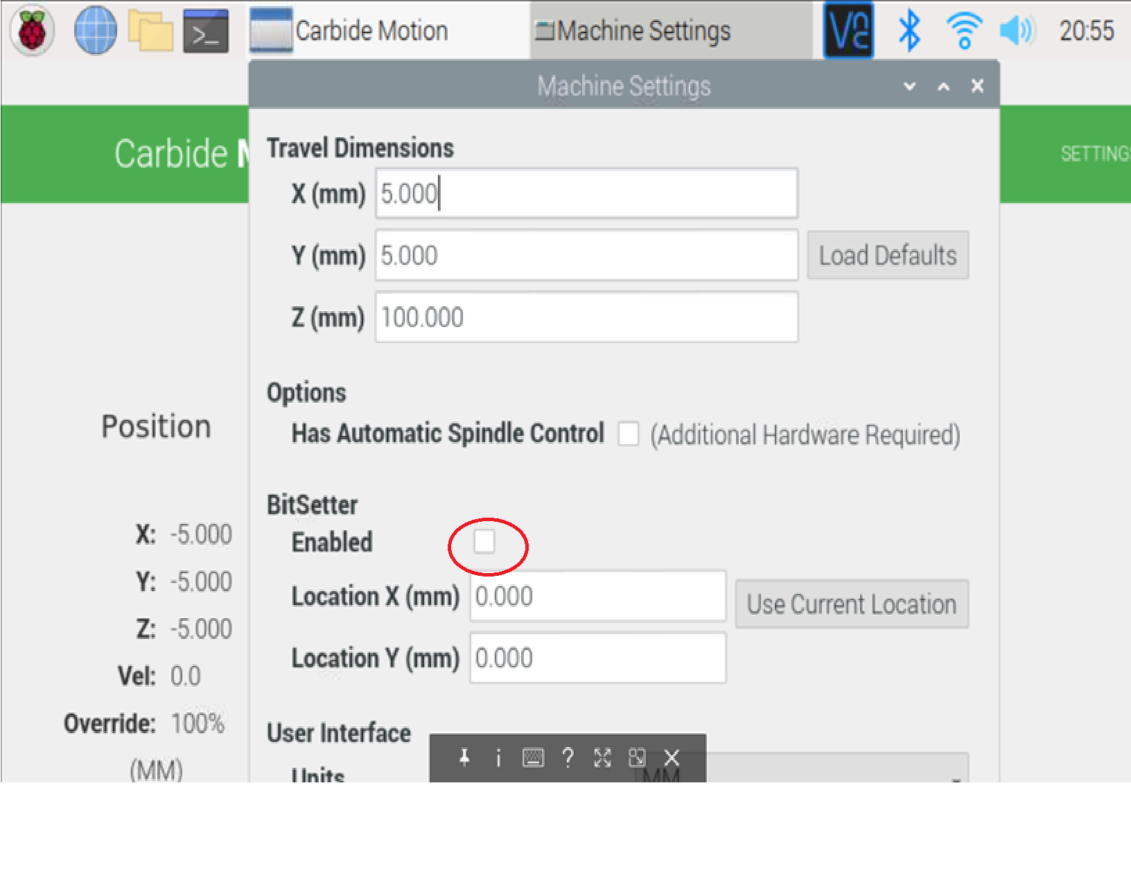

Tim: to set zero one may use the manual “paper” method, or the BitZero. Now you have the project zero. To avoid the machine going to the bit setter to find the working zero (as I call it) every time a project starts you must switch off the Bitsetter in the CM settings somewhere like this:
(don’t forget to switch it back afterwards. Don’t ask me where I know that from…)
