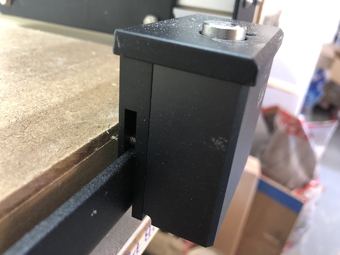

Even though I might be completely wrong after double checking a picture online, i’ll leave the response below. I’ll update once I get home and can look at mine in person.
“It looks like yours is resting on the set screws. If you back them out and push the bitsetter further down you should get a lot more usable length. It does make it tough to get to the screws, but you can make it work.”
Thanks @CatalystGilles I also checked online since it didn’t look right, but I saw in the product page that that’s how Carbide3D has it installed. I’m curious how yours (and anyone else’s) is installed on the frame.
I think the set screws are there, as the regular SO3 has shorter(height) frame rails than the XL/XXL frame rails.
On XL/XXL you land it all the way down, on regular size you put set screws in. Without them, it would bottom out and not rest on frame edge.
Clear as mud?
I have the SO3 (not with the stock Z axis though) and I definitely have it all the way down.
I’m very curious to see that C3D pic where you saw it installed like this?
Maybe to accomodate cases where people have clearance issues depending on their wasteboard size.
Anyway, pretty sure this is what is causing the issue for you, lower it and it should be fine
In the pictures on the store here,
It is shown “raised up”.
Looks like I’m not up to date on the docs!
The hardcoded 10mm Z move downwards just before starting the actual probing is causing the issue (since the probe is already triggered when the probe command is executed, and GRBL does not like that…you were right @neilferreri)
I am not sure why others would have a larger clearance, but unless that causes a problem I would still lower the Bitsetter and call it fixed. Or contact support to get a better official answer?
Both the store photos @CatalystGilles mentions and the pdf @David.Curtis linked reference the BitSetter raised on the grub screws as I have it. However, I’m going to do as you mention and lower it all the way in the spirit of Occam’s razor. That will buy me over 1/2" additional bit capacity. Thanks @Julien for your guidance! For my benefit, could you explain what you mean by the probe already being triggered? As in the BitSetter isn’t looking for a signal until 10mm of travel (hence my <10mm of clearance causing issues?)

By that video, looks like your Dewalt router is landed all the way down, and at max Z height the collet is still well below the Z carriage. Add on your 1.5” of bit length, and you probably don’t use much Z travel before hitting your wasteboard?
If you take a picture of machine front-on I think it will offer an answer as to why you’re having issues.

@David.Curtis It is indeed landed all the way down, per assembly pics I referenced. With the factory wasteboard and my additional 1/8" wastesheet, I have 3.325" of space beneath the collet. I could raise it a little. Is there any issue doing this, structurally or otherwise?
Structurally, I don’t see any reason not to raise it up.
Moving It really shouldn’t affect tram or anything, while the clamping bolts are threaded into aluminum and I wouldn’t make a habit of changing it daily, I feel pretty comfortable moving mine occasionally as needed.
If I were in your shoes…I would do this.
Loosen router clamp, Load up the shortest bit you use, and with Z all the way down, make sure that bit can reach like 1/8” past your wasteboard. Clamp router there. That should give you some extra clearance above workpiece and bitsetter when at max Z-height.
Thanks all, I’ve implemented the suggestions here and the issues have resolved. In summary, my BitSetter was set as high as it could be and my router was set as low as it could be, resulting in suboptimal clearances for the BitSetter cycle to perform as designed. Adjustments to both BitSetter height and router seated depth have alleviated these constraints.
