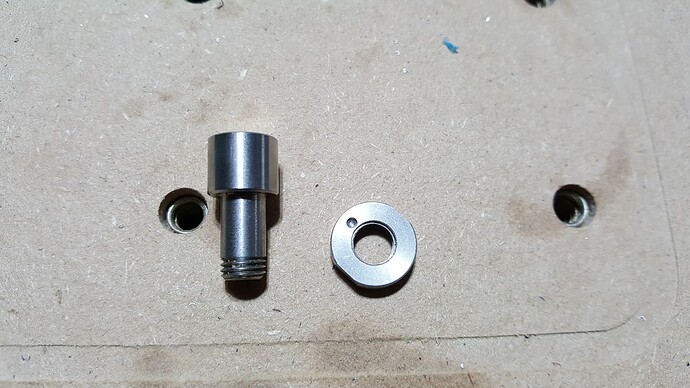

Not sure if your problem is the same, but i was getting the same probing error from my bit setter. In my case, the little nut that screws onto thr bottom of the touch probe was just hanging on by a thread. Removing the back plate and screwing the nut back on to the touch probe fixed my problem. Just watch those little screws, they are super easy to strip.
I thought I would wrap this up. I have been dealing with Fleming. He has been great! Turns out that the switch in the Bitsetter was bad. He sent out a new one and all is well. I appreciate all the suggestions.I everyone had, but it just seemed like a mechanical thing. It turned out that it was a bad switch. Thanks again. Phil
