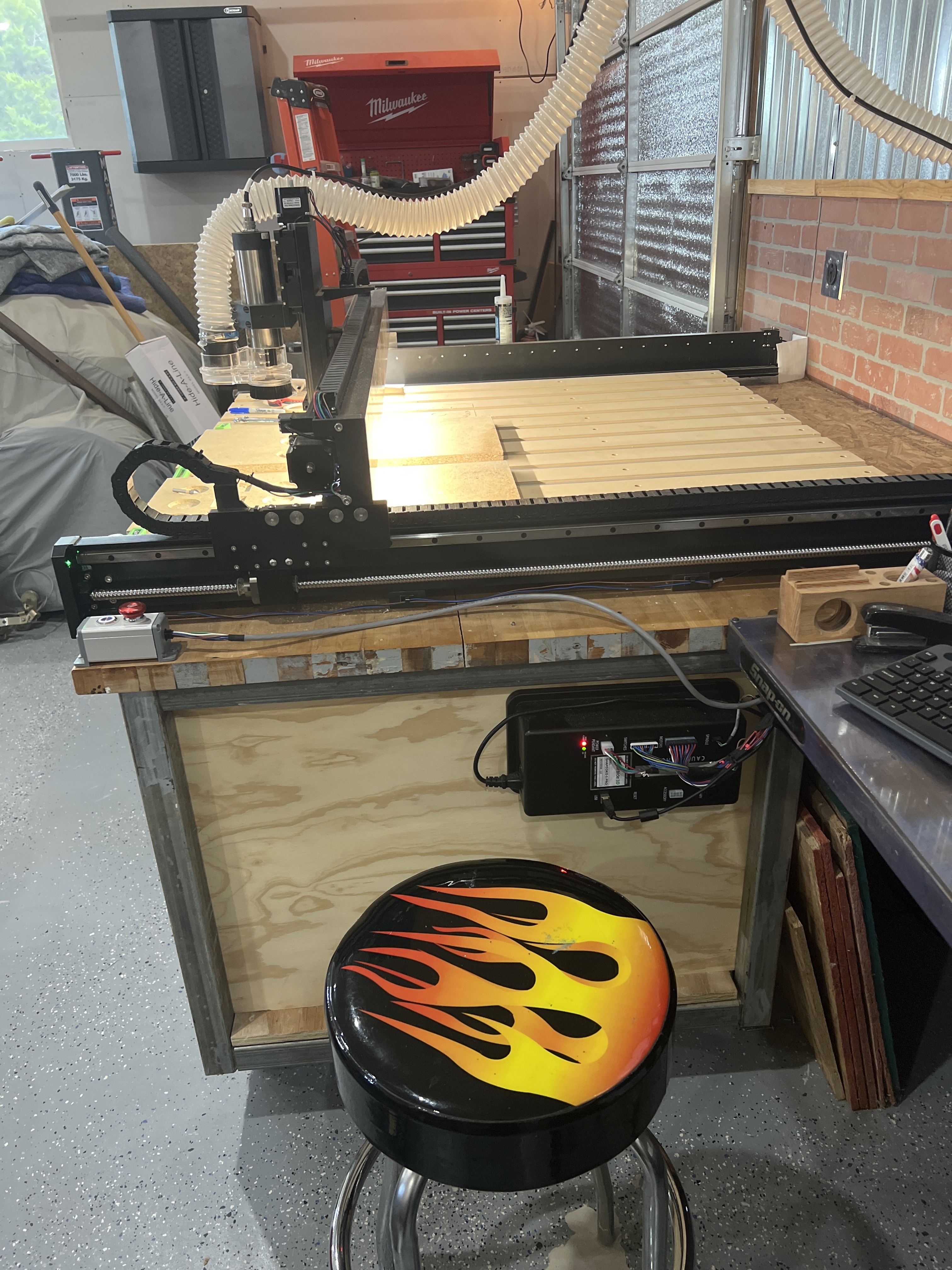

Everything has been working great, but today, when I went from one job to another, the bit started hammering down on the Bitsetter. I tried reloading the machine and that didn’t fix it. I deleted the whole carbide motion reinstalled it reset it all back up that didn’t fix it, so I just quit for now. Really really frustrated, but I love the machine (5pro 4x4 w/ VFD router). Somebody please help or give me a call and y’all can talk me through something. Thank you in advance.
The BitSetters have a red light that turns green when you push the plunger down manually. Check that the light changes states. If the light does not change the BitSetter is not sending the signal to the control board. If the control board does not get the signal it just keeps lowering.
I did, it turns green every time. I checked all the sensers and check good. After turning the machine off overnight it seems to be working again. I can’t just keep shutting it down for hours just to get it working again.

Where is your machine? Where is the control box? In what orientation? What is the ambient temperature?
The machine is in my workshop and it can get warm in there. I can understand if it was 90 in there but these machines should work under various conditions. The control box is on the side of my work bench so it is n the open

Sent it. Crazy thing is this morning it worked right off the bat, but after it sat for about an hour and I went to run a program and it started doing it again. I am learning inlays so I really need the Bitsetter. This really makes it frustrating for someone starting out with a new CNC.
The problem may be overheating — try putting a fan blowing on the control box and see if that then allows it to work — if that works, let us know.

There is a fan in the control box — we are looking into why it doesn’t activate on some of them — that’s why we need for you to contact support.

I had the same problem. As @WillAdams William suggested having a fan blowing on the heat sink bar on the control box solved the issue.
Please note this isn’t an actual solution, but a temporary work-around — anyone who has this problem needs to let us know at support@carbide3d.com and we’ll work out how to handle it.
