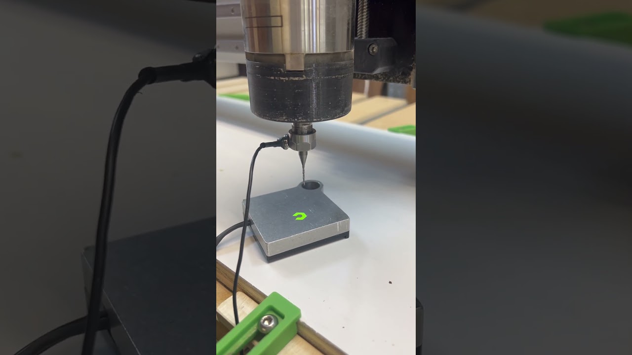

I just upgraded to CM 618 (from 5xx) and am running into a problem with setting Z using BitSetter.
Please see this video:
After probing, the command I select is to move to Z + 6mm yet the bit almost touches the surface of the stock. Any idea what could be causing this?
Shapeoko Pro XL
Did you configure for a V1 Bit Setter rather than the V2 you are using?
No — you can see in the video that the v2 bitsetter is displayed in the probing screen, ie. it is selected.
I figured it out. With the upgrade I had to re-setup my machine and I mistakenly selected “Shapeoko Pro with HDZ”. After reinitializing with Z-Plus, things work now.
As you found out the Z-Plus and HDZ have different steps. The HDZ has more steps per inch than the Z-Plus. Plus they run in opposite directions. So if your Z goes down at initialization that is a clue that the configuration was set up wrong.
