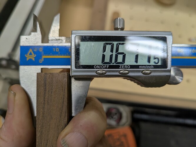

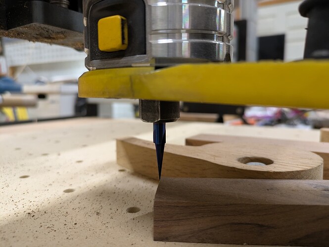

I updated to CM 651. Same problem. I set zero on spoilboard. The Z went to the BitSetter and that worked as normal. I then moved to the center position with rapid positions. I did the Z+6mm and here is the result. I had a piece of stock on the table that measured .672" and it was very close to the top of the vee bit I used to set Z zero. The piece of random wood was not used in the zeroing process.

I edited the shapeoko.json and change bitzero to 1. Saved file and restarted CM 651. I set zero on spoilboard with BitZero and after trip to BitSetter I went to center rapid position and the bit is still way above. I then jogged down to the spoilboard and here is the result.
You can see that the Z is .0.414" above the spoilboard with Z+6MM and should be .236" (6MM).

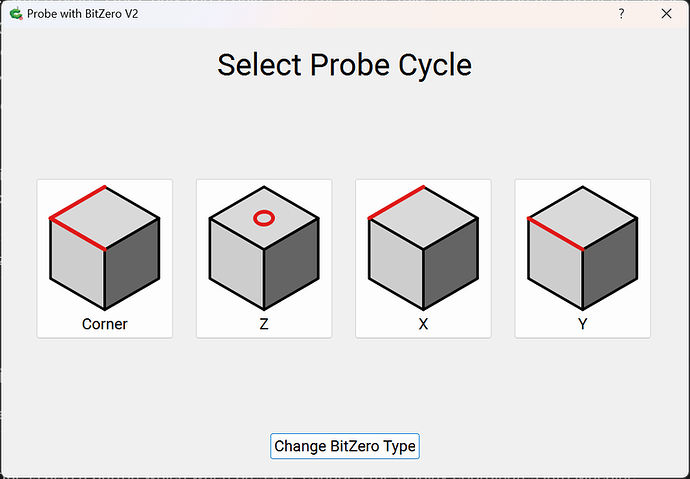

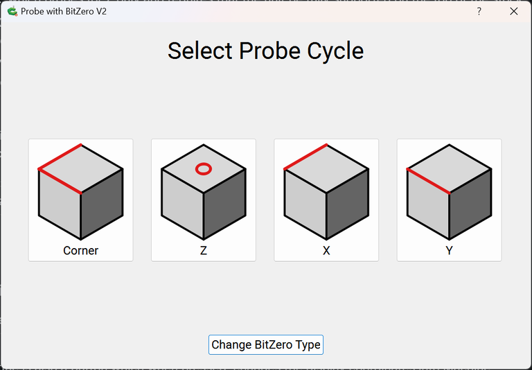

It’s configured in the Probe window (button at bottom) and confirmed at the title of the window (top):

I was kinda curious about this.
I use a v1 BitZero, my shapeoko.json notes “bitZeroType”: 1,.
Just for the heck of it I ran the Probing cycle and selected v2 and ran a Z only probe. After closing CM 651 I looked at the shapeoko.json, it noted “bitZeroType”: 2,.
I ran another probing cycle and selected my v1 BitZero, Z zero probe only. Closed CM again and the .json was updated back to “bitZeroType”: 1,.
I don’t believe the BitZero is configured when you setup CM to your machine like all the other settings. It’s not until you select your BitZero version during a probing cycle when the shapeoko.json gets that info.
If the .json has the wrong BitZero type stored and you Z zero off the deck with the paper method the .json won’t get updated.
