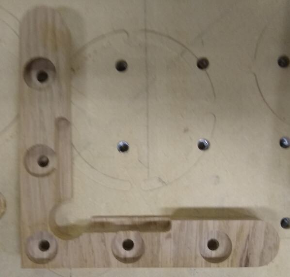

If you decide to build an L shaped fence be sure that in the corner there is relief. If you just butt two pieces of mdf, wood, or whatever together at the corner it is a place that will collect dust and can potentially hold your material off from the corner. Plus if you want you can put some relief on the top of the fence so you can still put the BitZero on if you want.
This was an earlier version of an L bracket (fence) and I relieved the corner and put a recess in to put my BitZero inside. With this setup there is a minimum thicknes of material that can be measured. That minimum thickness would depend on how deep you made the recesses for the BitZero.
