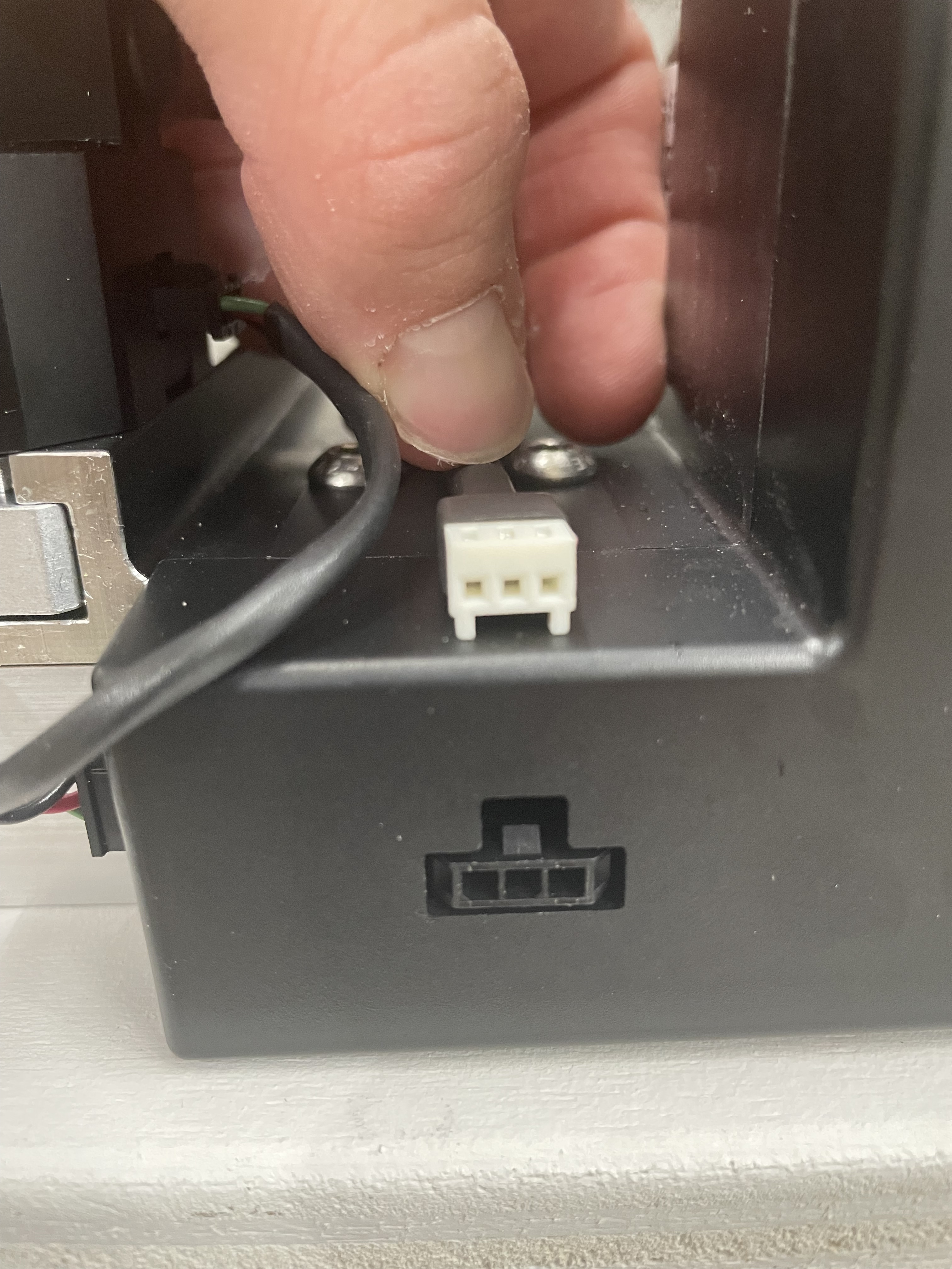

I am setting up my shapeoko 5 and I can see in the instructions where to connect the bitzero (on the front right of the machine) however the connector I have on the bitzero is not compatible, and from other images I’ve seen, it looks different.
Am I missing something?
You need to order a BitZero v2 which has the connector for the Shapeoko 5 Pro — if you did this and got one with the wrong connector, let us know at support@carbide3d.com
If you are trying to use a BitZero v2 from an older machine w/ an SO5 Pro you’ll need to order a new one — make sure to select Shapeoko 5 Pro in the drop-down menu.
