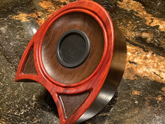

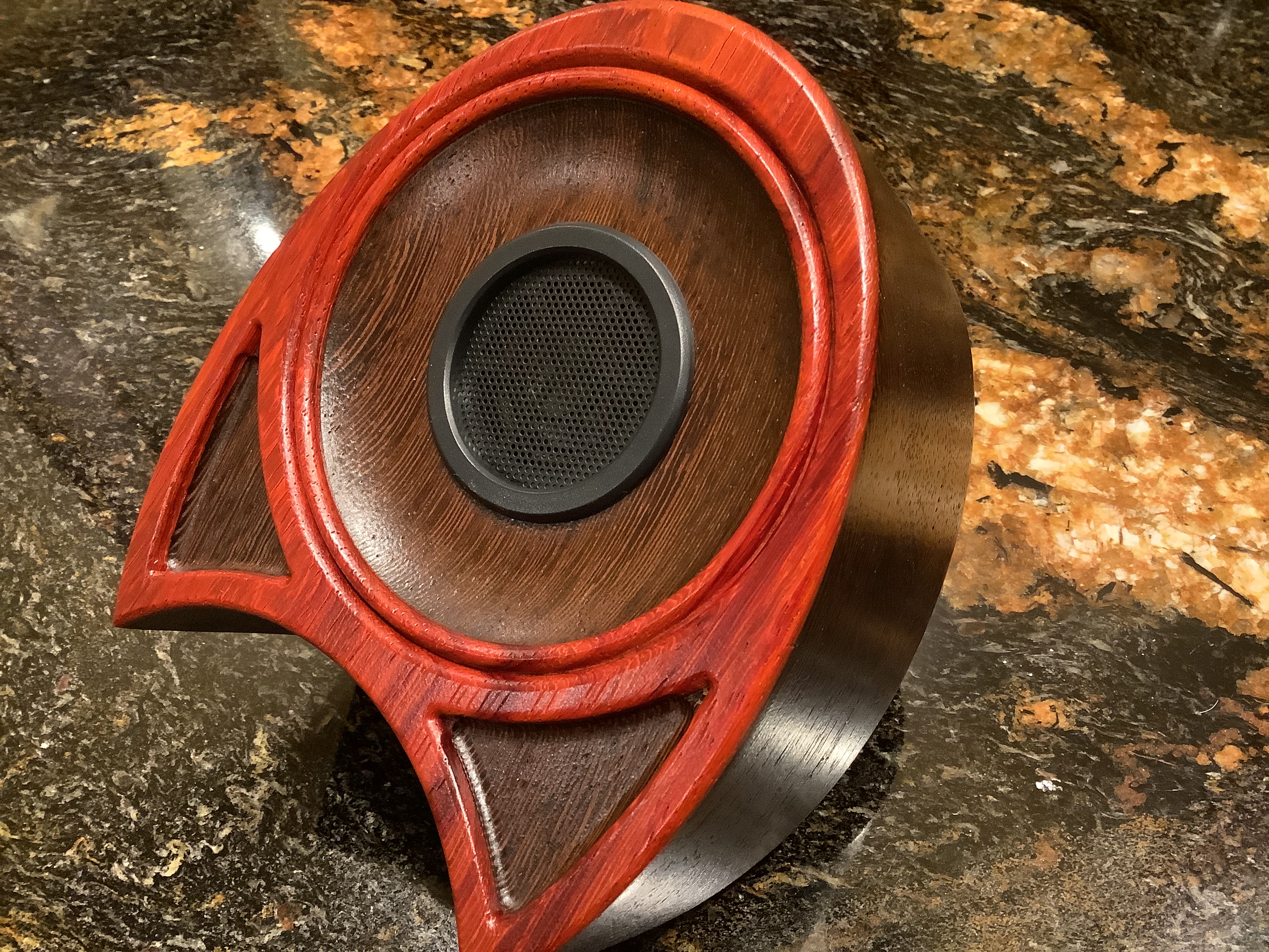

I built a blu-tooth speaker as a gift to a friend. It proved to be popular and I have made several more. I prefer the aesthetics of round over and crown router bits. The round over is applied as a v-groove endmill. The crown bits are applied as ball nosed endmills. The simulator will show v-grooves instead of round overs, so keen visualization is a must. I remain very attentive when running the wide crown bits, babysitting the speed and feed the entire time. This particular speaker is made from Padauk and Wenge, two of my favorites.strong text
Dims: 6”H x 5”W x 4.5”D

Nice contrast on the wood species. Finish looks clean. Good job!
Looks real nice.
What did you use for the Bluetooth® technology part of it?
