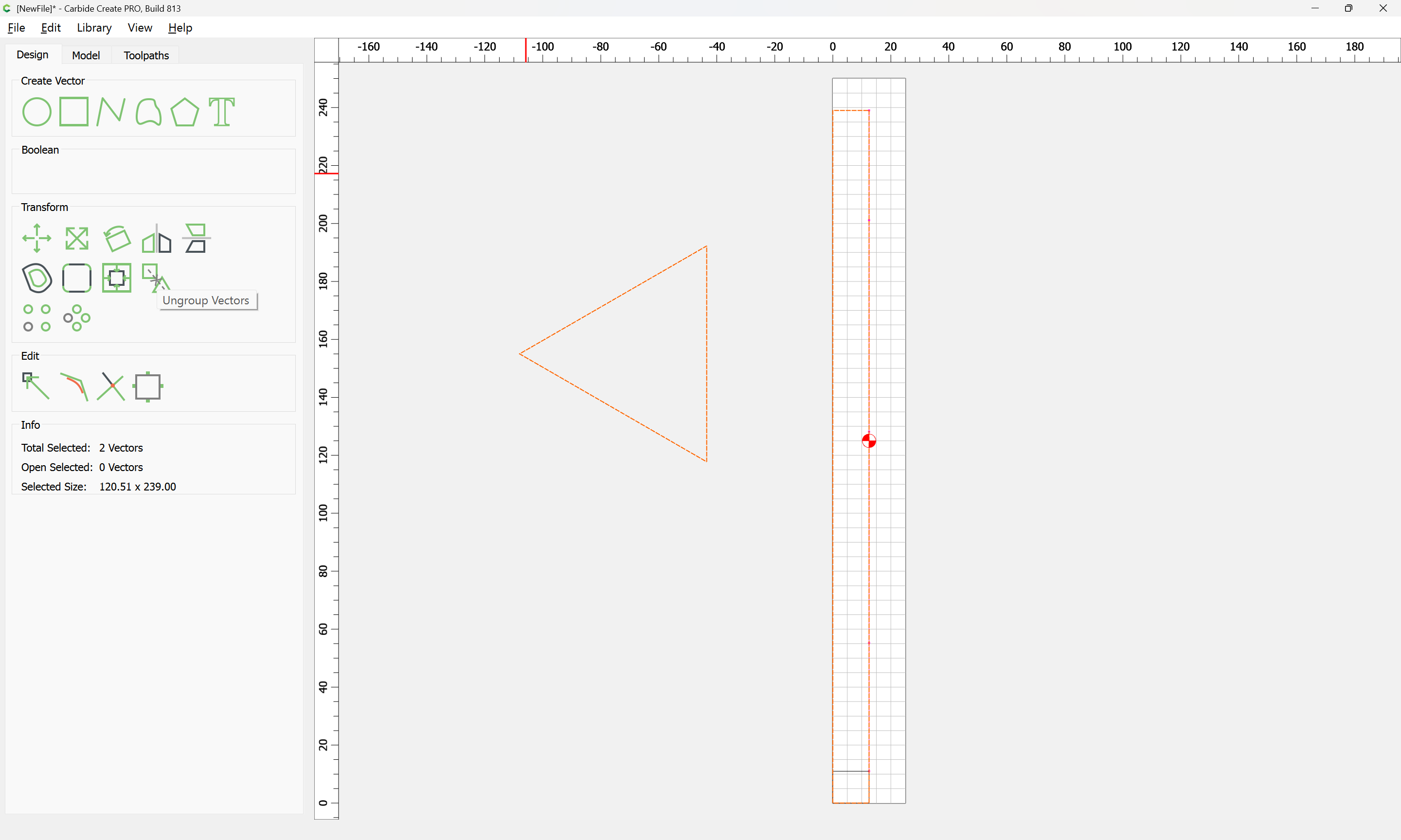

Select the group which you wish to ungroup:
and use “Ungroup Vectors”.

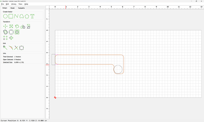

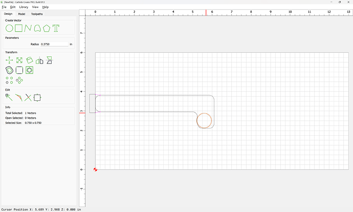

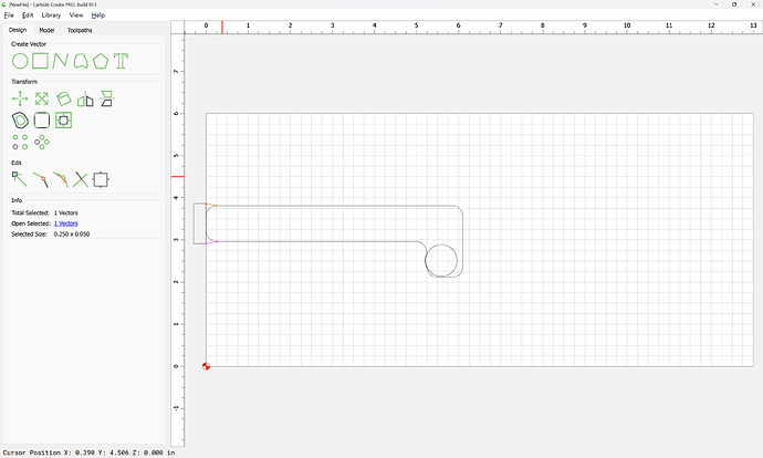

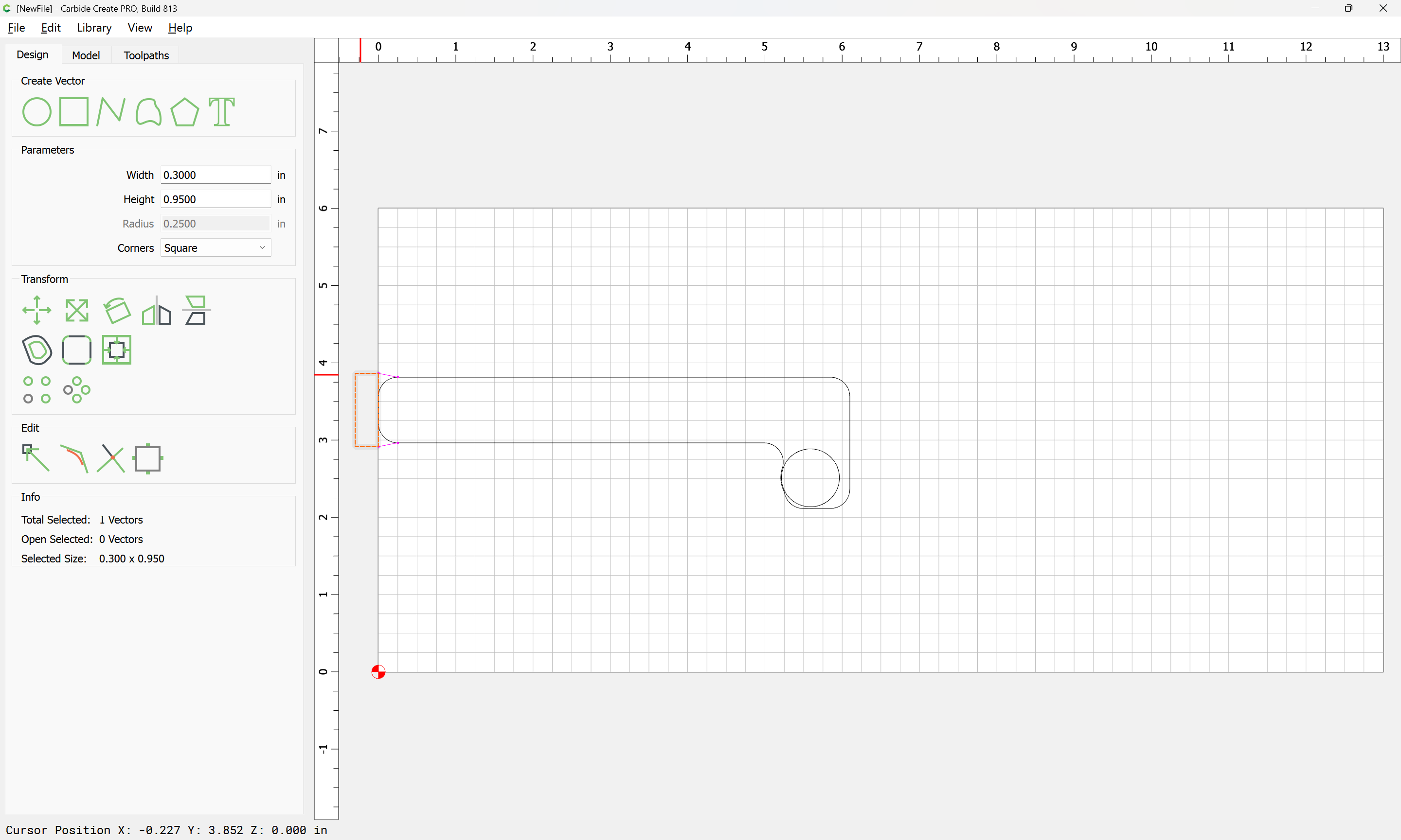

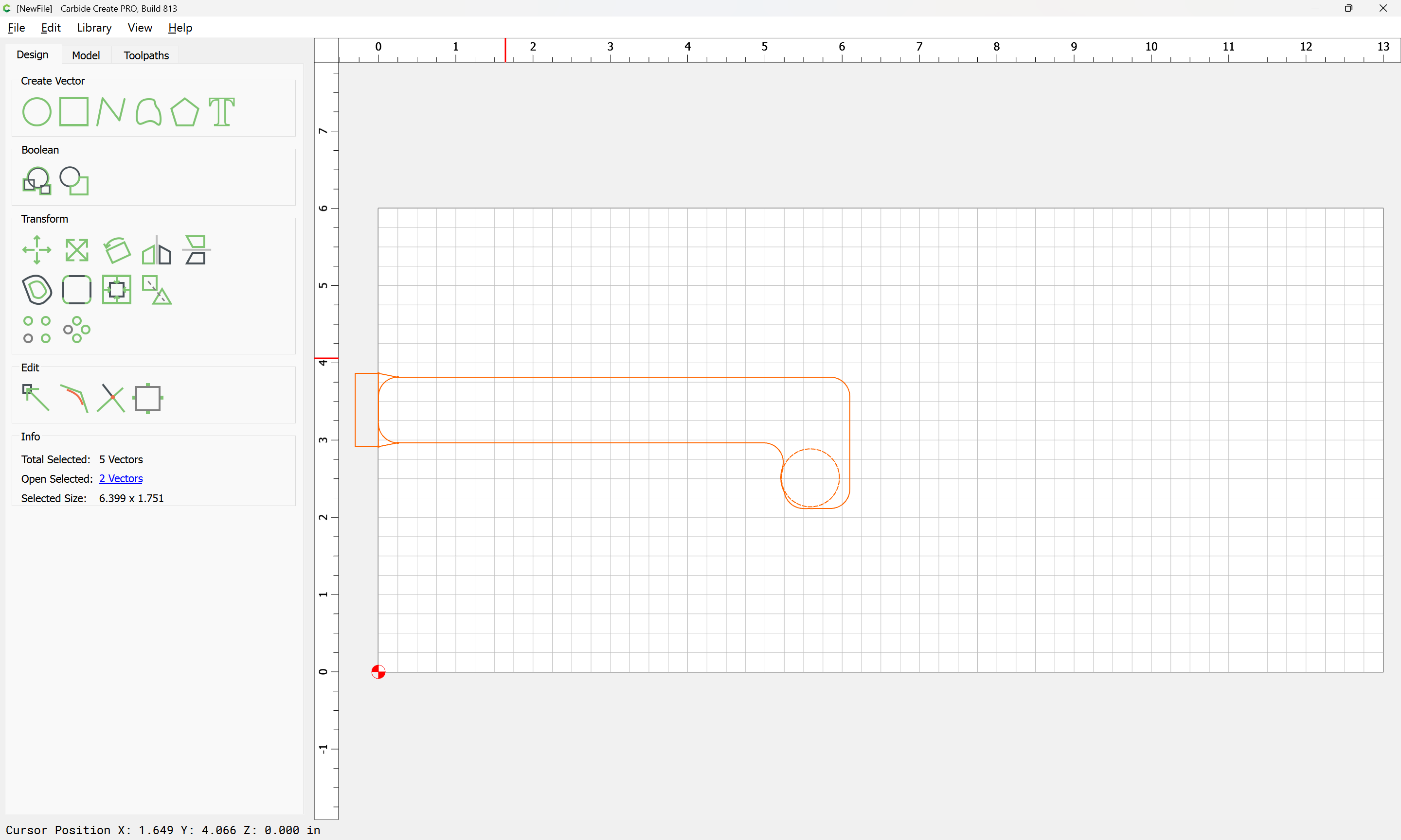

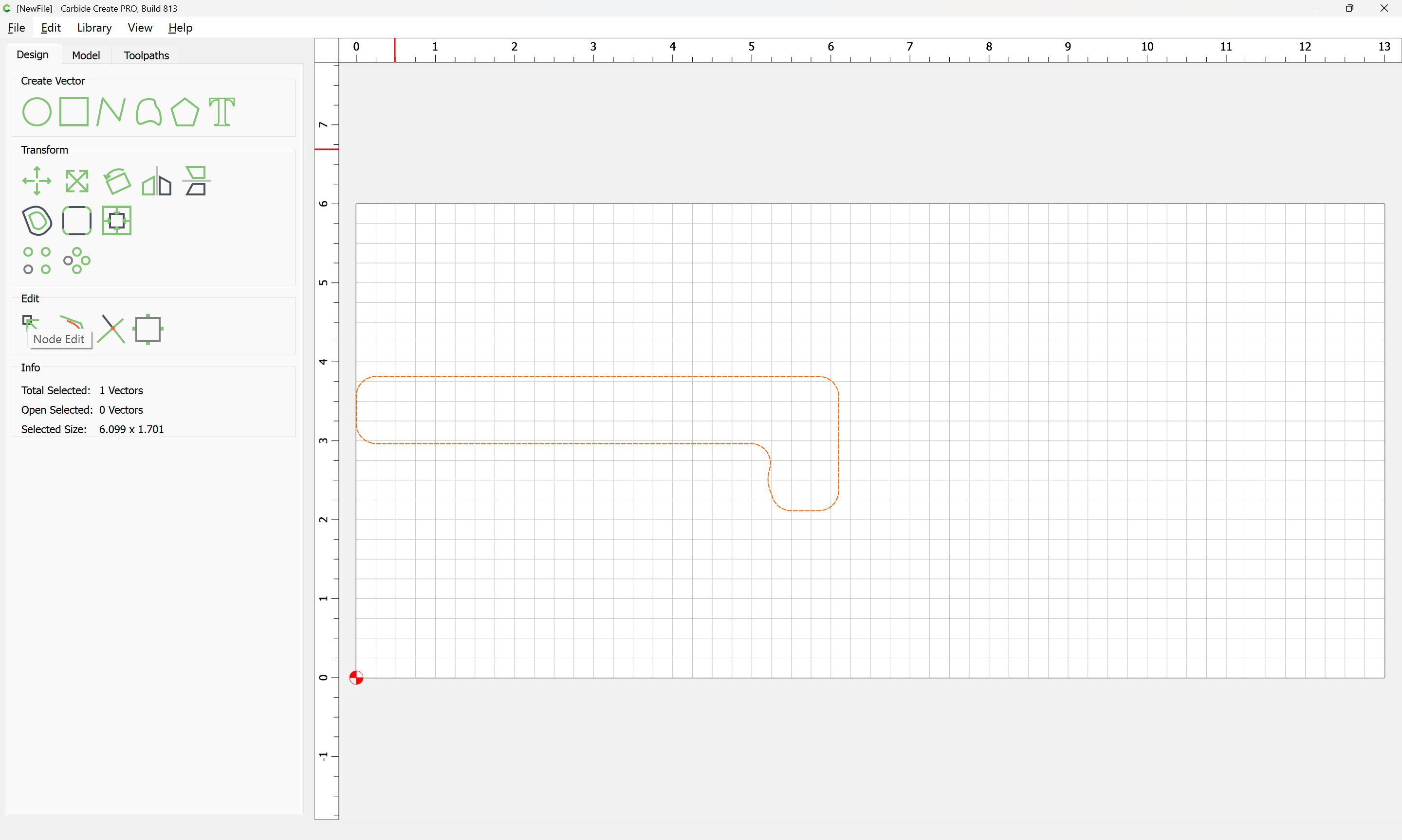

There are 5 objects:
None of which are grouped, each of which is individually selectable:
hence, no facility (or need) for ungrouping.

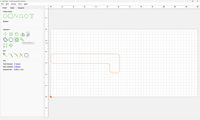

What do you wish to do that you are having difficulty with? Post a screen grab?
hanger test 2.c2d (44 KB)

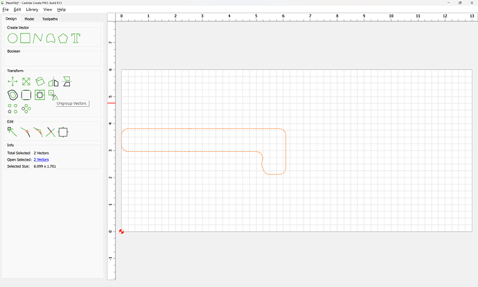

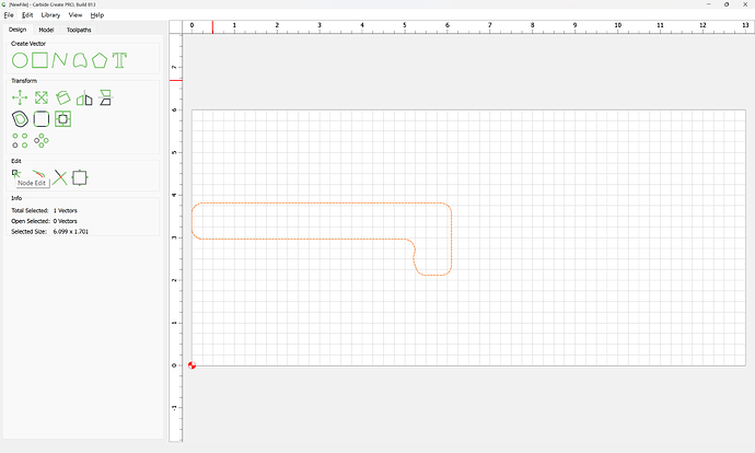

The modified file has one object in it:
A single object/selection cannot be ungrouped.

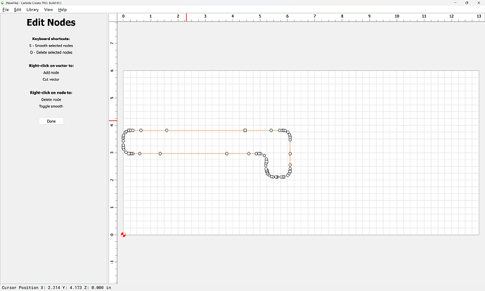

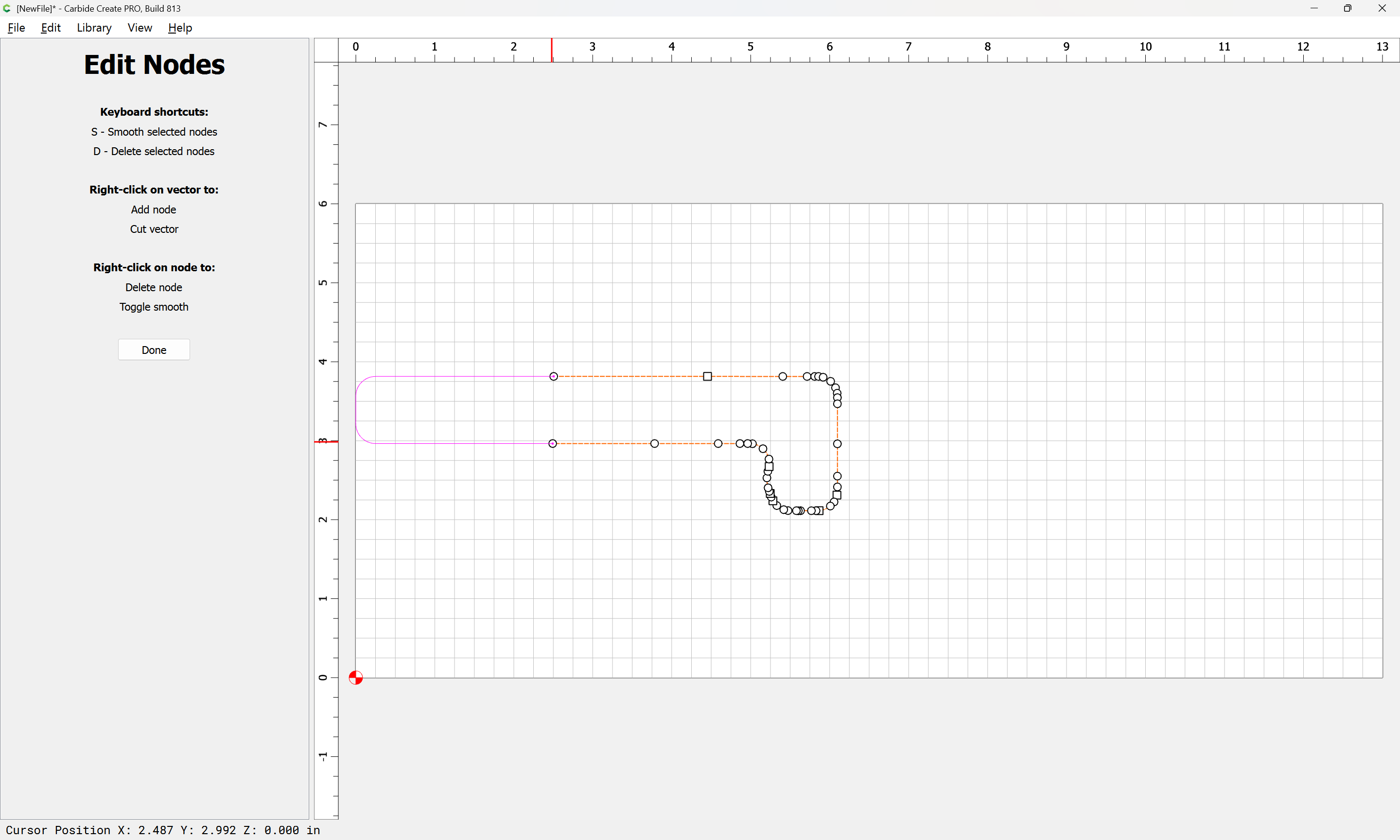

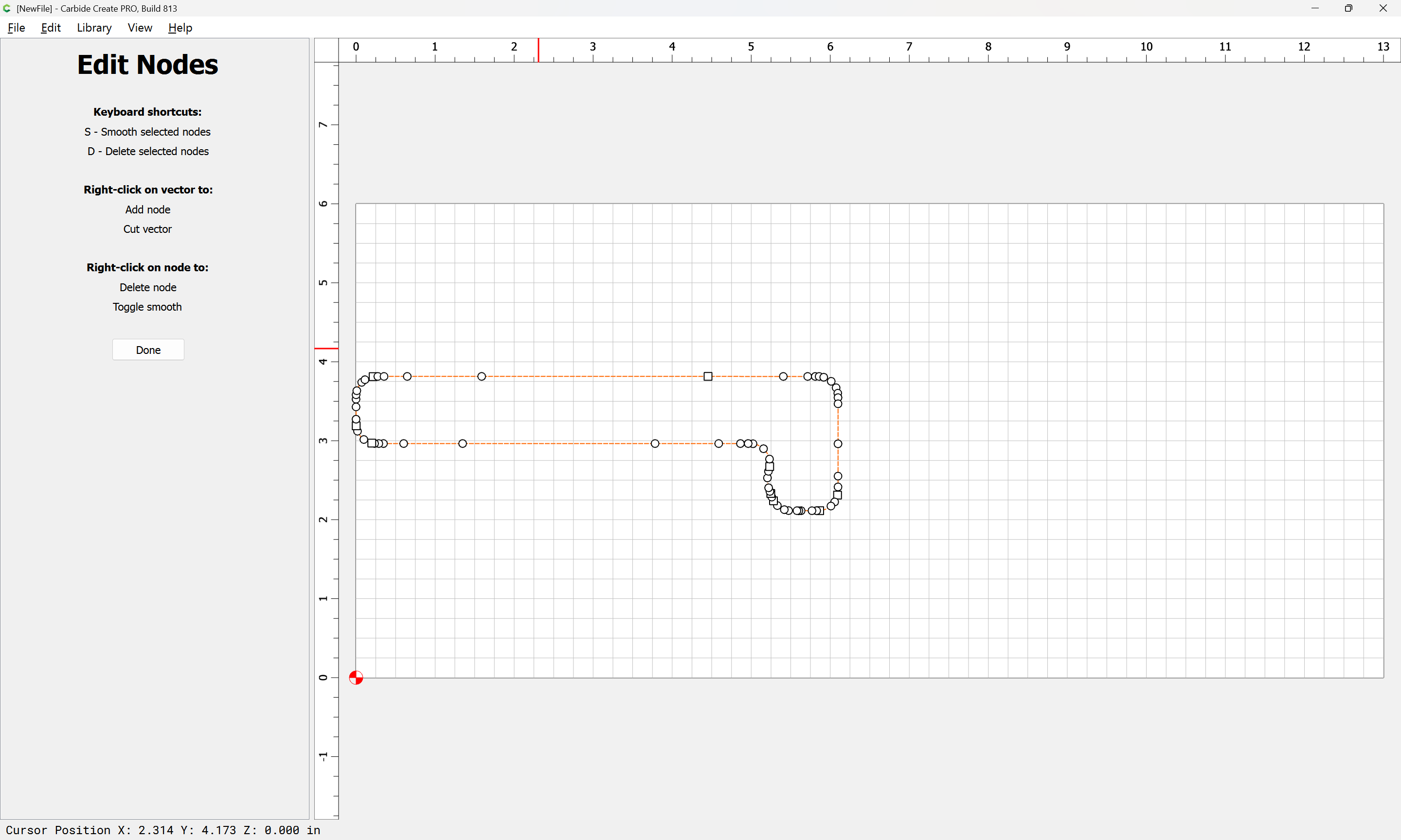

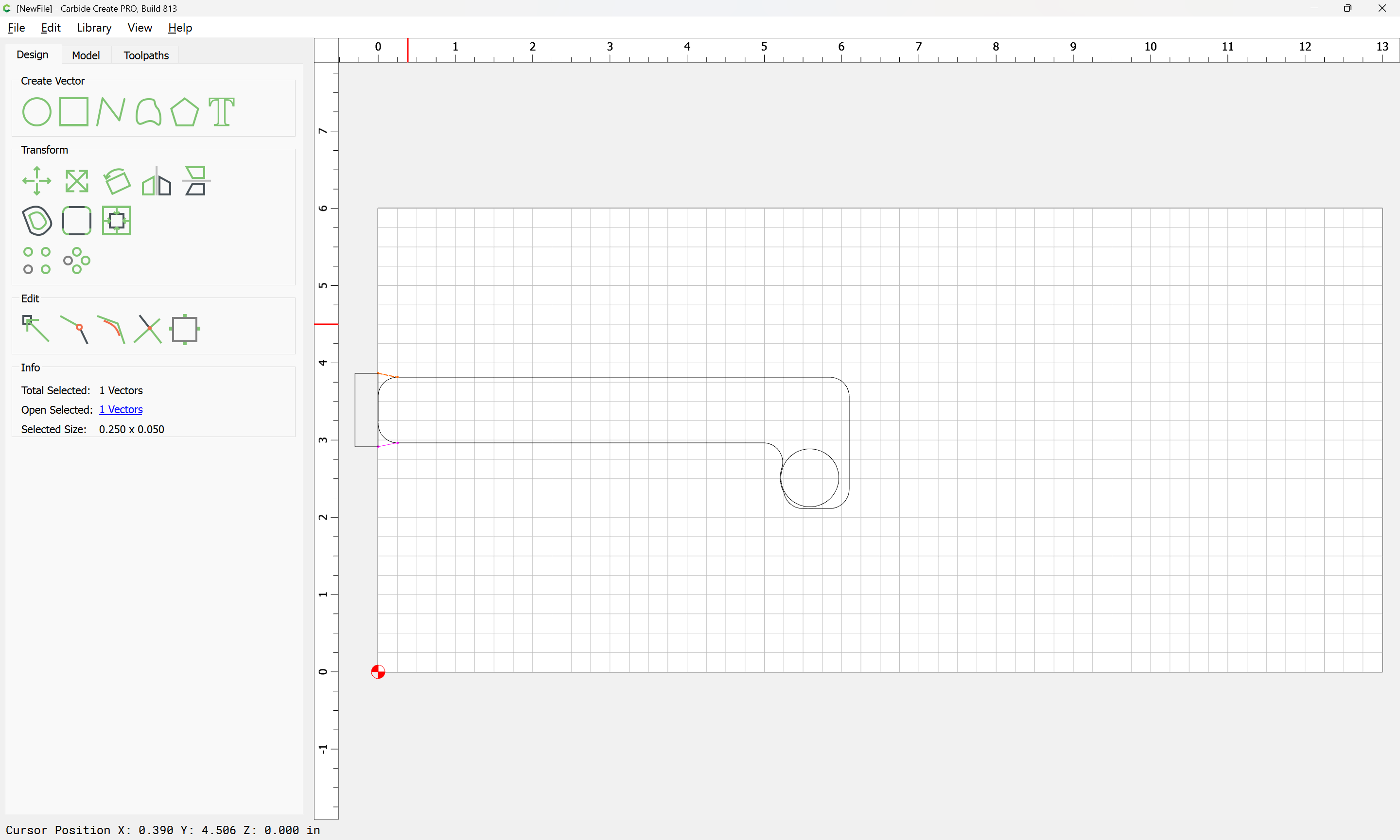

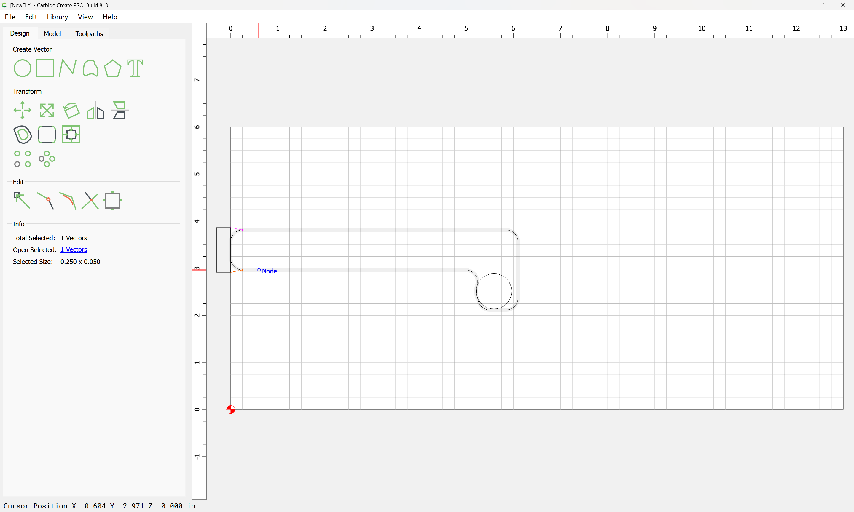

If you wish to have two objects where there is a single object, go into Node Editing:

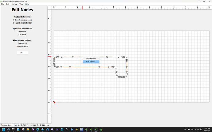

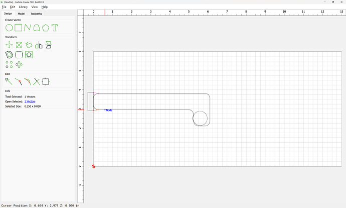

right-click where you want the first separation to be:
and choose Cut Vector, then repeat where you want the second separation:

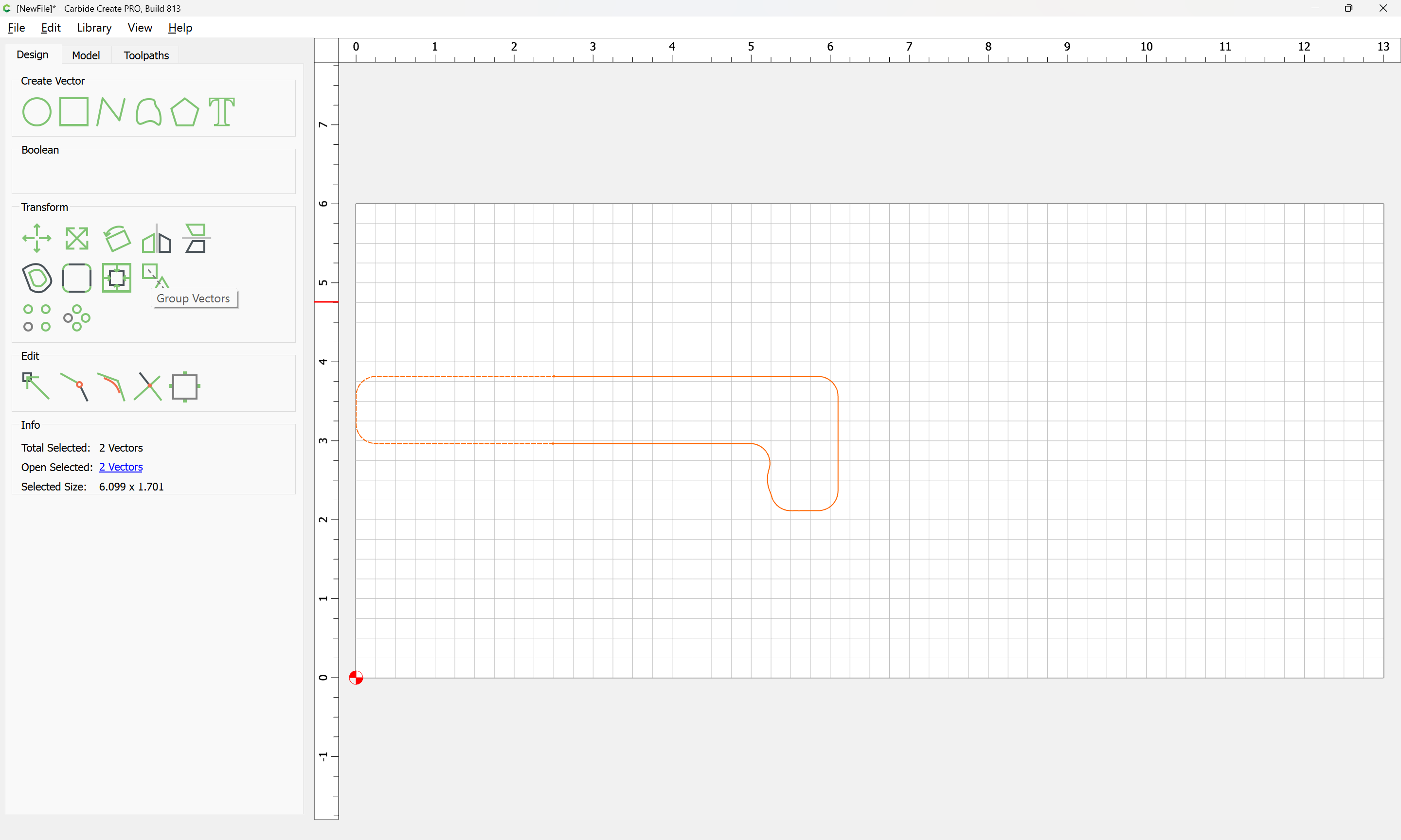

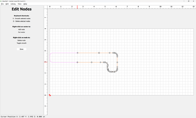

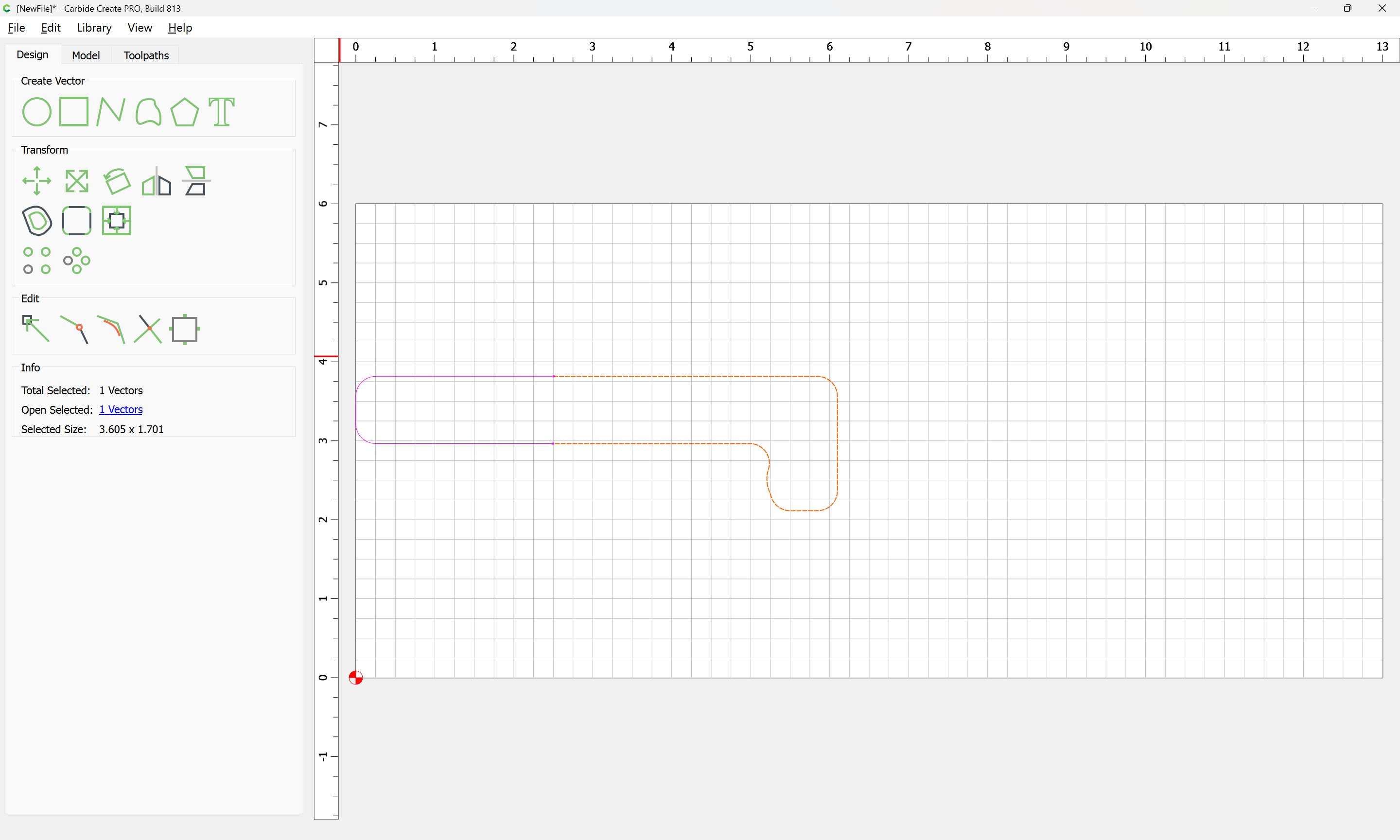

Done
which will result in two separate objects which may be grouped/ungrouped:
