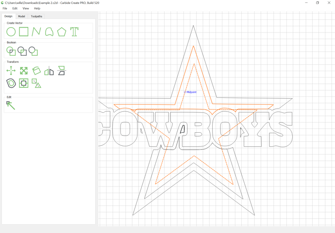

Can anyone tell me why my boolean subtraction is coming out like this? I don’t want all the lines touching inside the star because I am unable to do the pocket cut out correctly. I am applying the offset vector around the “Cowboys”, clicking the star first then shift and clicking on the offset vector of the cowboys. Once I delete the offset lines they do not delete inside the star.

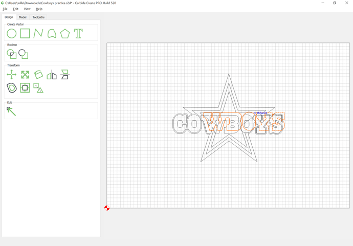

This is the original set up before I put the offset aroud the cowboys

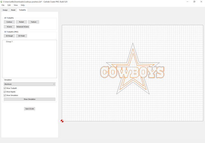

Close, I need the inner star pocketed still and the Cowboys needs a border around the entire wording. Then the middle portion of the stars does not get cut, lastly the outer star is pocketed. My main issue is I cant get the border around the Cowboys

See how the smallest star in the middle is pocketed? Then the thinner star which borders the middle star, then the most outer portion is pocketed also, along with the cowboys.

Yes thats it, so why does it not work on my end? This is how it looks after I do the boolean subtraction on the outer most two stars and you instructed

Select the innter star as the key object and remove it from the geometry you made:
and you would have needed to do the same to the others.

My offset is unioning the offset lines of the Cowboys, when I am clicking boolean subtraction
