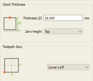

You need to set Zeros to match the workpiece you are trying to create. Are you using Carbide Create? If so, the ā€˜Job Setupā€™ tab will tell you where your Zeros have to be in relation to your workpiece.
Left Icon:
Then this determines where you should set the zeros on the machine to match the zeros in the design:
So in this particular case, you would move your spindle until it was over the lower left corner of the workpiece, and zero out X and Y, then jog your bit down to just touching the top of the workpiece, and zero out Z. You can also use the BitZero (if you have one) to help set these values.
Now your machine and the design program agree about where the Zero point of the program should be, in relation to the workpiece.
