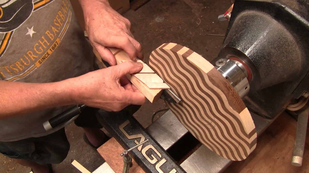

I have an SO3 XXL with HDZ. I am also a wood turner. There is a youtube channel called Papa1947. He turns a lot of interesting things. One thing he makes is a wavy bowl from a board. You create a board about the size of the bowl you want and then cut rings out at a 45 degree angle. Then you glue the boards together and form a bowl. You then turn the bowl in the lathe to get it smooth inside and out. I have wanted to make a bowl from a board for a long time. I am an experienced turner and did not want to make a boring bowl from a single board. So after seeing Papa1947 using a cnc mill to cut his waves out and then gluing them together into a board I went straight for the hard stuff. Hopefully it will come out ok. I got the image from Google and in Inkscape converted a jpg to an SVG. Then in CC I made an array on my work piece that is 6" X 18". I have two 6X18" maple boards and two purpleheart boards to make the board from. I will be cutting it out this afternoon and gluing. Hopefully if that is successful I will be making the bowl from a board this week. I love my Shapeoko and hope all this effort works out.
Here is the video from Papa1947 about making a bowl from a board. If you have a CNC and turn he has some very interesting videos.
What I like about his videos is he tells you how and does one and skips all the repetitive steps many youtube videos go on and on about. He does straight turning but also integrates his CNC machines into his turning. Very interesting.
Here is the simulation of the patterns I am going to cut out. I get 4 waves per board for a total of 16. I will be using super glue and painters tape to hold the material down. Cutting with a 3/16" down cut bit.
I will cut out the patterns and then glue them alternating maple and purpleheart. Then I will cut a rough circle out and put it on the lathe and cut the rings. I love combining my traditional woodworking and the Shapeoko.

The goal is to alternate the two species to make a board and then make the bowl from a board.
If the ends are a little ragged it wont matter. Each wave is 18" long. The maximum size bowl I can make is 16". So after glue up I will rough cut a circle and the ragged ends will disappear.

Ron Browns Best is a turning fixture maker. He sent me an advertisement this week with buy one and get 40% off a second one. I had wanted a hollowing stabalizer but just could not justify it. I wanted his new Bowl from a Board jig. So I ordered them both and got them. So I will be cutting the Bowl from a Board from the above stock later this week.
Hollowing Stabalizer:
DSCN00022000000564654654-500x500
Bowl from a Board jig:
12222-500x500
I also got his thin parting tool:
jioioviovggiohgiohjgohig-(1)-500x500
To cut the Bowl from a board you need a thin and short parting tool. I will have to set up my slow speed grinder to sharpen the parting tool. Since the wheels are round I will get a hollow grind.
The parting tool is just a piece of steel tubing. I will make a handle on the lathe and carve my name in it with the Shapeoko. I put my name on all my tools and the date I got them.
