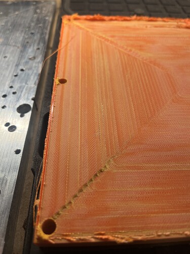

Tried surfacing some g10, pretty disappointed.
