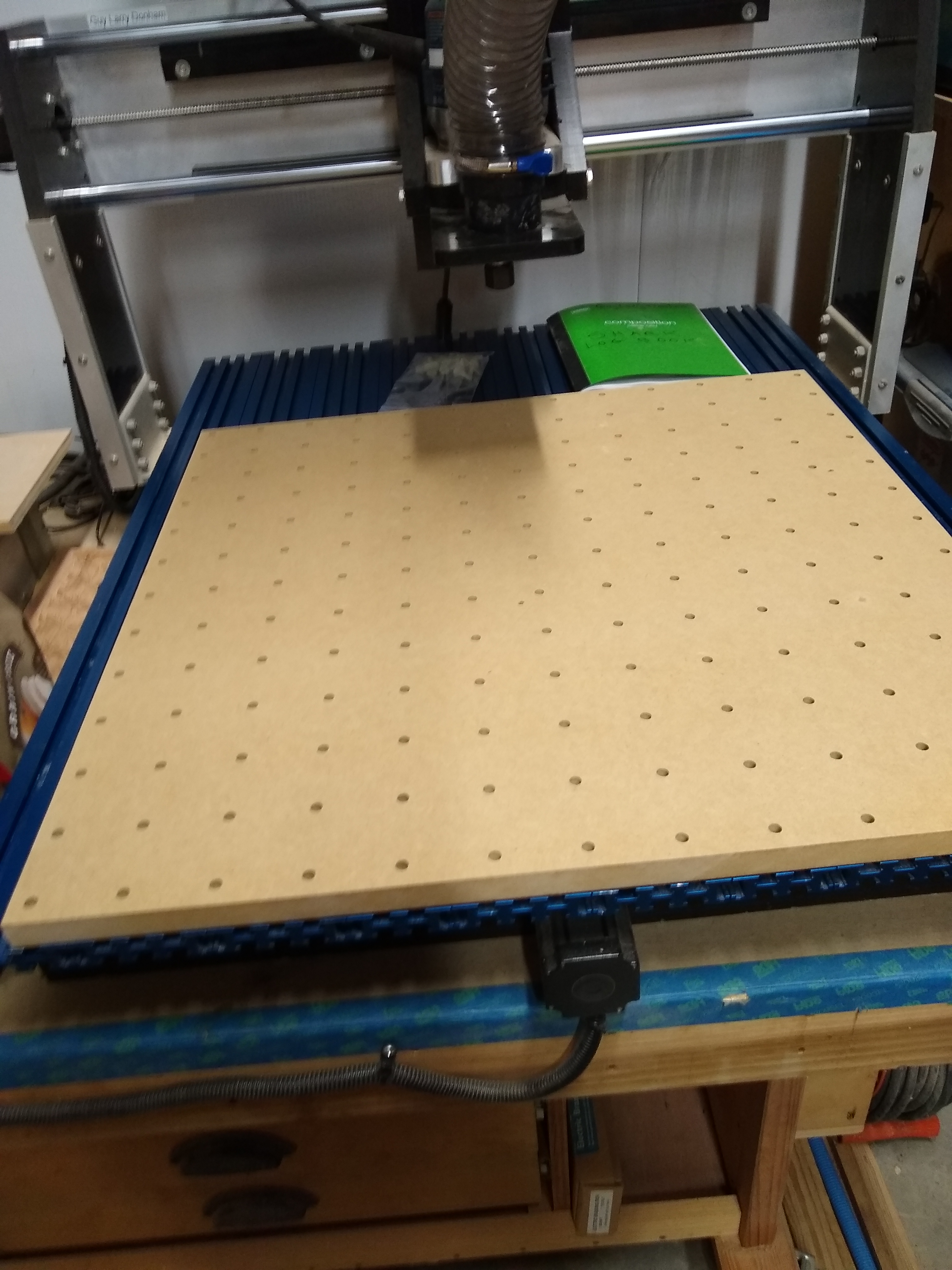

I use a spoilboard with 2 inch spacing with 1/4-20 5/16 inch tee nuts.
