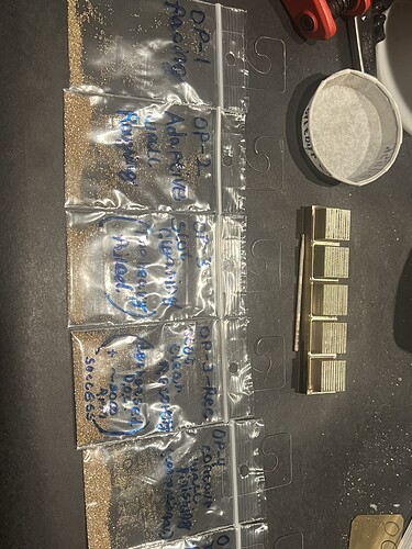

Super quick update, I focused a lot on dimensional accuracy and surface finish. Not because it’s terribly important but because I wanted to actually tackle intentional tool strategies…instead of my usual approach of dropping an adaptive clear on it and hoping for the best :sweat_smile:
There were some interesting and unexpected results from some of the strategies employed. In hindsight the issues are obvious but they deserve a proper explanation I think :slightly_smiling_face:
I’ve also been convinced to be a bit more methodical in my approach. This time around I cleared chips after every op and collected them at the end of the op.
I hope some good magnification on the chips can provide a little insight as to what worked and what didn’t in the strategies I tried.
I’ll try to get the results together in the next day or two but here’s a small peak:
They are meant to be 16mm exactly. Not bad all things considered
