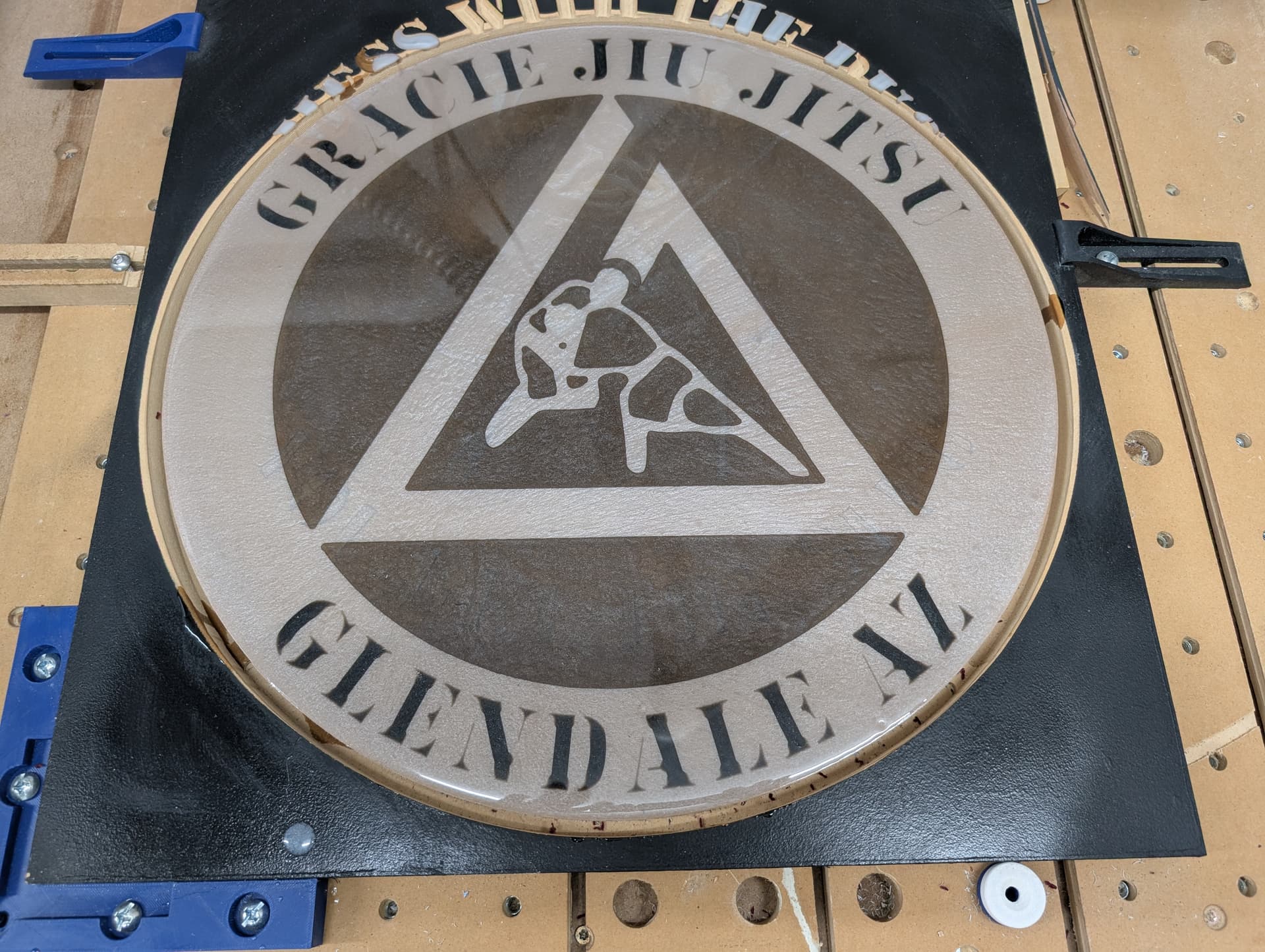

Breaking up a 4'x4' epoxy carve?
I’m going to try and make a sign for my Jiu jitsu school but the 33" limitation would be too small. It’s supposed to be a gift, so I can’t go crazy on spending. It’s a 2 color design so for my smaller test piece, I carved 1 layer, poured, then carved the second poured, and then surfaced it and poured a top coat.
Let me know If you think my idea will work or if there is a better way.
  1. Get a 4x8x1/4" mdf and cut that in half
  2. Cut one of the halves into 4 equal pieces
  3. Break my design into 4 quarters and carve one out on each of the smaller pieces
  4. Individually carve and pour two layers on each of the quarters
  5. Glue the 4 smaller pieces on the remaining 4’x4’
  6. Try to fill the gaps best as possible and pour a top coat
I know I would need to leave a lip between the quarters so the epoxy doesn’t pour out and account for blade width etc…
Has anyone done this? Is there a better way or another option to start with a material that is all black and only do 1 carve? Any advice is greatly appreciated!!

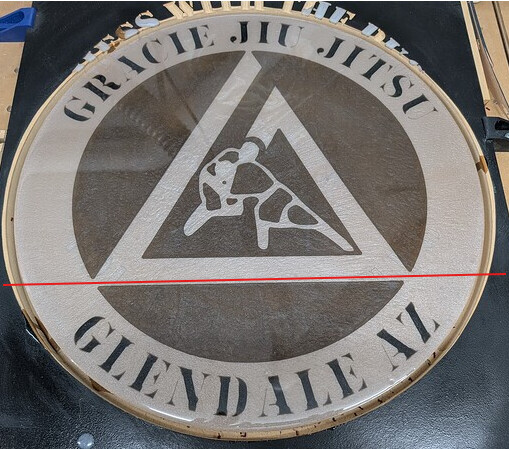

I think I would consider splitting it here, and tiling both pieces.

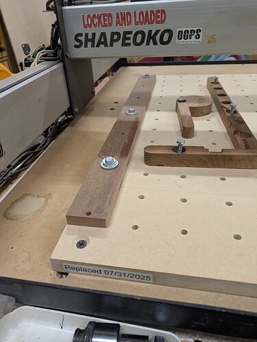

As @Tod1d suggested the tiling and splitting the sign up into 2 sections about the 1/3 mark would be the simplest method. Tiling is not hard. I put a board on the left side of my spoilboard and ran the router down it with the jog to make it straight and square to the Shapeoko. After machining the two part and joining them then fill your epoxy. To join them you can use dowels, biscuits, loose tenons or mortise and tenon, tounge and grove. You could simply glue the two parts together. If it is mdf I would use something besides just glue as mentioned above. A groove in both parts and a long tongue to join them together.
Guide for tiling.

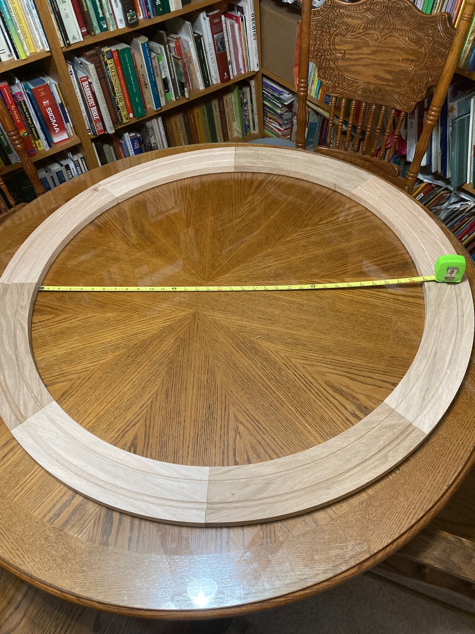

I would do what Stankus suggested above. You may have to scale the sign down a bit but it will still be quite large. First paint the material white. Cut a maximum square to fit on the machine and cut the inner circle (maximum diameter your machine will do). Design the outer circle in segments (six or eight) and cut them. Glue up the outer pieces and the inner circle. Here is an example where I did a ~42 inch diameter circular trim for a custom window. This was eight pieces of red oak. Cheers.
