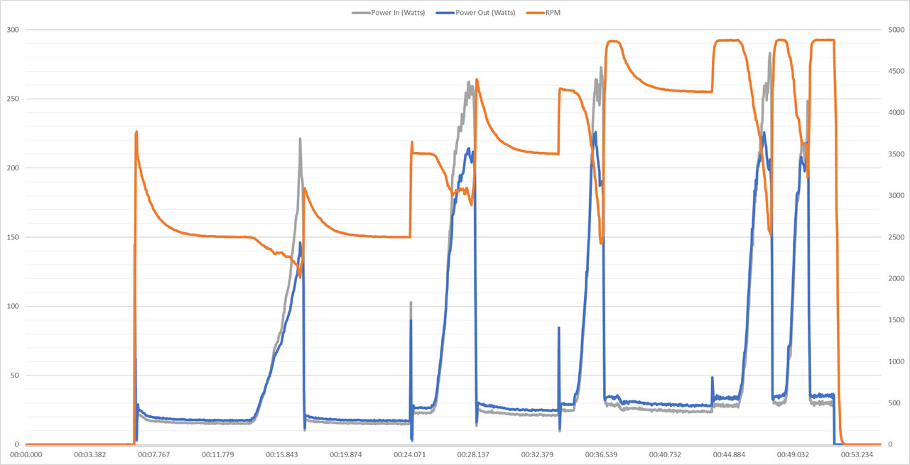

Here is a CSV of it running in manual speed control mode to target rpm. PID is definitely the way to go.
Looks like some overshoot in the speed controller. Charts assume that Kv = 190 and force would be for milling with a 1/4" endmill (double it for 1/8").
