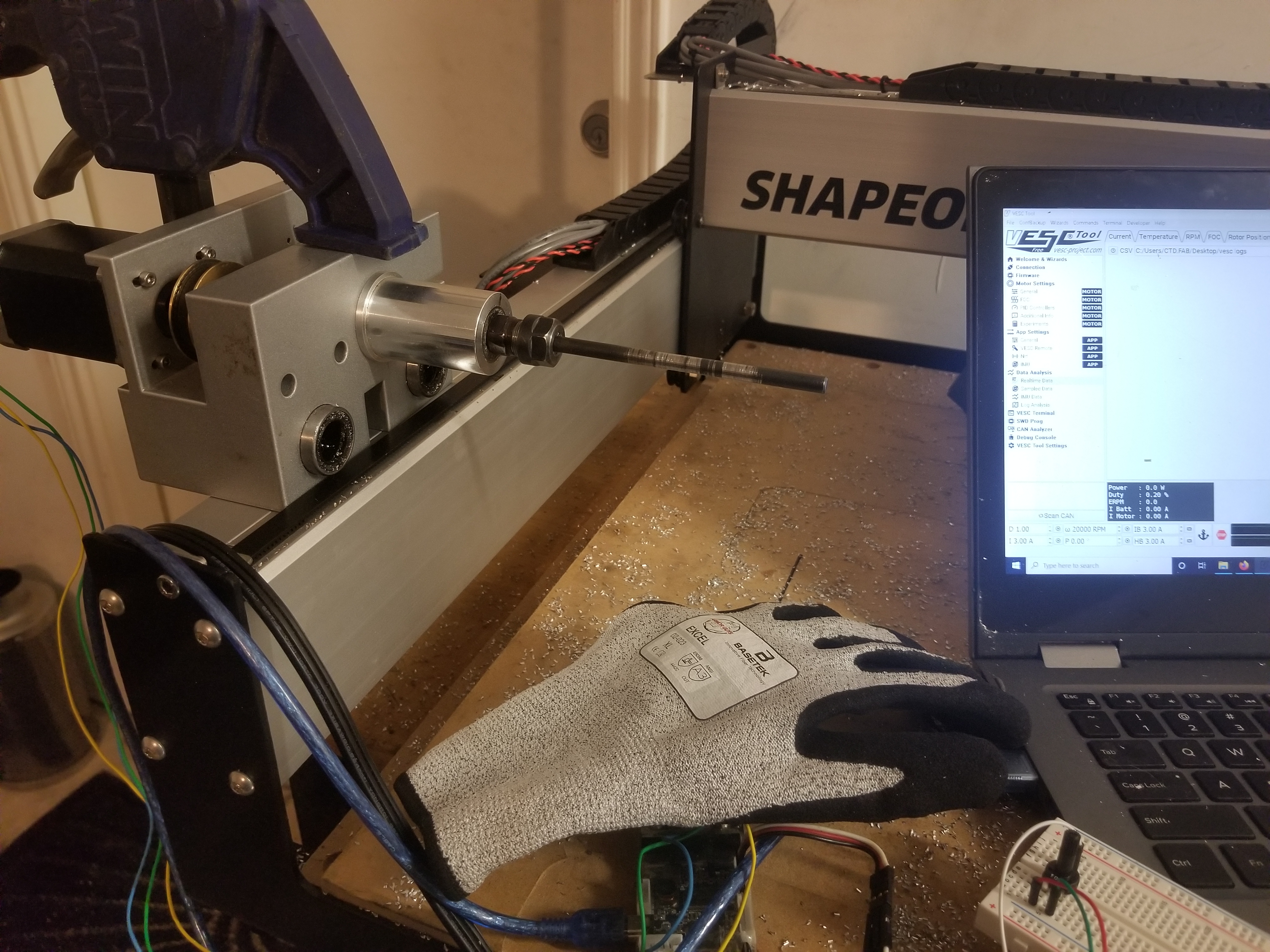

Connected the VESC to the stock Nomad spindle motor and ran a successful FOC detection. Then proceded to run it through to max rpm @ 27.2v, 5,039
So 5,039 x 2.5 = 12,597 rpm at the spindle
15.1 max amps X 27.2v = 410 watts?

I was going to say something about the rpm not being linear but decided to test it. Some type of cooling will be needed, it does warm up.
Edit* I hooked up the vesc to a 10k pot and ran duty cycle control through the ADC. Worked pretty well and would eliminate any computer hookup. Also a pwm relay could switch it on/off

I reassembled the stock Z and did some “load” testing. Basically a smooth rod in the collet and applied friction with a glove while logging. Its not real cutting data but should help approximate what kind of power it has.

It appears to me that the pot is being used to provide a voltage that sets the target speed for the VESC. A PI controller in the VESC could set and maintain the speed with essentially no error, but it would be slow in responding to load changes. Adding a differentiator (for a PID controller) could achieve and track changes faster, but could cause instability. Tracking rapid changes in loads (as in milling) accurately requires a differentiator gain increase which will increase the likelihood of instability.
Care to repeat your test with FOC?
That was using FOC and manual duty cycle control. Run in three target duty cycle amounts and applied a load by hand (not very steady).
