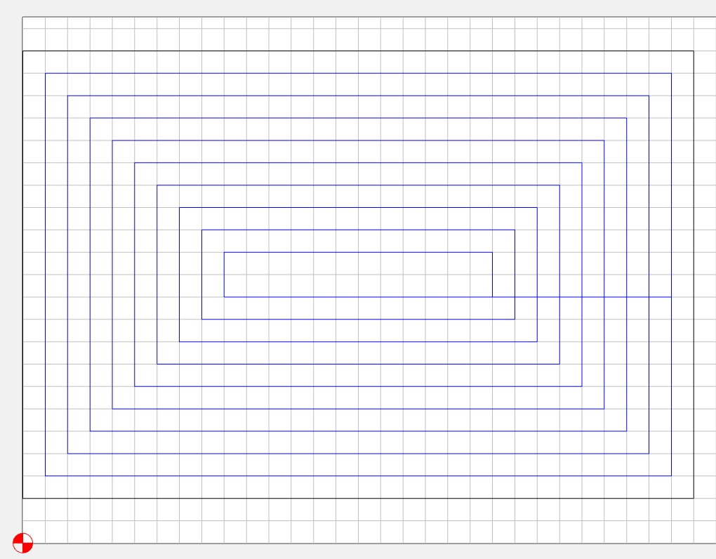

I have to agree with the bug. I observed this in several runs recently.
This toolpath image shows that the first inner circuit of the pocket has no stepover.
This is a 1/4" bit toolpath. Grid size is 0.125".
The test file is attached.
