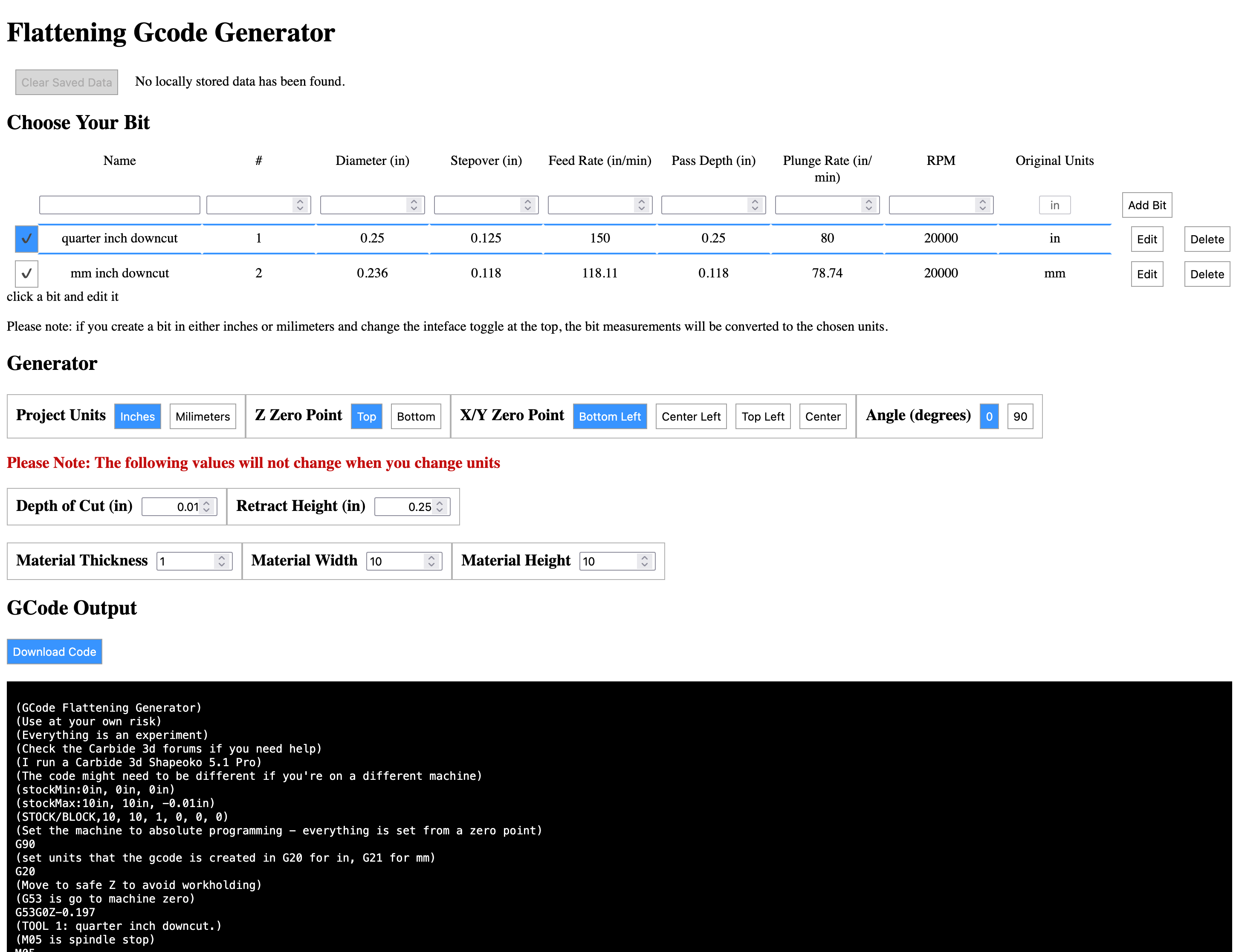

Ok, after I started working on this in Rust to help learn for work, I told my wife that I could probably get this done in 1 day if I was doing in Javascript and have a nice interface as well. So last night I decided to just do that so that it’s something shareable.
It’s not perfect but here are the basics:
Allows you to enter settings and bits that are saved into your browsers storage so they persist when you refresh the page and reopen the page
You can input as many bits as you want with all the normal settings
Set the zero point for the z axis to top or bottom
Set the xy zero point to bottom left, center left, top left, and center
Set the angle to either 0 or 90 degrees
Can work in inches or milimeters
Toggling between the two converts the bit values so you can enter your bits once and if you change between units you can still use them
Set your depth of cut, retract height, material thickness, material height, material width
Gcode output on the page so you can see what’s being generated
Button to download the Gcode as a file called flatten.nc
Still needs:
The interface needs to be more responsive to different viewport sizes
I don’t know what some of the top matter in the files generated by CC mean so I need to get better clarification. Specifically the stockMin, stockMax, and STOCK/BLOCK entries
Some of the styling should be tweaked for more clarity
I’d like to find a way to make this more touch-friendly because I plan on using it on my machine that I only interact with through a touchscreen. I need to test it first and see what does and doesn’t work, but I want it to be easy to use in that way otherwise I won’t bother using it myself
I have not yet tried the output with a real machine so if you try it, keep your hand next to the kill switch but also tell me if it does or doesn’t work. I’m hoping to give it a try tomorrow evening but we’ll see if my schedule permits.
Any feedback would be great. It’s written entirely in Javascript, CSS, and HTML.
This looks great! I have only taken a cursory look so far and have not run your gcode.
I think you should set an option for how much overlap you want on each pass. It’s pretty simple to throw that in to what you already have.
You might consider going to the end of your pass / far edge of your material and then reversing direction instead of returning to X0Y0 but that’s not necessary; it would only save a little time. I throw all my X or Y coordinates into a list and reverse it – I’m pretty sure that’s easily done in JavaScript.
I can’t answer the questions about stockMin and stockMax. I have only used Carbide Create and my GRBL update has broken my ability to use Carbide Motion as my machine isn’t recognized (for now). I’ve been using CNCjs since the beginning.
If Carbide Motion accepts an outside GRBL file, then I think you have what you need already.
