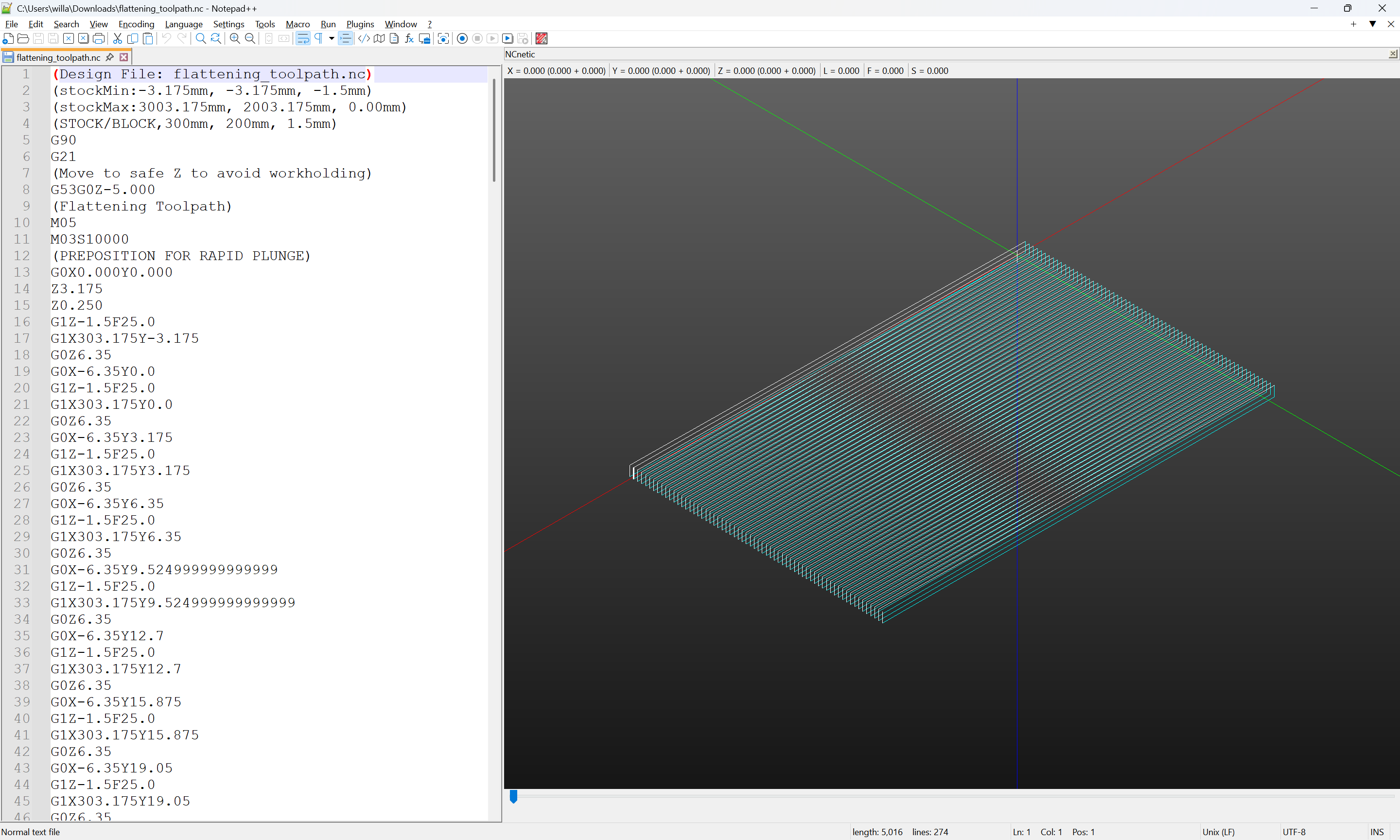

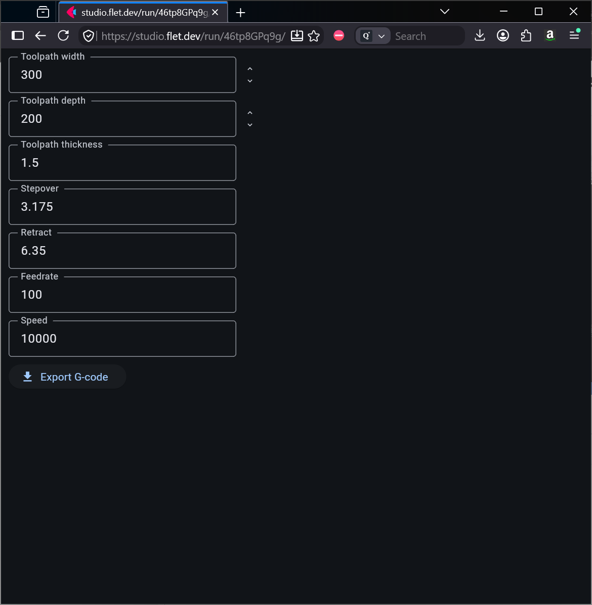

anyway, by re-working the code which I had from the previous project I’ve got a proof-of-concept which just needs for me to write some G-code boilerplate w/ variables and a loop…
And after writing one loop, an If check, and a bunch of string and float conversions in addition to the various G-code boilerplate we have:
https://studio.flet.dev/run/46tp8GPq9g/
which outputs:
flattening_toolpath.nc
to one’s Downloads folder
Tested in Edge and Waterfox (I was still breaking and fixing it until just now).
Please note that I haven’t had time to test the G-code yet (but it seems okay based on NCnetic’s plot as shown in the screengrab). It’s supposed to run w/ the current tool, and cut from the negative of the stepover in X and Y in straight lines to the right iterating until the Y-axis has moved to be greater than Depth + stepover and as far as Width + stepover.
Constructive criticism and bug reports are welcome.
Units?
Feedrates output as 25 (parameter is 100), and far too often.
Decimal places on some Y moves?
DOC?? When surfacing to get something flat, I use one cut at 0.001" (CC doesn’t like 0.000) and rerun changing Z if necessary. If shooting for a specific dimension, I’ll use multiple DOC. Or based on how much material to remove.
Did one yesterday with 0.050" max, 0.003" DOC (Sanding disc), and just hit Stop when it was cleaned up.
Parameters are “Toolpath” width & depth, not stock width & depth. Do you need to add the stepover as overtravel?
StockMax is *10
What is this move?
Units are millimeters (I’ll add a note on that). Decimal places on Y moves are because it’s a float.
Depth of Cut and Max Depth and Depth per Pass are all the same value.
There are additional feed rates because all passes are made in the same direction and it lifts and moves back to the origin.
Stepover is added as overtravel because my assumption was folks might use this for a McFly and want a side entry and the origin would be at the corner of the stock, but it might not be perfectly square/measured accurately, so overcutting by stepover all around seemed expedient.
EDIT: also, I had the preposition for plunge at 0,0 — now fixed to -stepover,-stepover

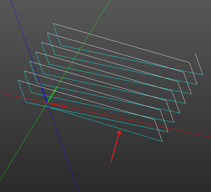

Does G1 need a redundant feedrate after G0?
Shouldn’t overtravel be MORE than tool radius? Especially if uneven stock is expected?
I usually don’t want it plunging into stock. Rather plunge/stepover off the stock, then cut across it.
In which case the overtravel is only necessary in the ‘direction of cut’ axis. (X in this case)
Or, overtravel in the ‘across cut’ axis (Y) should be cutter radius - stepover, so the first pass is removing the same material as the rest of the cuts.

With overtravel set to tool radius, the tool comes down adjacent to the stock.
A more robust macro architecture would be cool. But totally understand Rob has to balance things.
OK, so the glaring issues are…
F25 when F100 specified. If that’s a default plunge, then the F100 is missing on the cut line.
15 place decimals. Not sure the python command. tcl is round() or format()
Last pass at Y196.85. Should it not be 200? I know the surface should be done by then, but the whole slightly irregular stock thing…??
Indeed. And I’ll admit tunnel-vision in how “I” do surfacing / flattening paths.
I like to make sure I’m climb cutting at least around the edges so I’m not splintering pieces away from the stock. I also like to start both directions off the stock, so in your example I would start at
X206.35 Y-3.175
X-6.35
So my first cut is taking material.
So the best, common method that would suit the most users escapes me. :smiley:
