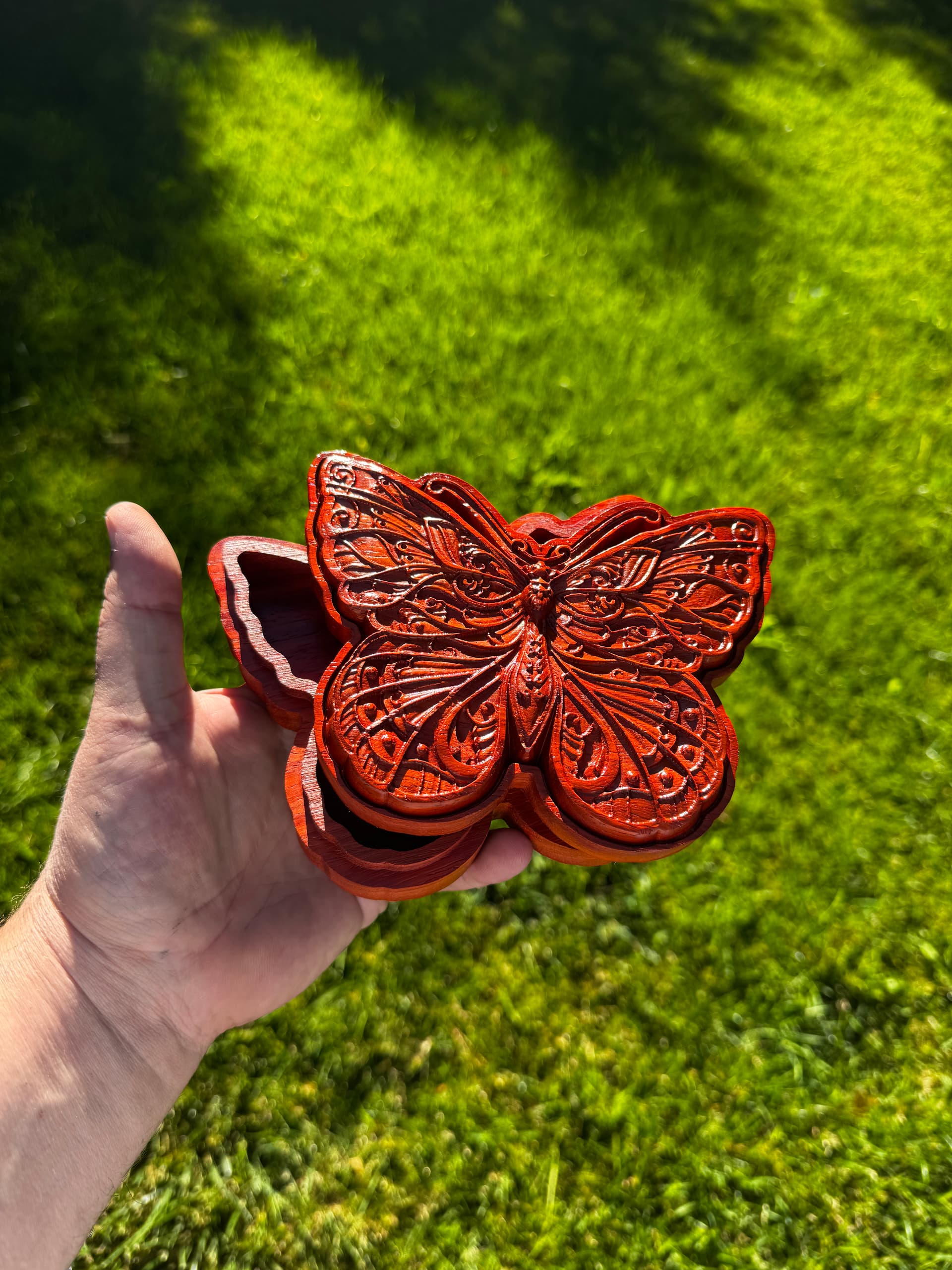

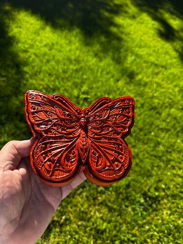

Butterfly Box made using Carbide Create Pro
I have been practicing doing 3d model carving on the CNC. I recently purchased a ShapeOKO 5 Pro XXL and registered for the Carbide Create Pro software. I can’t believe how easy it was to get a .stl model downloaded and carved using the Carbide Create software. It takes about 45 minutes start to finish to make one of these butterfly boxes. I have made several of them now that I have the file created with the kinks worked out. I had practiced 3 times until I finally got a design file created that could be repeated without flaws. Everyone I have gifted them to absolutely loves this finished box. I use Mohawk spray lacquer to finish them because it only takes about 15-20 minutes to dry. I start with a 6.5" X 6.5" blank.

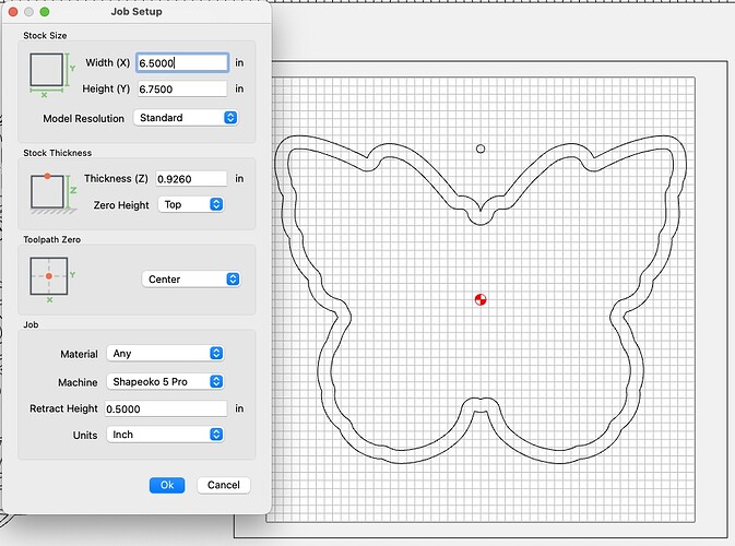

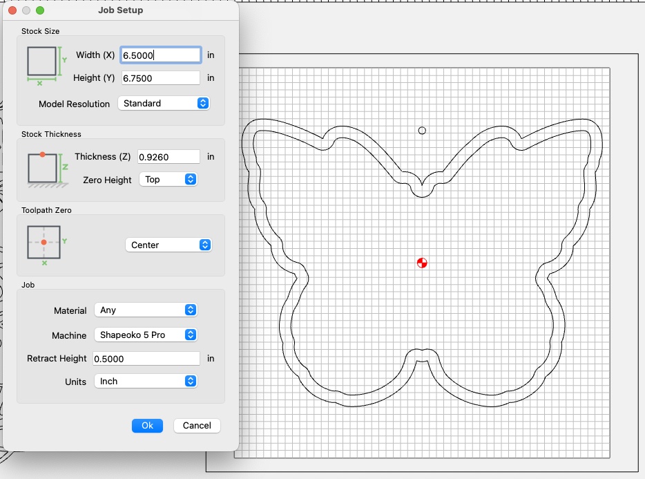

To make the lid was a bit tricky (two sided cut) until I discovered how to index it exactly every time. This is what I do.
  1. Make the Toolpath Zero Center. Work with the outline of the image (stl) that you imported. In this case it was a butterfly stl file.
  2. Center it and then create a .126 inch diameter hole and center it as well either above or below the model.
  3. Use 1/8" drill bit to drill that hole through your project wood and into a backer (either a sacrifical back or the wasteboard itself). This will be the reference hole you will use next.
  4. Use an 1/8" pin (I had an 1/8" brass pin from another project which is 2" long) when you flip the project piece over use the 1/8" pin while it’s in the hole you drilled and line it up with the hole in the backer/waste board. This is the index for the top side of your project piece which centers it with the back side you just cut.
  5. Key is to center everything. Also, make sure you use a fence for the base side of the project piece. That keeps the project square and free from any rotation.
