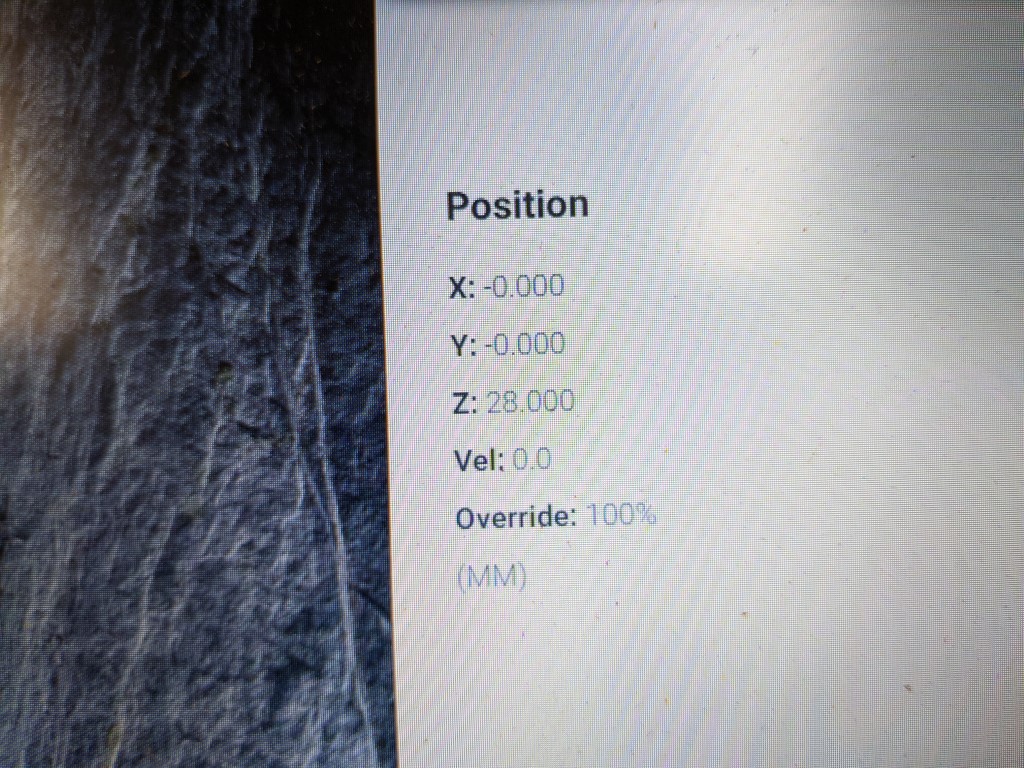

Just installed the probe and I’m getting a weird repeatable error. Place the probe as directed (with lip overhanging the stock), probe X/Y/Z, Z retracts to 28mm (confirmed with 25+2+1mm gage blocks) and CM shows X0 Y0 Z28. All good.
Then I send G0 Z0 in MDI, Z lowers and CM shows X0 Y0 Z0:
The problem is the bit is exactly 2mm above the material surface:

After you’re at Z0 (2mm above) go back to Z28. Still 28mm above? Could be your steps/mm setting.
I’ll have to check that. I did manually go to Z28 but I think it was after I dropped the 2mm.
I did upgrade to grbl 1.1 today before installing the probe. Everything seemed to install correctly, but I don’t see where I can get access to the settings to check/edit anything in CM anymore. I seem to recall

If you upgraded to 1.1 - ALL your settings have gone back to defaults. If you have previously calibrated steps, you’ll need to do so again.
