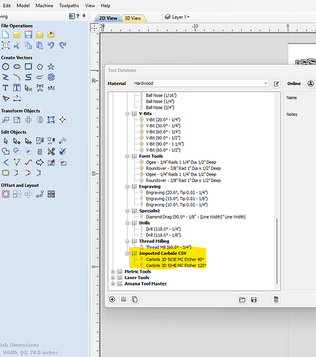

From what I understand, the Locked Tool database cannot be exported. You must first duplicate the Database; you can then find it under %appdata% and open it as a CSV. Once you have it in a CSV you should be able to import it into Vectric.
Vectric tool database doesn’t accept .CSV imports. It has to be in their custom SQLlite based format with .VTDB extension or older .tool format. I added Nomad bits manually by duplicating the closest Vectric generic bit and editing the specs to match Create.
@mookie You are correct. I tried and tried, but I had no luck.
Well, I found a workaround.
If you have any specific tool database in Carbide Create Post, it’s here, and I’ll run it again.
vectric_tool_database_from_csv.zip (250 Bytes)
vectric_tool_database_from_aluminum_csv.zip (268 Bytes)
Looks like it’s working.

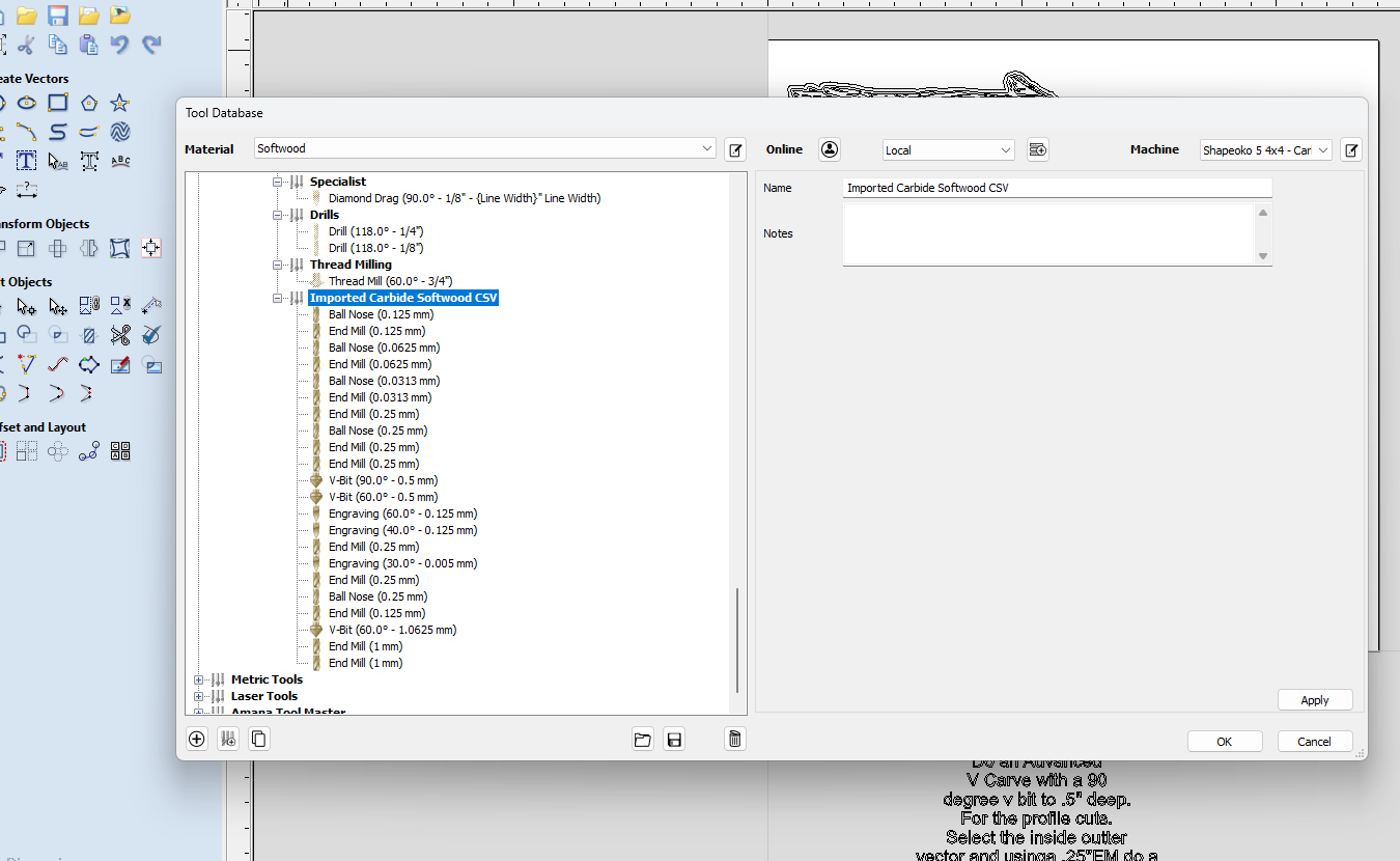

vectric_tool_database_from_softwood_csv.zip (268 Bytes)

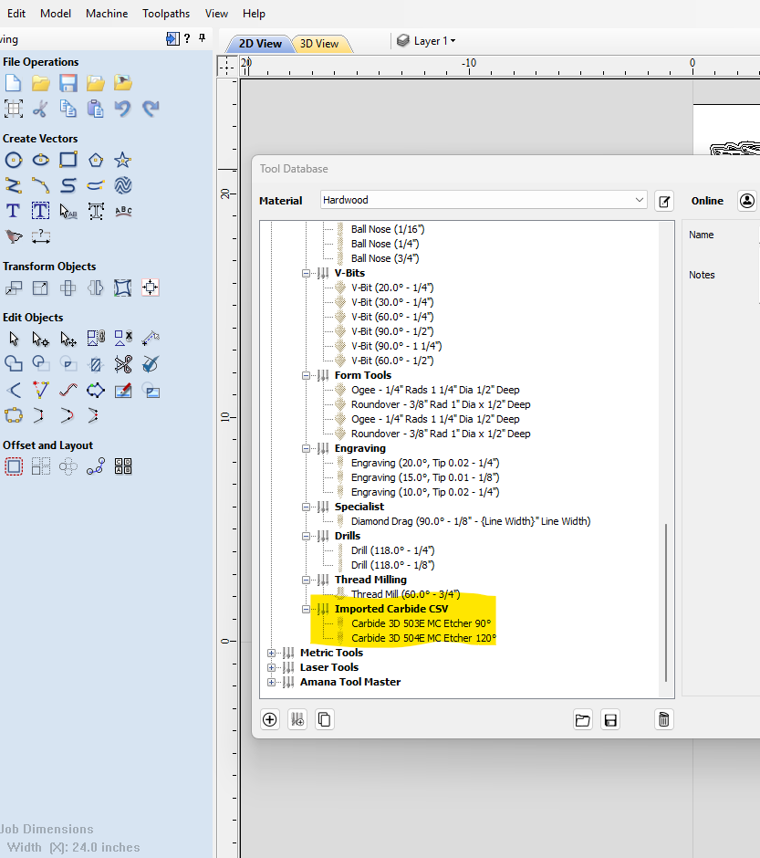

That’s great you figured that out. You have a way to convert CSV to VTDB?
I couldn’t get your unzipped exports to import. What I see is:
The .ZIP’s contain a .vtdb-wal file
Vectric (VCarve) will import a .vtdb file. Export also creates a .vtdb.
When a .vtdb is imported it creates two helper files in the same folder with the same name but one is .vtdb-shm and one .vtdb-wal.
Could you try zipping and posting the .vtdb?
