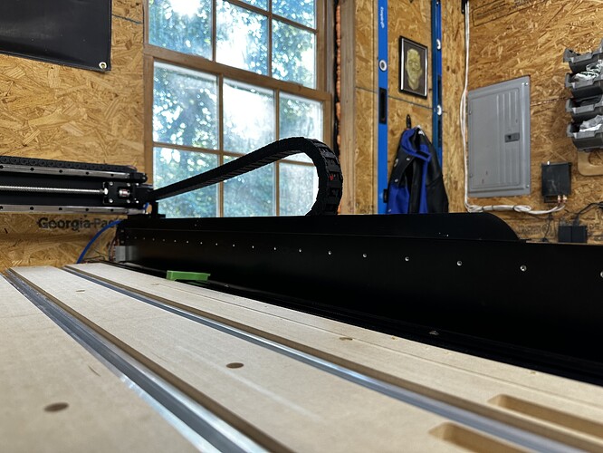

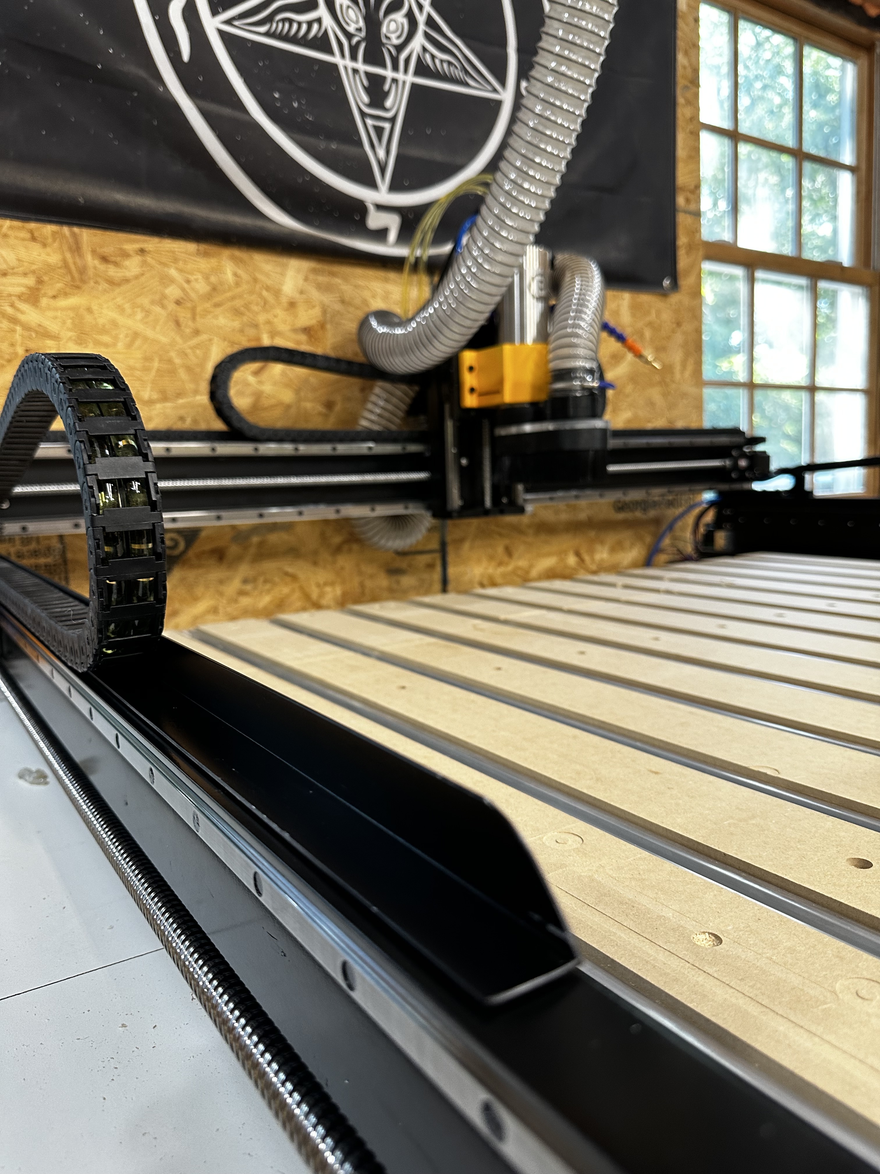

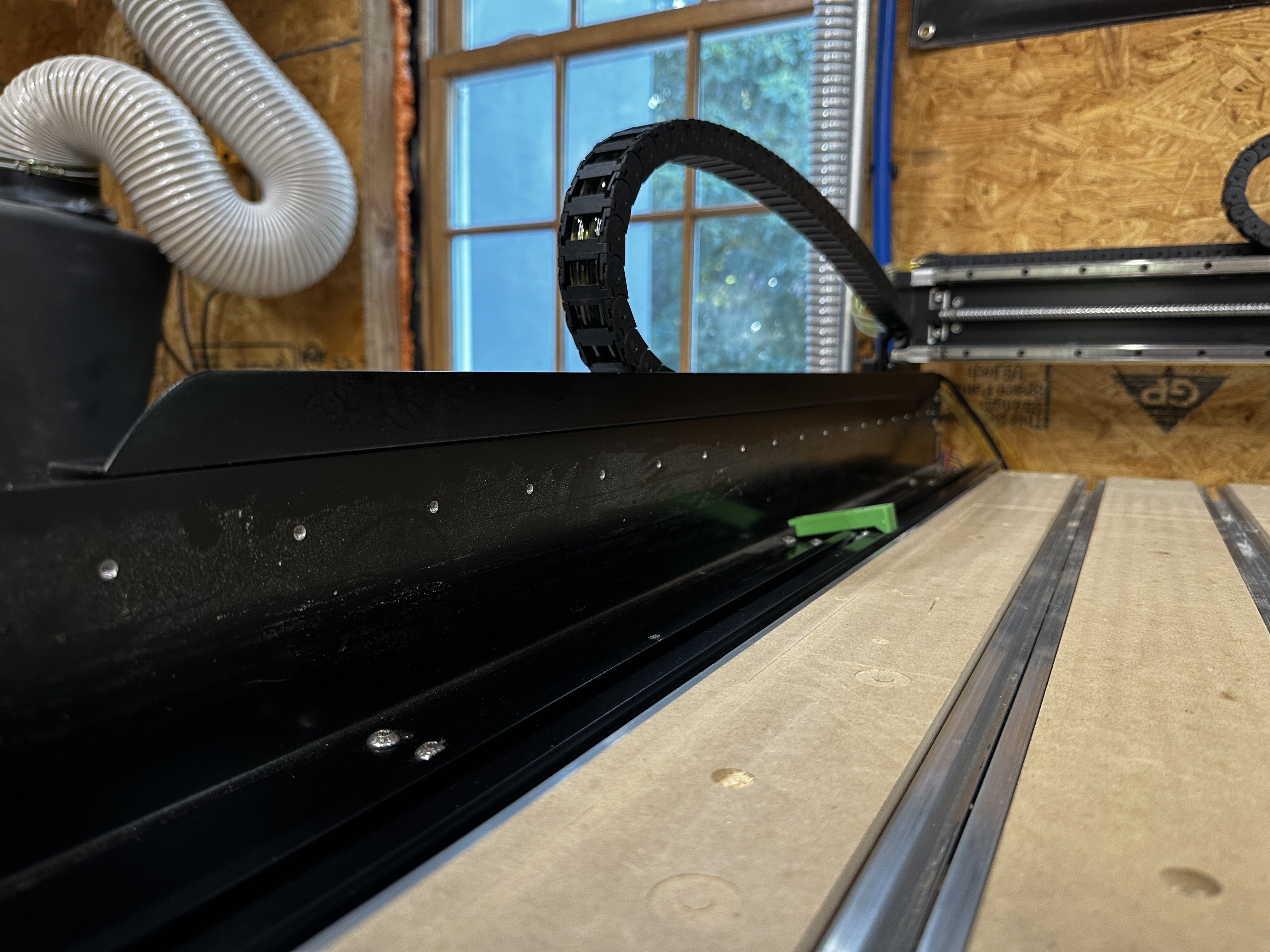

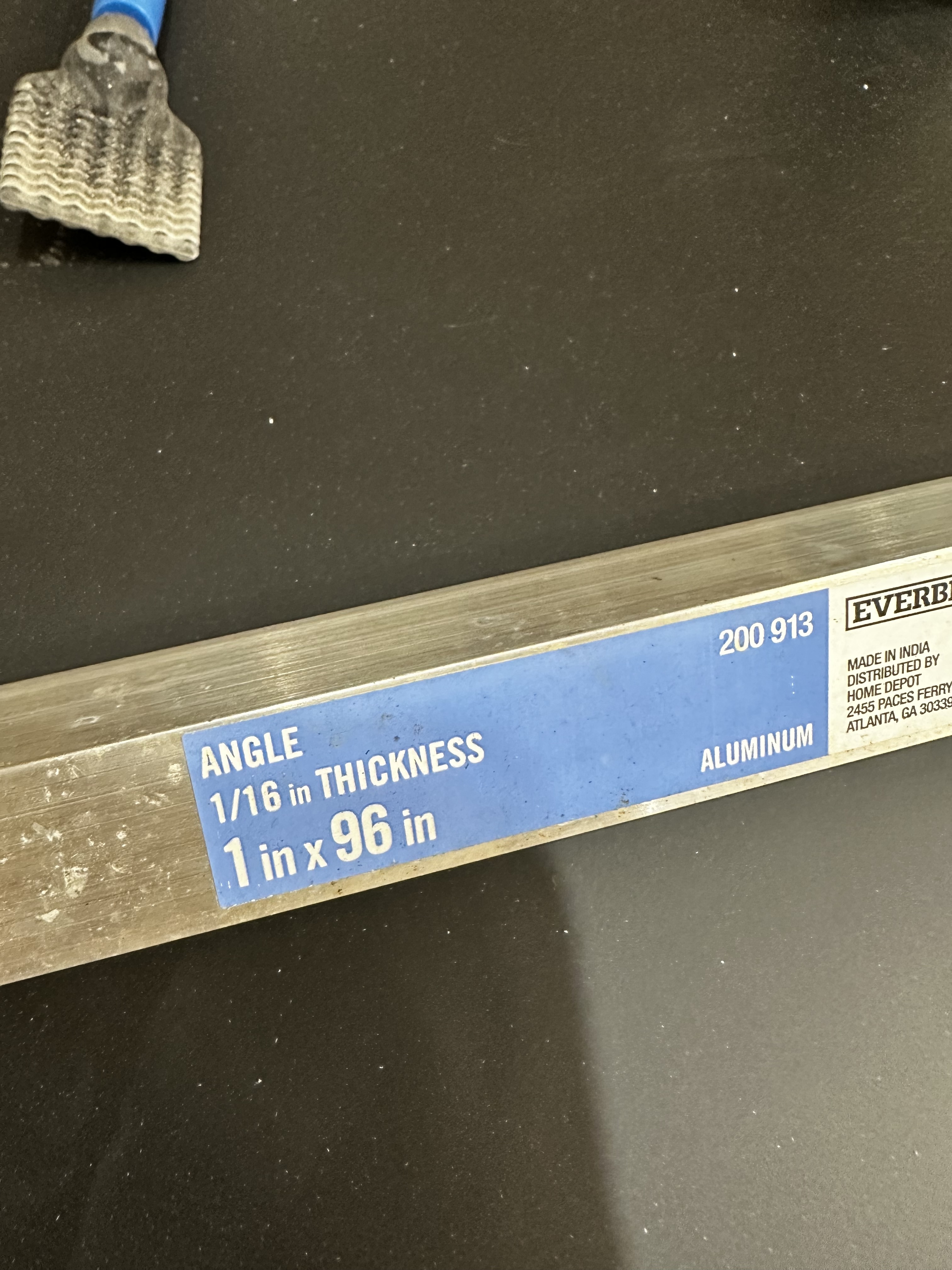

Thought I’d post my solution to a small annoyance with the Y-Axis cable tracks. Since I over stuffed my tracks with air and spindle coolant lines my tracks tend to buckle on top of the bed with the slightest of breeze. I took some 1x1 aluminum angle, cut two 42 inch lengths, filed the edges, painted, and stuck them in place with VHD tape. Seems to have tamed my tracks. I might add some for the x-axis soon.
