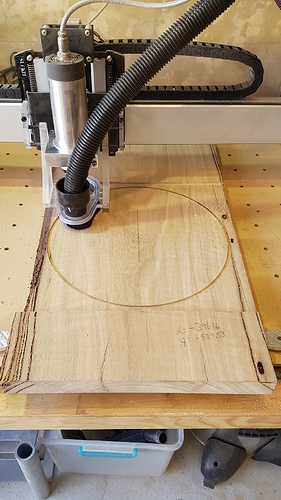

Here I took a 5mm (0.2") cut on the profile, as the timber is very hard and chips easily, I planned to face a bit more off if the profile chipped badly, but it turned out to not be an issue
The reason there has been another square pocket taken out the size of the clock, is that my original design had one of the numerals in reverse…D’oh! Luckily the timber was almost 2" thick so I could pocket it out and start again…
Note I have written down my G54 Zero coordinates, this way if I lose power or have an issue i can find the zero again, I used the centre of the clock as my zero, I measured and marked it prior to the job, as there was not a lot of spare width
