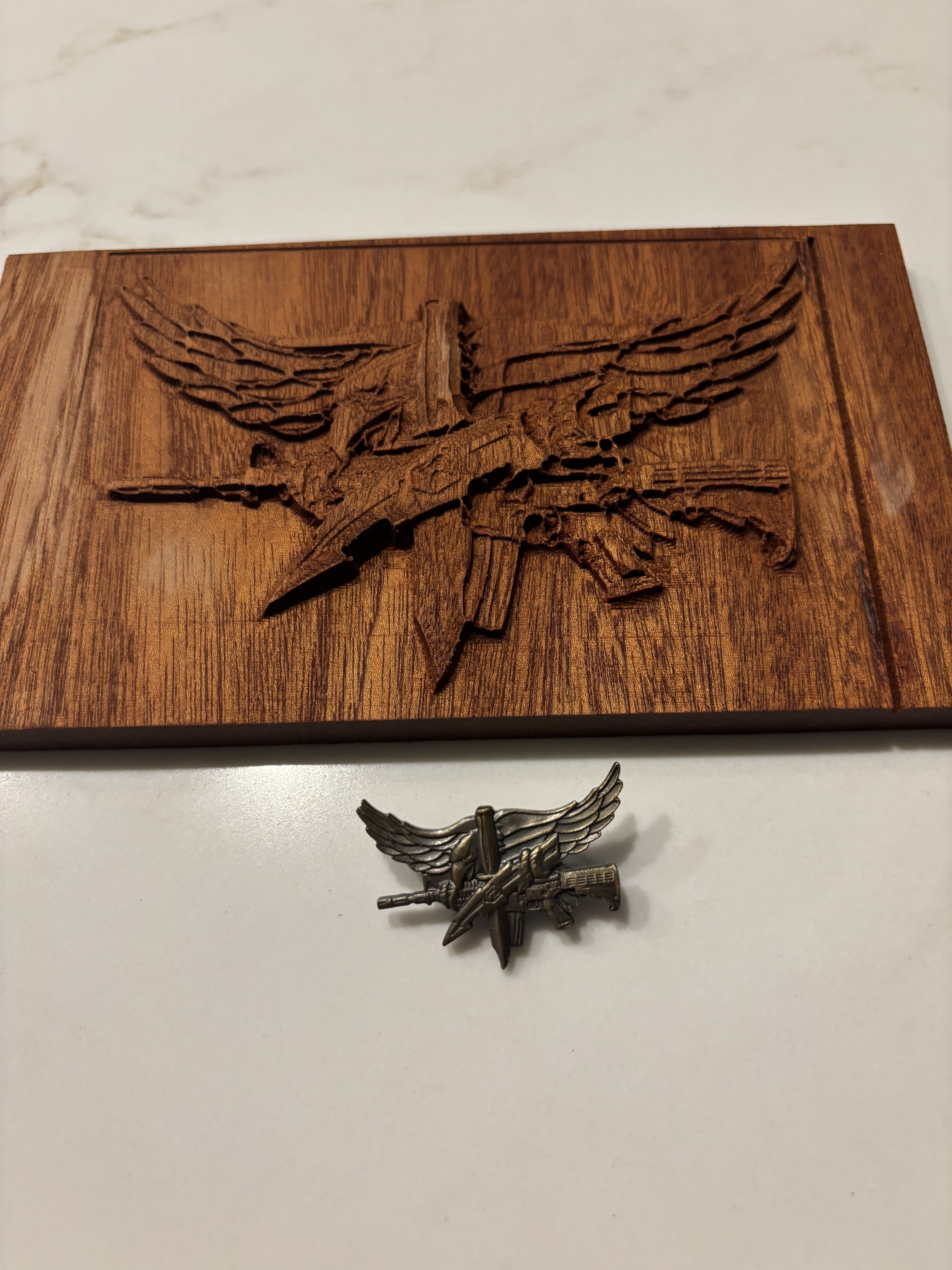

I need some help creating a 3d cutout of this SWAT emblem. I want to glue it to a plaque when its done. I am so confused about 3d carves even when watching numerous videos. Can someone please show me how to create a 3d cutout of this file? I had a hard time with some wavey flags, but when I saw the concept of it, it was easy. Now with an actual figure like an eagle, I cannot get it right.
Please help! Thank you

Thank you will. I see the difference, but I still can’t get it right. I will need to watch more videos and keep trying. It just seems so easy watching videos, but there is nothing easy about it.
I used easy create to make a 3d file. It helped create a TIFF file. Now I need to covert that into something Carbide create will understand. Any suggestions?
Carbide Create Pro will import TIFF files:
I am getting closer. That helped a lot.

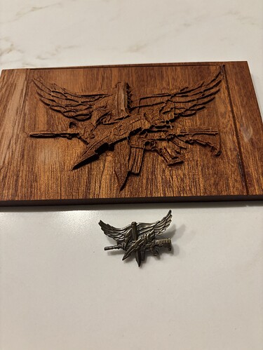

Not a bad start
@SwatBoss226
Agreed, not a bad start at all! Looks good!
What is the wood species?
Mahogany. I think if I carve a bigger model of it, it will be cleaner for sure, but not bad for a first time 3d carve.
