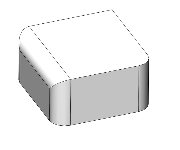

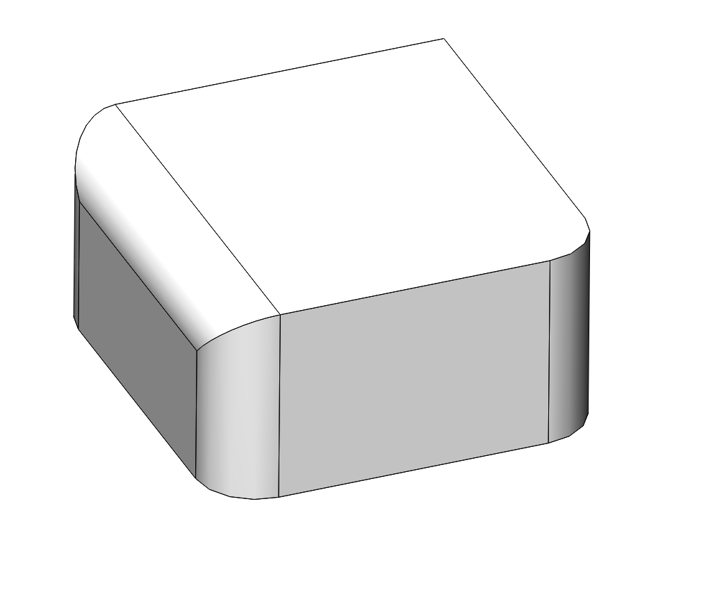

I mainly make mechanical parts in SolidWorks. Sometimes those parts can be mostly made with 2.5D, but some small area needs to be profiled to add a roundover or some other 3D feature. See picture below.

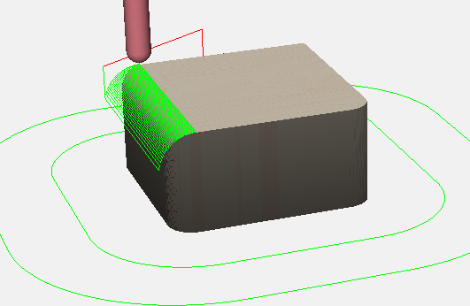

In MeshCAM you can draw geometry or import DXFs to delimit the region for toolpaths.
You can limit the 3D path in CC as well…
Really? Thanks! I didn’t realize that.
See
https://community.carbide3d.com/t/how-to-cut-only-part-of-an-stl/105725/2
