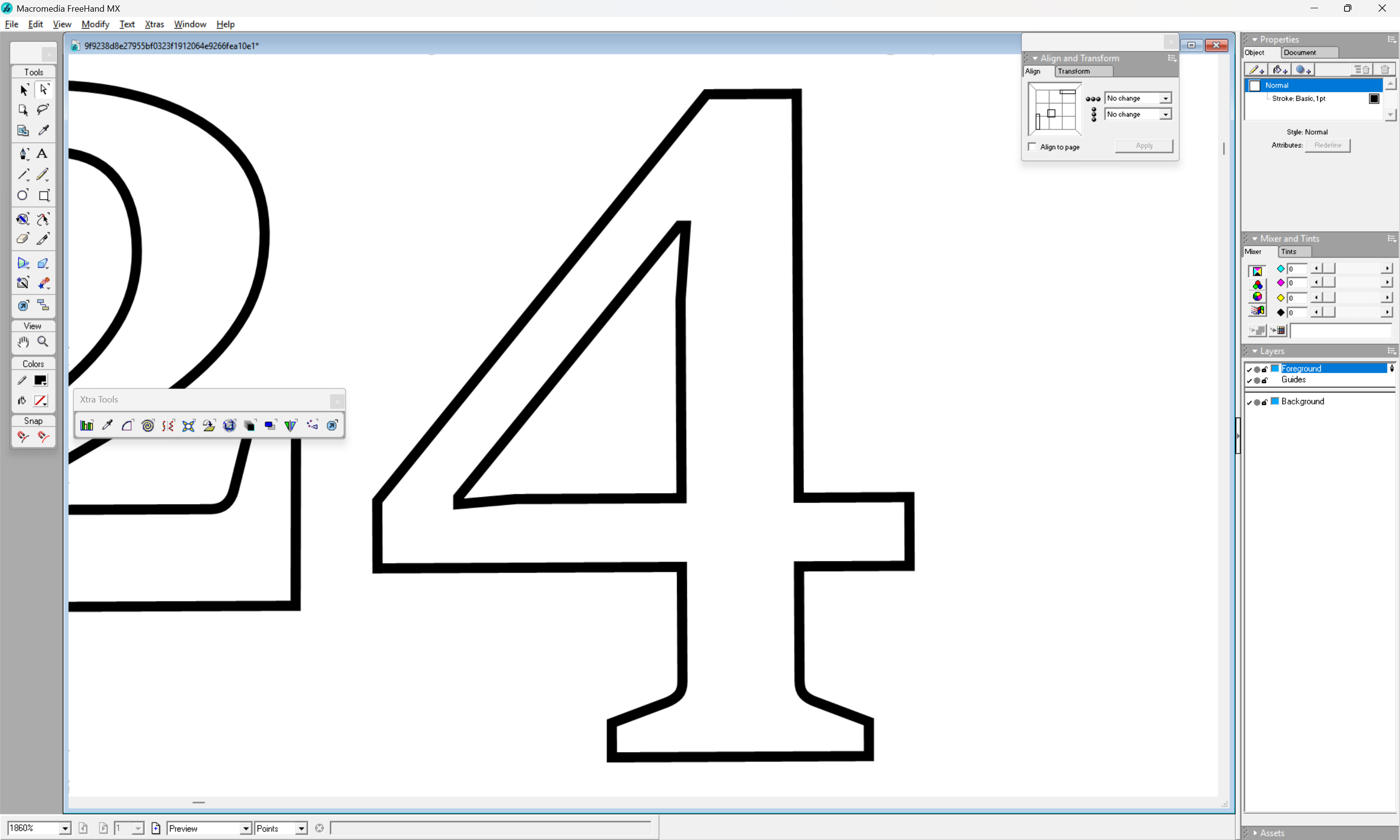

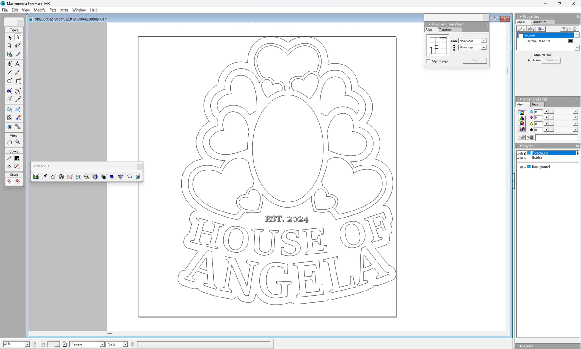

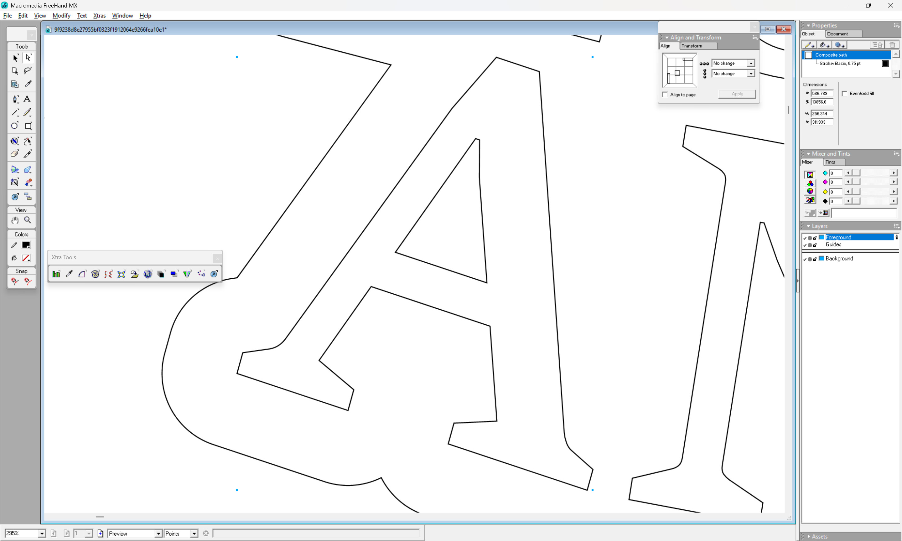

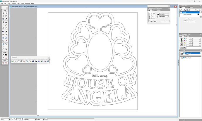

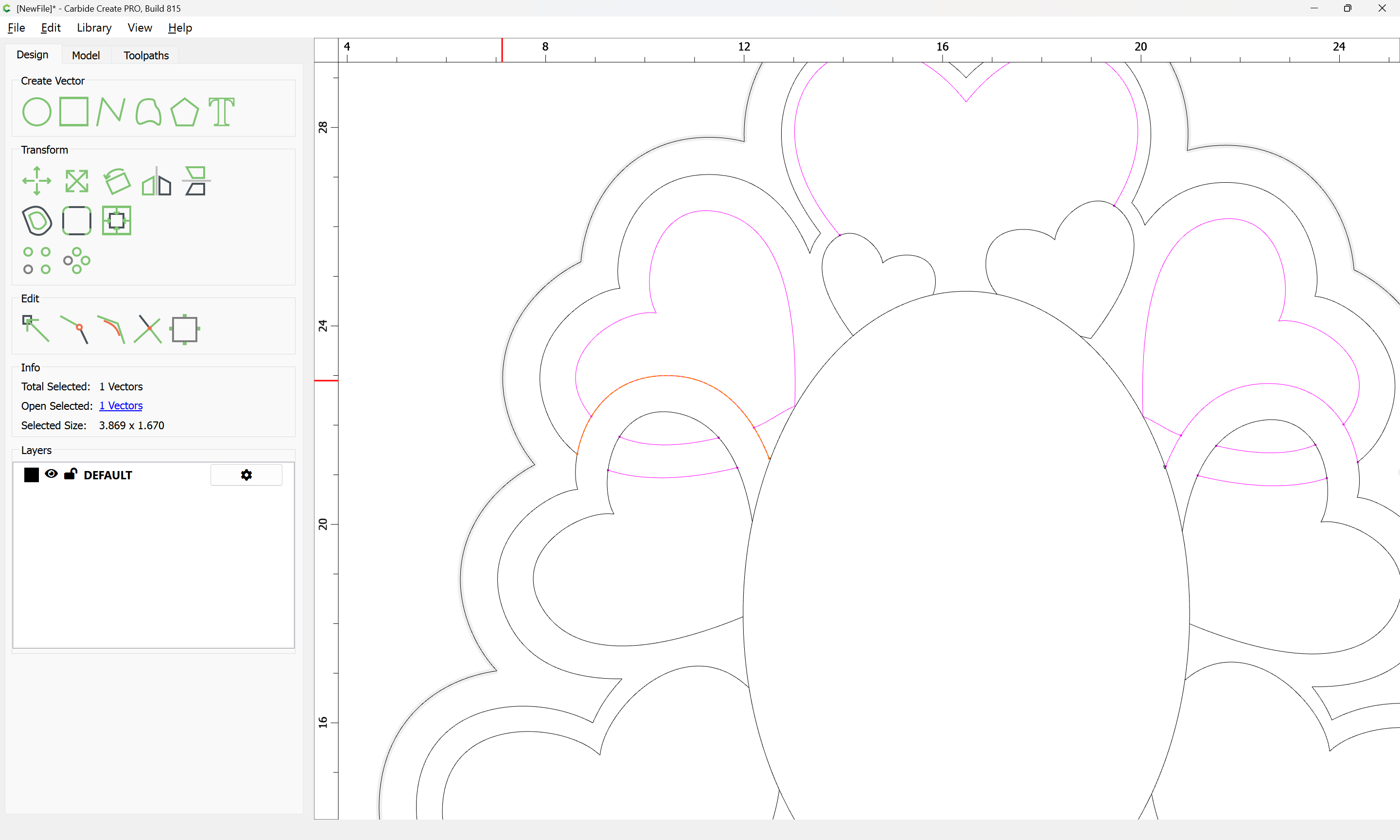

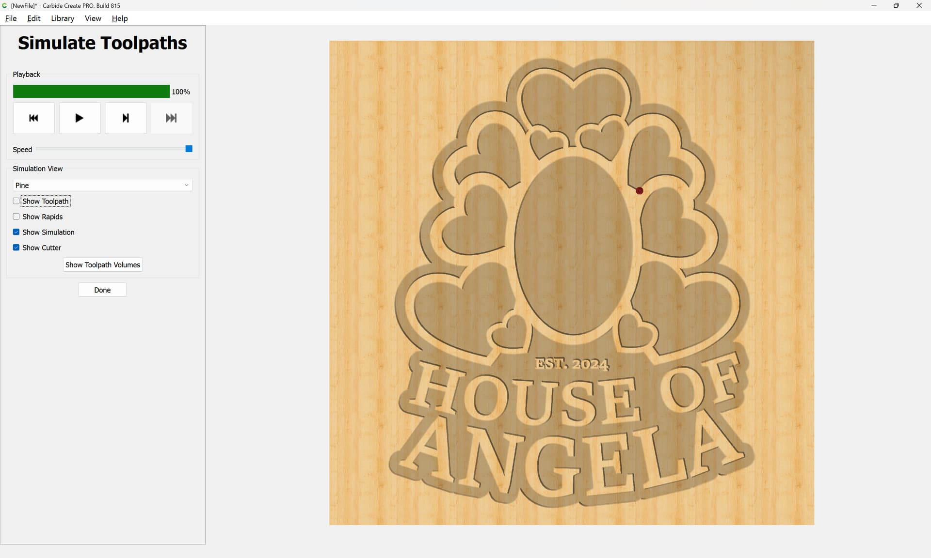

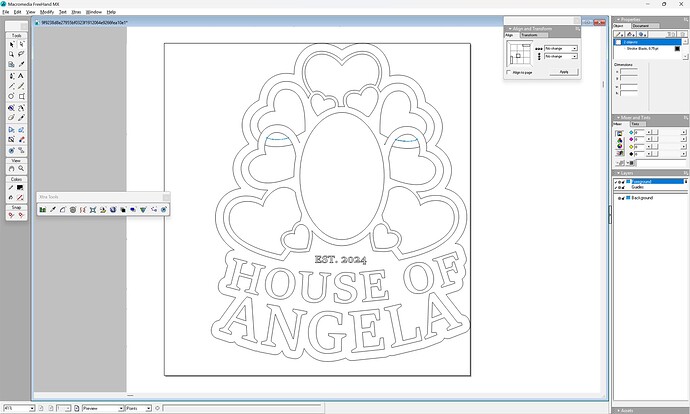

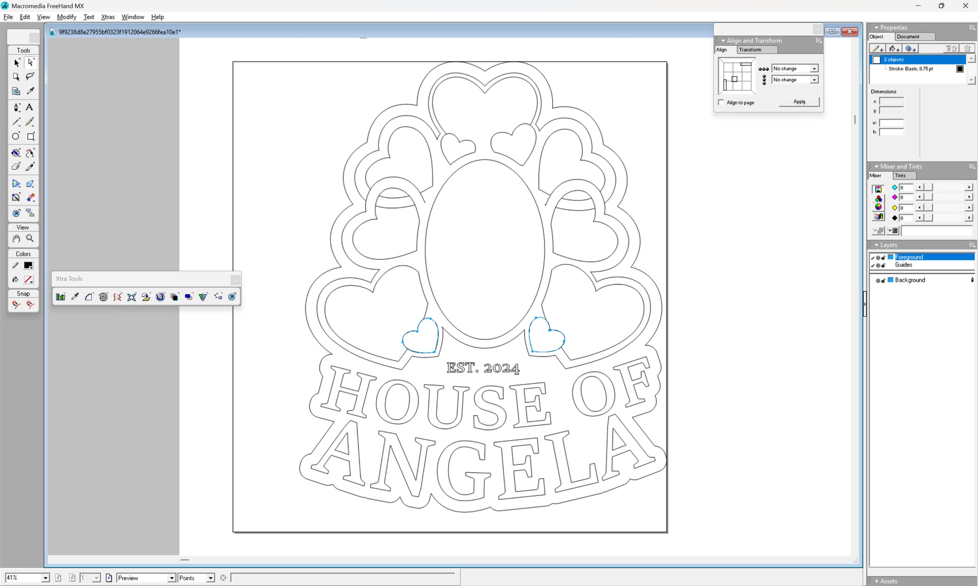

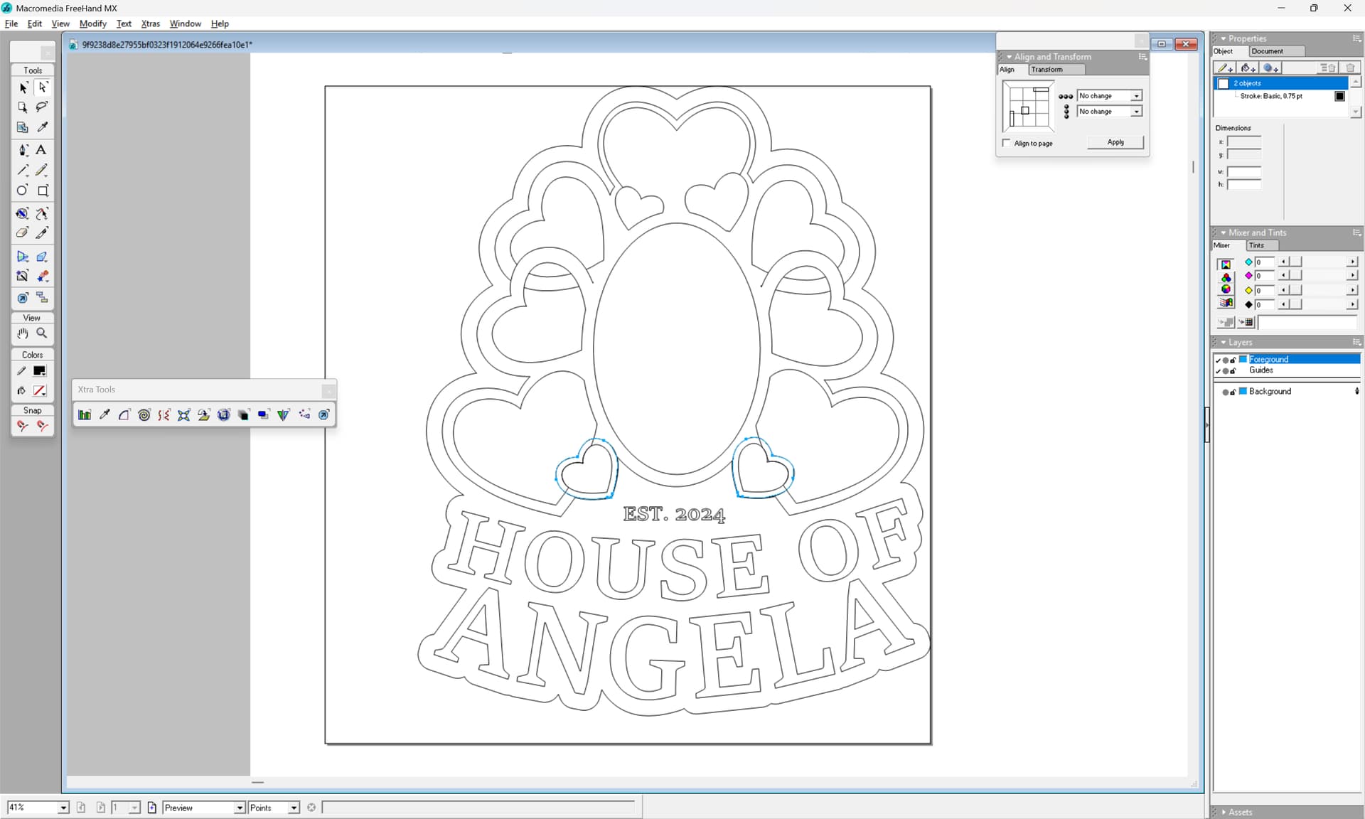

I used most of this from Google SVGs, and some library stuff to create this sign.

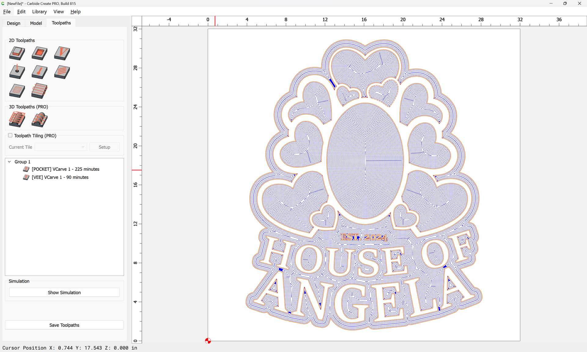

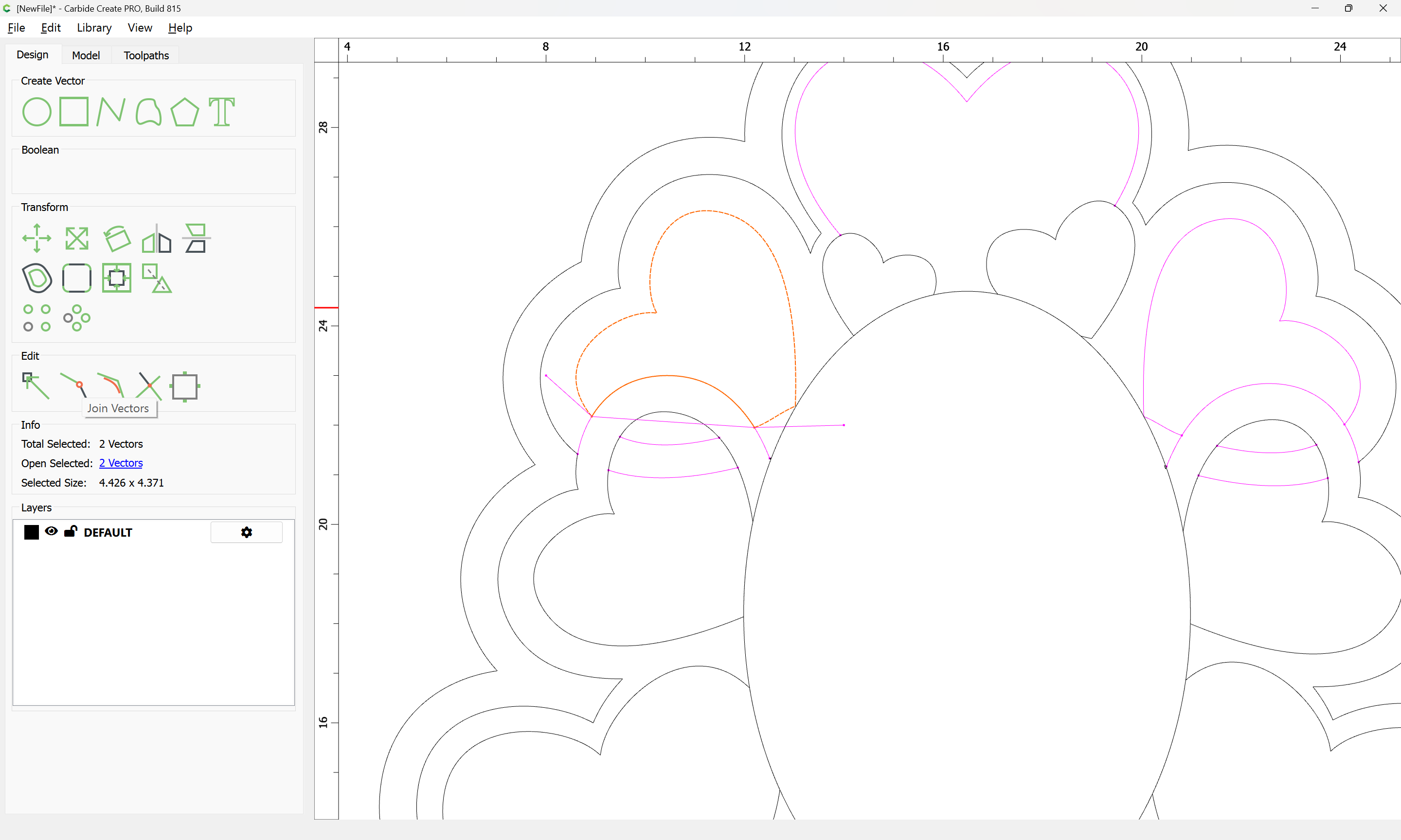

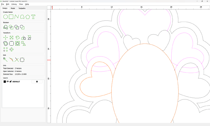

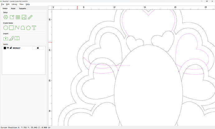

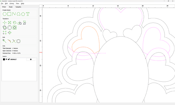

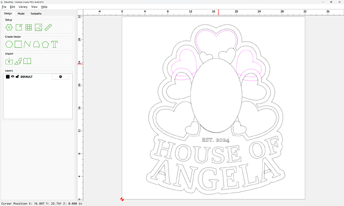

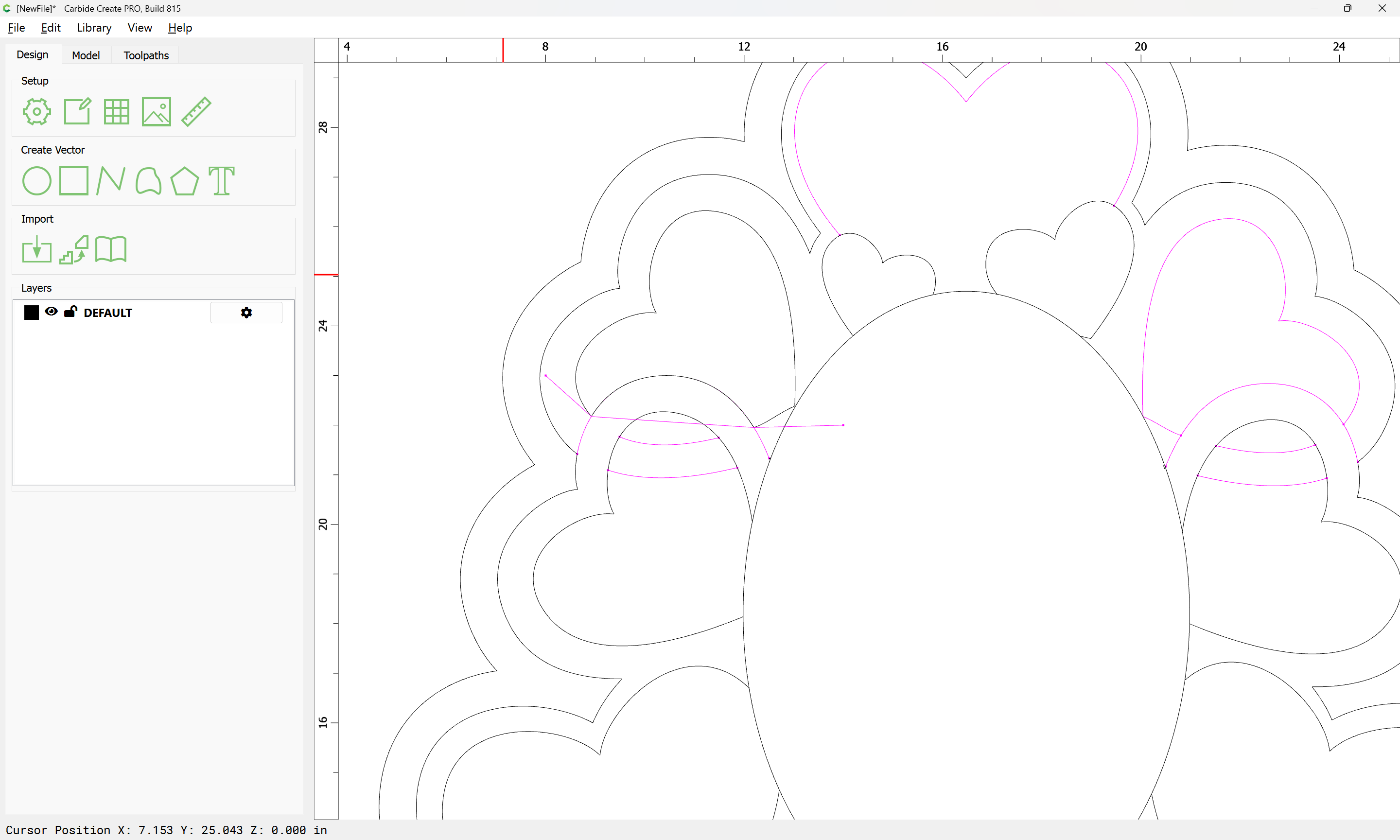

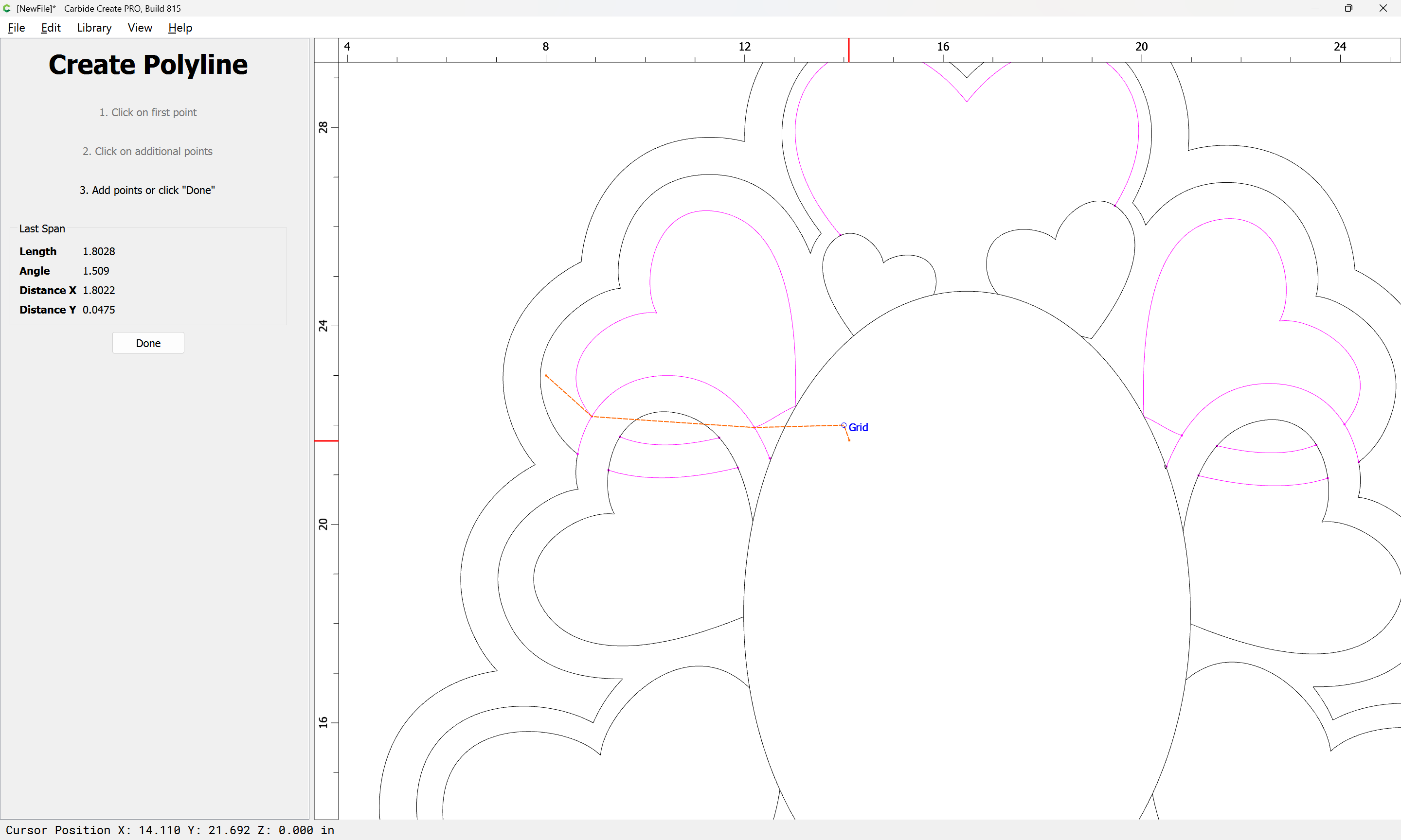

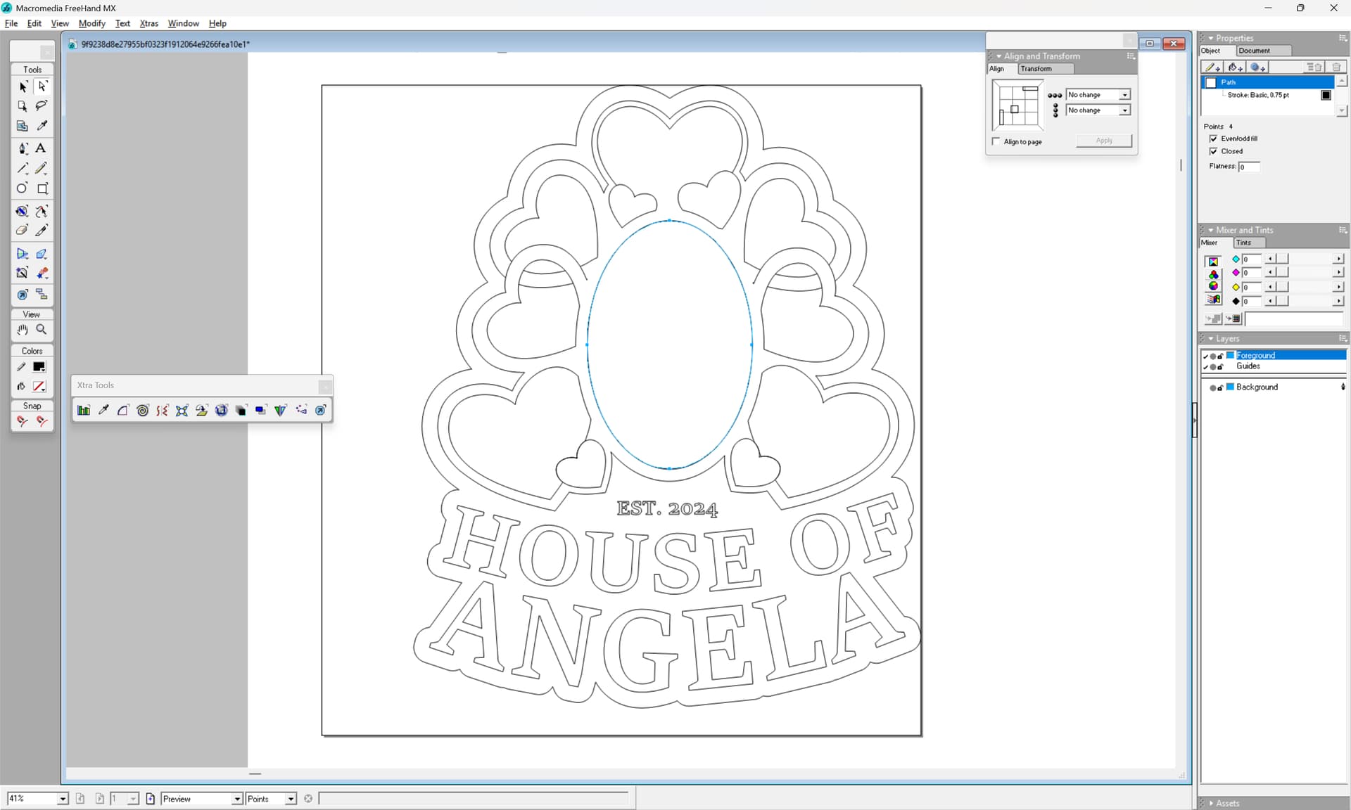

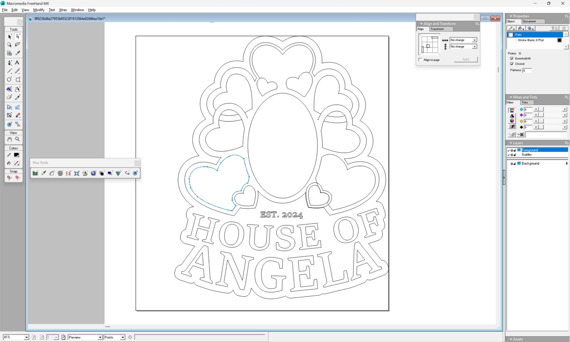

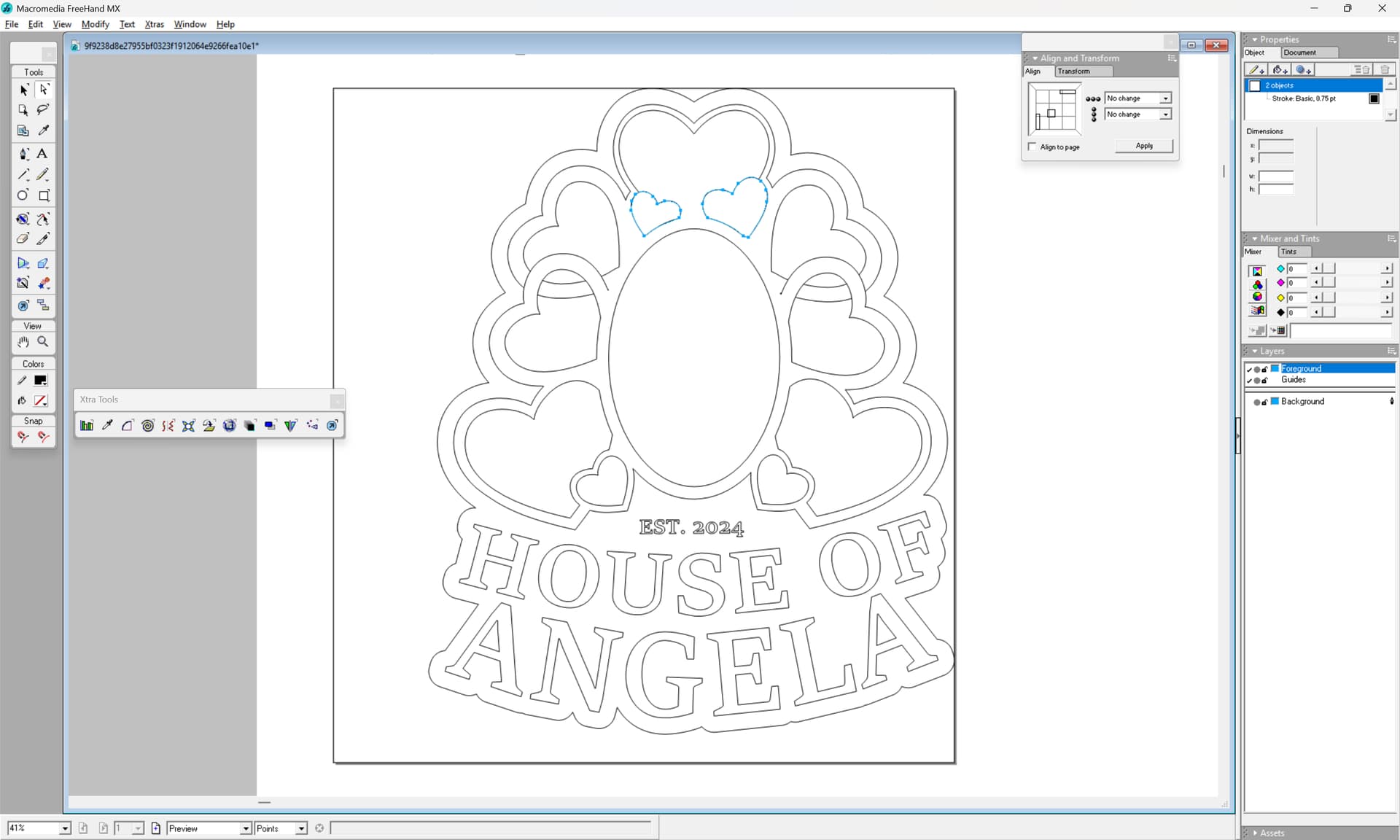

But some of the heart cut outs are in pink or something and they’re not allowing a pocket, i want the thing to cut out just like it looks, but i can’t tell how to make all the areas pocket correctly.

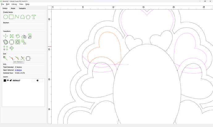

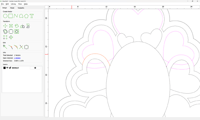

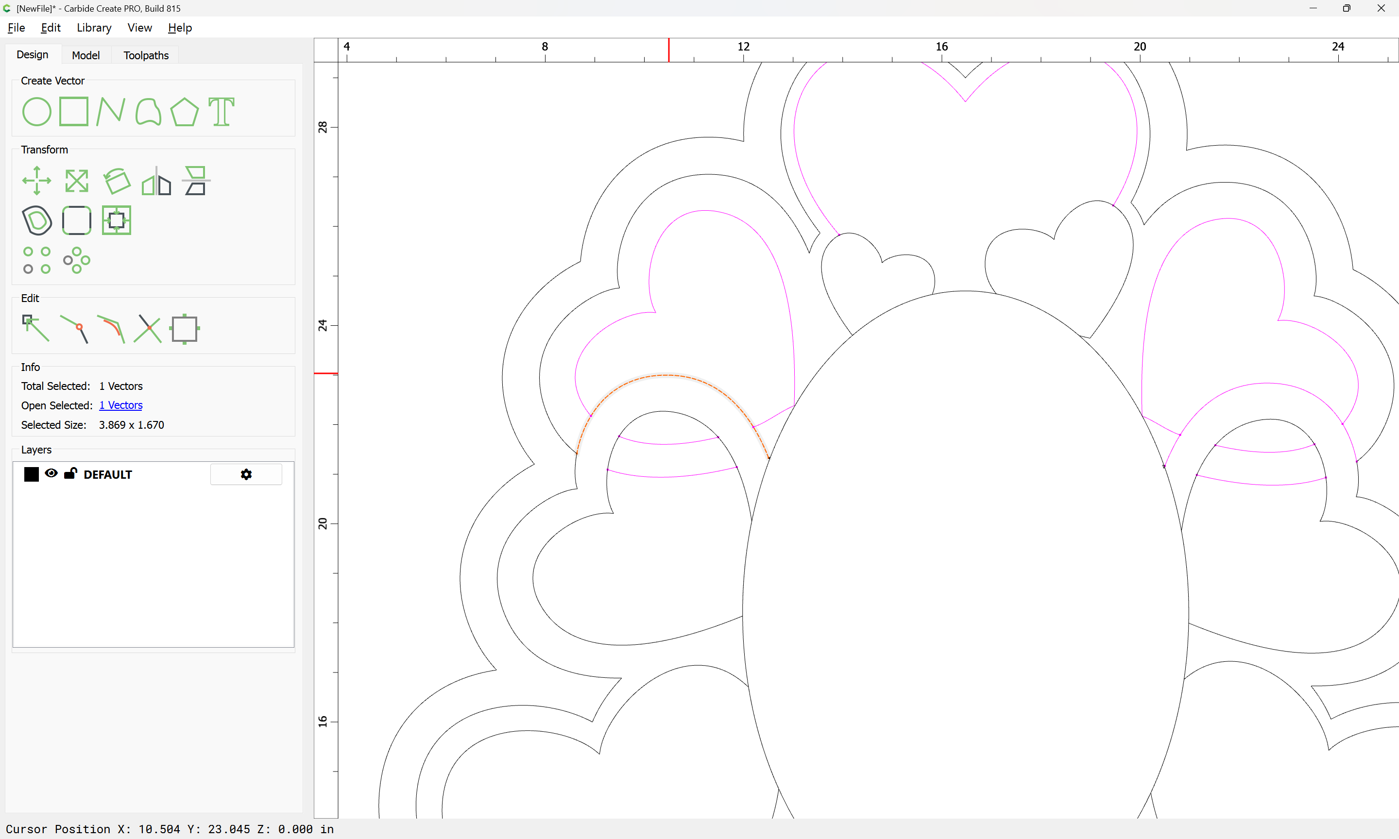

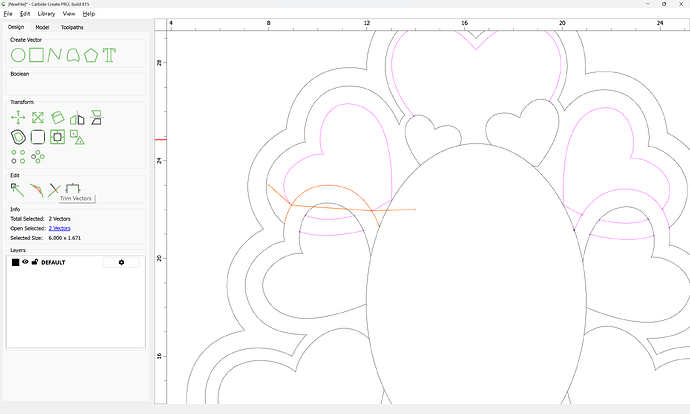

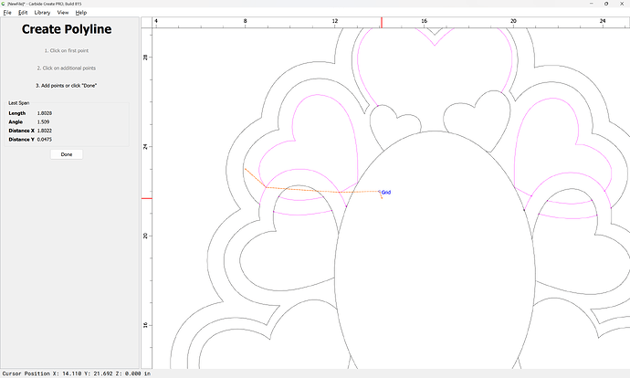

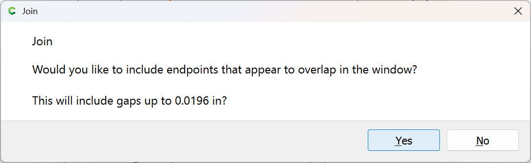

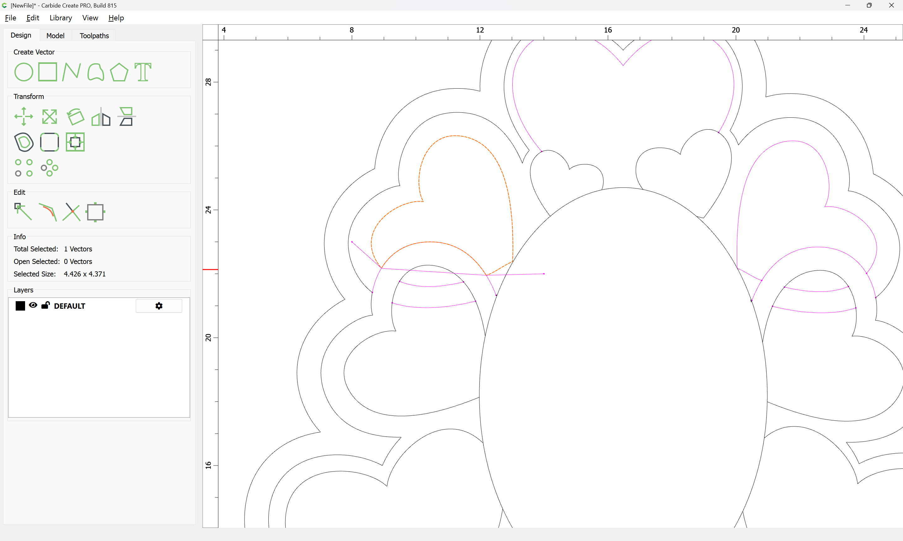

Continue doing this until all regions which you wish to work with are closed.

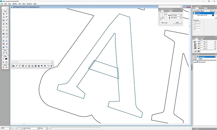

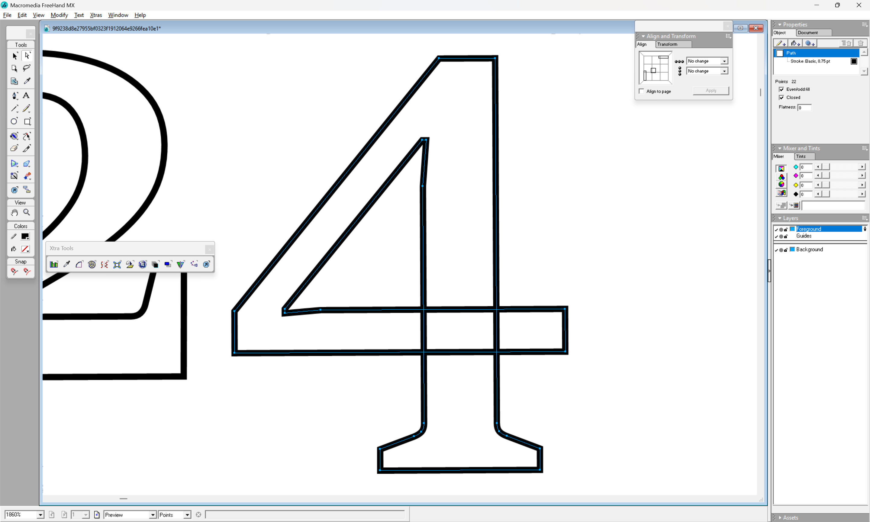

Note however that if there is overlapping geometry it will be necessary to select specific elements to assign toolpaths — probably you will want to put each set of geometry for each toolpath on a separate layer.
