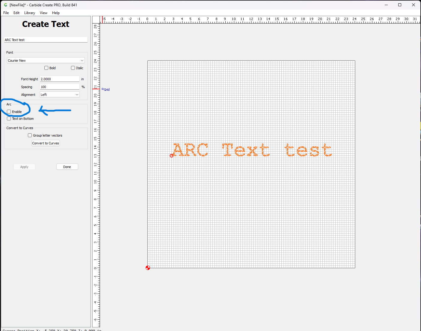

How can I curve words when creating a project in Carbide Create? Looked everywhere and can not find this anywhere in the training videos

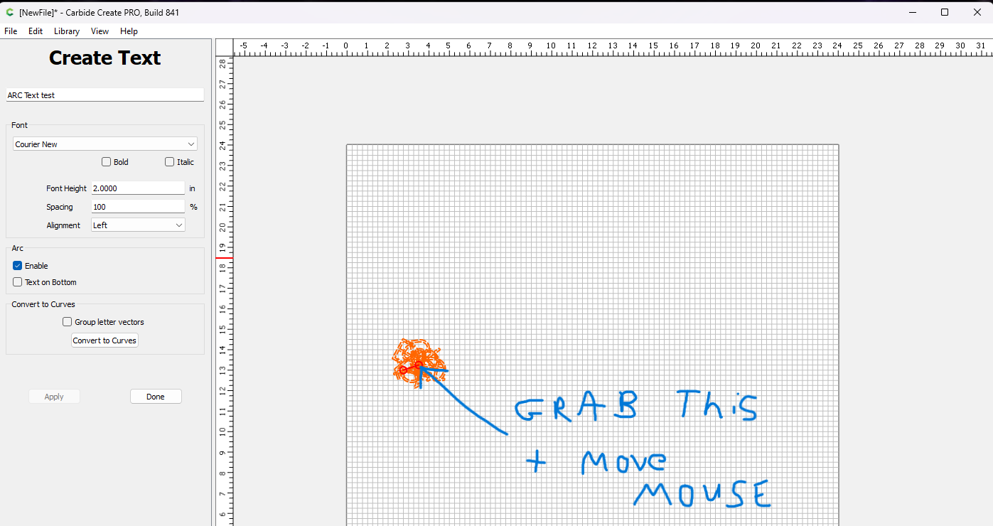

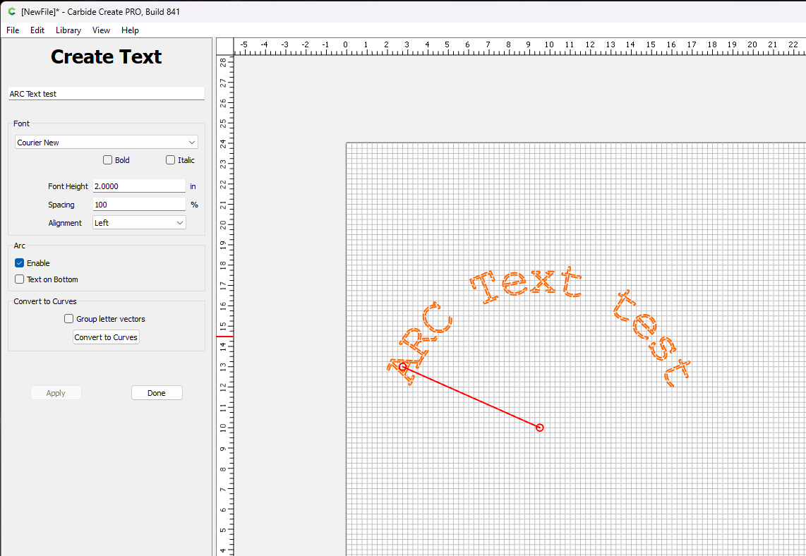

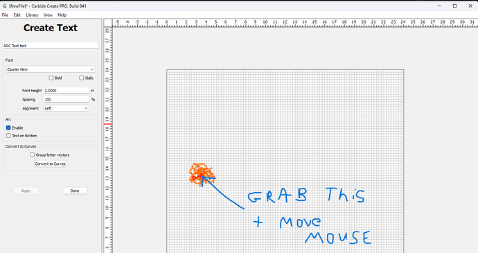

When you create the text you will see a box labeled “ARC” select “Enable” then select the line in the text with your mouse and move it around to get the arc you desire.
Thanks. Worked out great!!!
