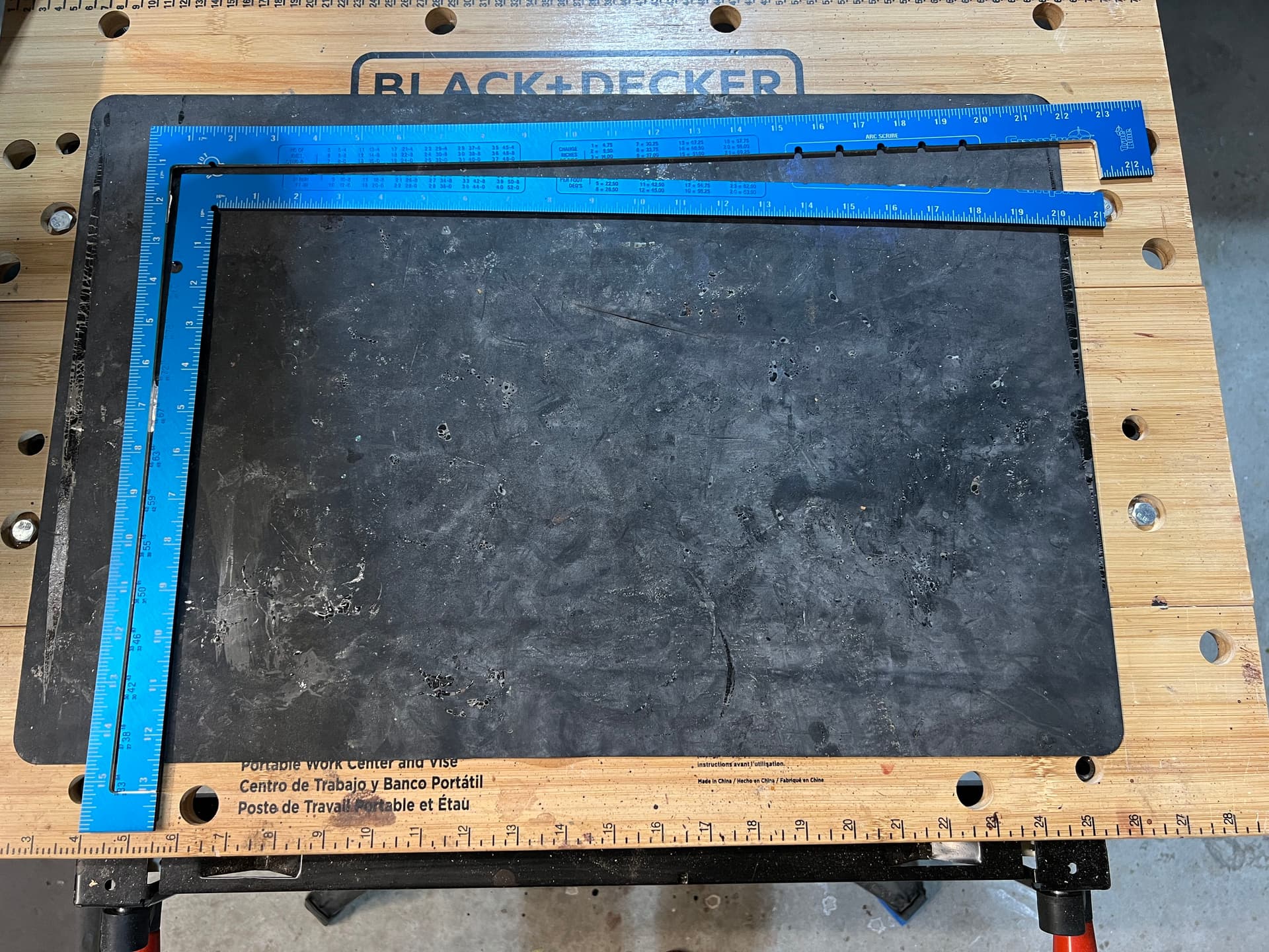

I started with square I purchased from home depot. Just needed to trim it down so it would fit on a laser cutters hex grid. But after cutting it down, both parts of the square decided to not be square anymore.
The cut seemed to do really well, 36ipm, 18000 rpm, 0.01 dpp. The material did not feel hot, so I’m assuming this isn’t a failure in the cutting process, just a failure to understand the material.
So what happened?
Yes, see:
you released the internal stresses in a stamped part, will adams post sort of covers it but more basically you need to stress relieve the part which may in itself cause minor warping especially if not done right.
which brings us to the next point you’re probably unsure of the grade of aluminum used for example 6061 is reccomended 343C for 1 hour but 7075 has results at 413c for 2 1/2 hours
Then technically you would rough it, leave it for 2 weeks then run a light pass with your final so that any new internal stresses aren’t freed, assuming your final pass isn’t going to open the pocket up like the picture above in which case im sure there are even more workarounds required.

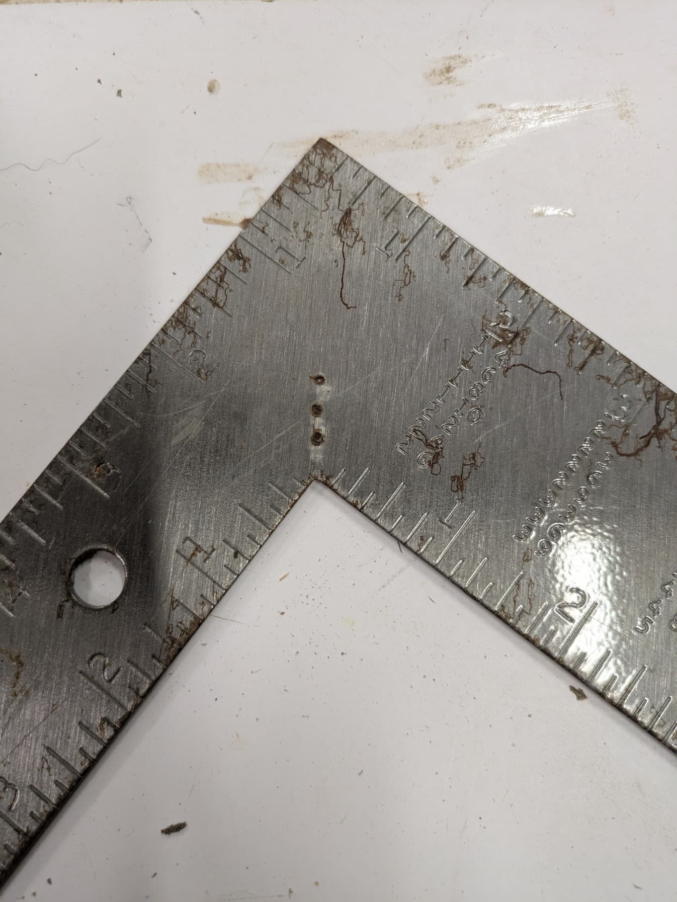

I once bought a new Johnson steel square at Lowes that was not square. As long as the square is straight but not square you can fix it. You use a center punch and make a series of strikes and it will slightly adjust the squareness of a square. If your arms are not straight this wont work. If you punch 3 strikes on one side do the same on the other side.
To test a square for squareness put one arm on a known straight edge like a piece of plywood. Draw a line down the other arm. Then turn the square over 180 degrees and put it close to the pencil line and not over it. Draw another line. If the lines diverge the square is not square. If the two lines are parallel your square is square.

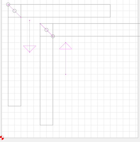

Here is a drawing as an example. The drawing only has two circles but you would put your center punch and make 5-10 strikes. Checking after each strike to see if the square has been brought to square.
If the arms are not straight throw it in the trash. If the arms are straight but not square to each other the punch method will likely work.
