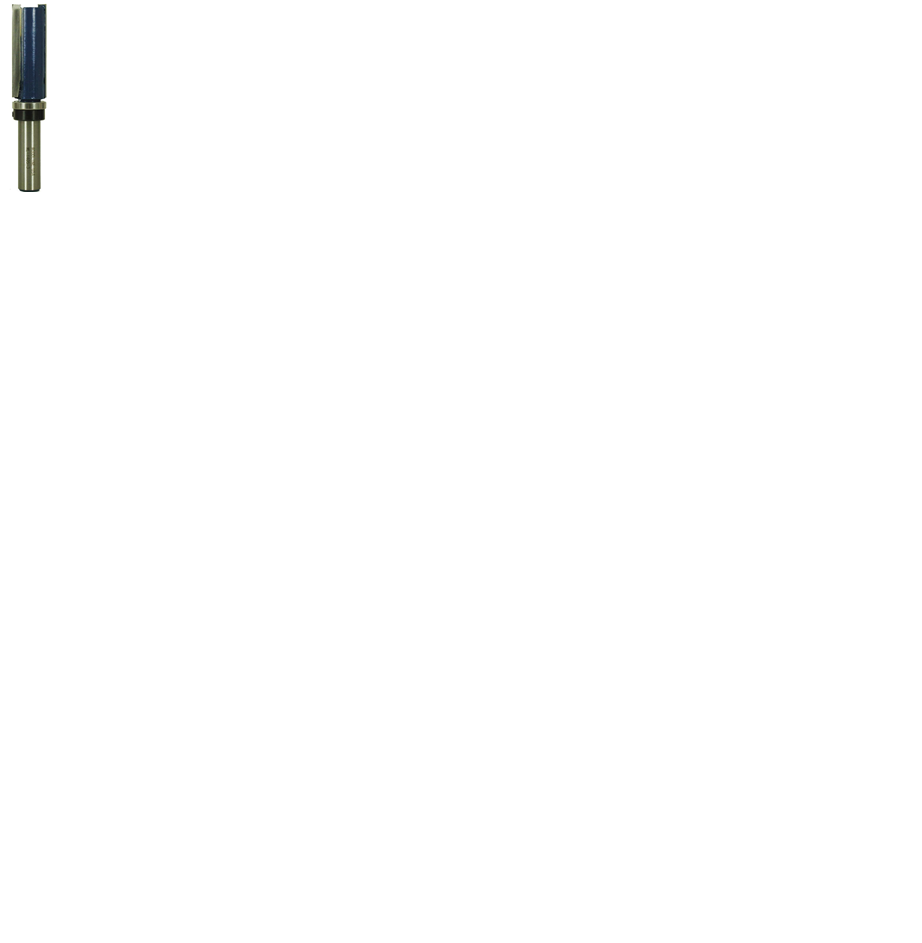

If a pocket is required maybe a hybrid approach would work. Cut your pocket maybe 1" on each side and then use a plunge router with a top bearing to clear out the rest of the pocket. Would be less risky. I recently bought these bits.

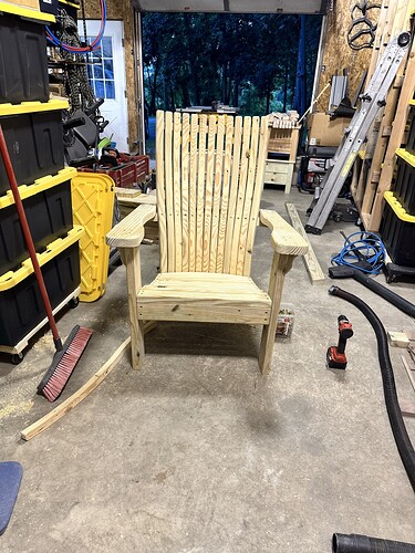

This might help…
I have not tried a 4x4 but I have cut allot of 2x8,10, and 12 on their face and 2x4 on edge with success. The main issue has been the moisture in the big box store boards. Not an answer to your question per say but advice from a broken bit or two because my feeds for what I thought was dry wood didn’t work out. I can imagine if I was doing what your are talking about I would turn the feed down and bump it up if needed in carbide motion.
