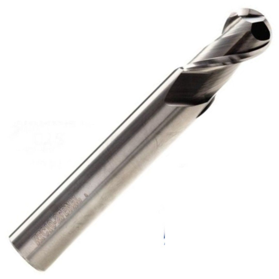

the 6061 cuts really nice on these machines with O-Flute tools. I even bought some O-flute ball mills.

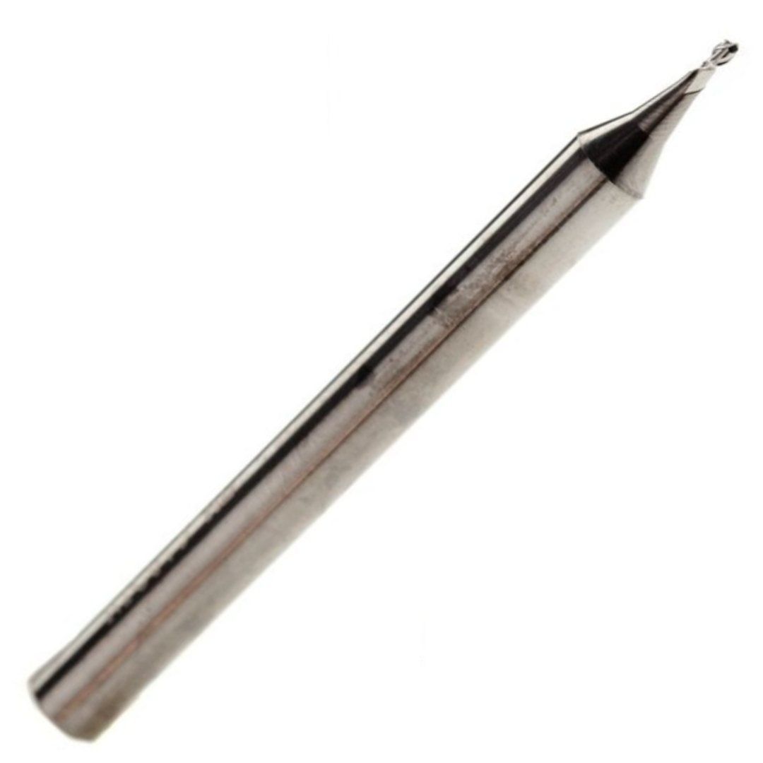

Yup, I have a good range of them but have not used 0 flute ball mills. It is good old Rennie tools for my carbide ballnose endmills that are specifically for cutting aluminium. See here for sizes 1mm ~ 20mm:
For sizes from 0.2mm ~ 0.9mm for cutting aluminium, Rennie has this range of ballnose endmills: All of these smaller sizes are priced at a very reasonable £5.29 ($6.73) per piece including taxes.
All are relatively good value and very good jobbers quality so some cutters I have had almost 9 months use from.
