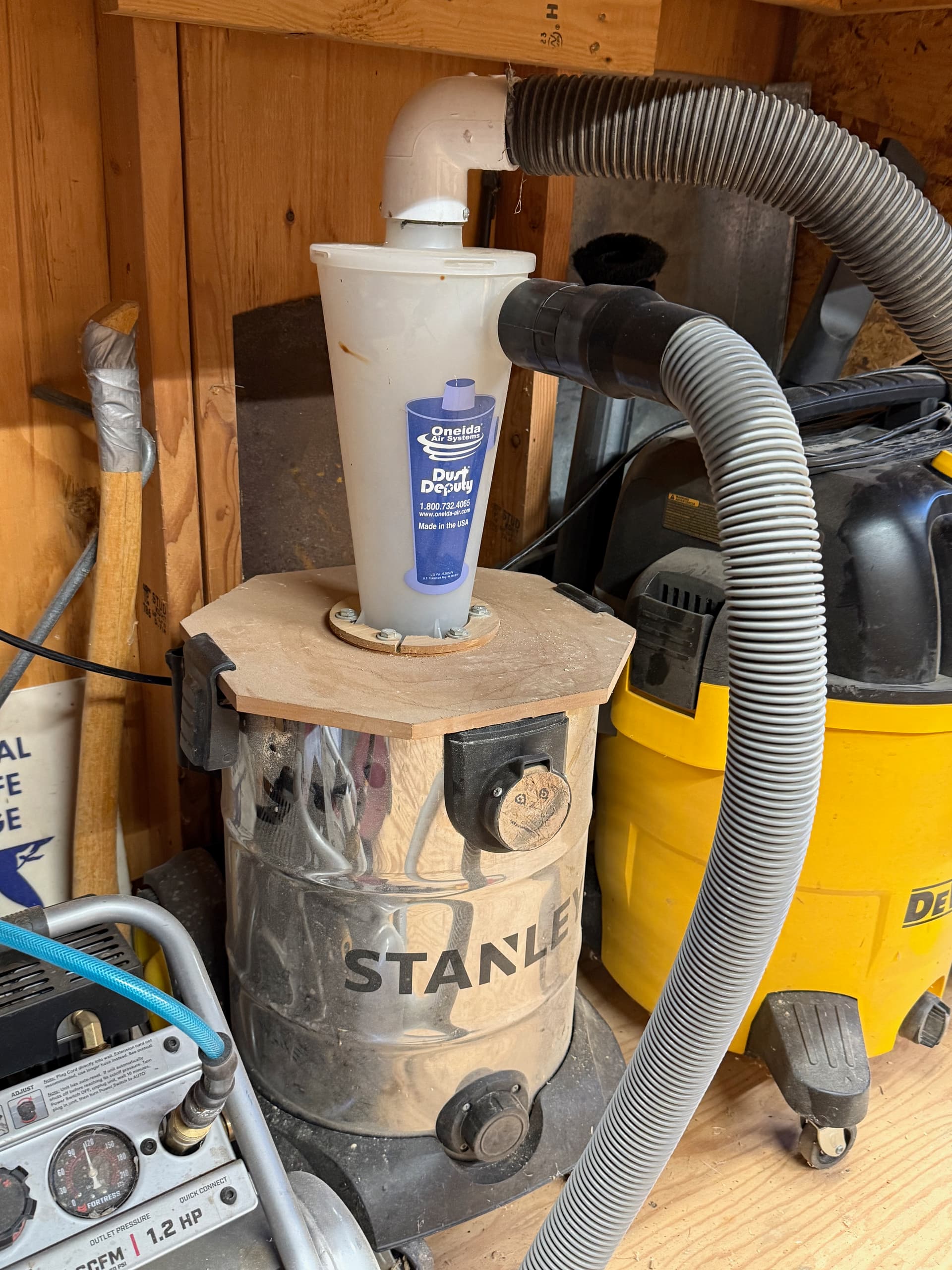

You could repurpose the bottom half of the old shop vac to a dust collection bid.
