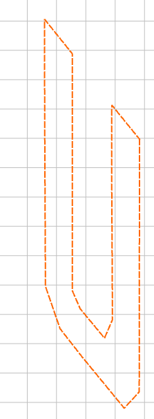

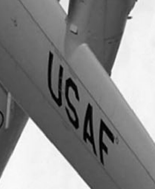

Trying to skew, not merely rotate the letters “USAF”.
by about 50° so that it mimics the USAF shown below.

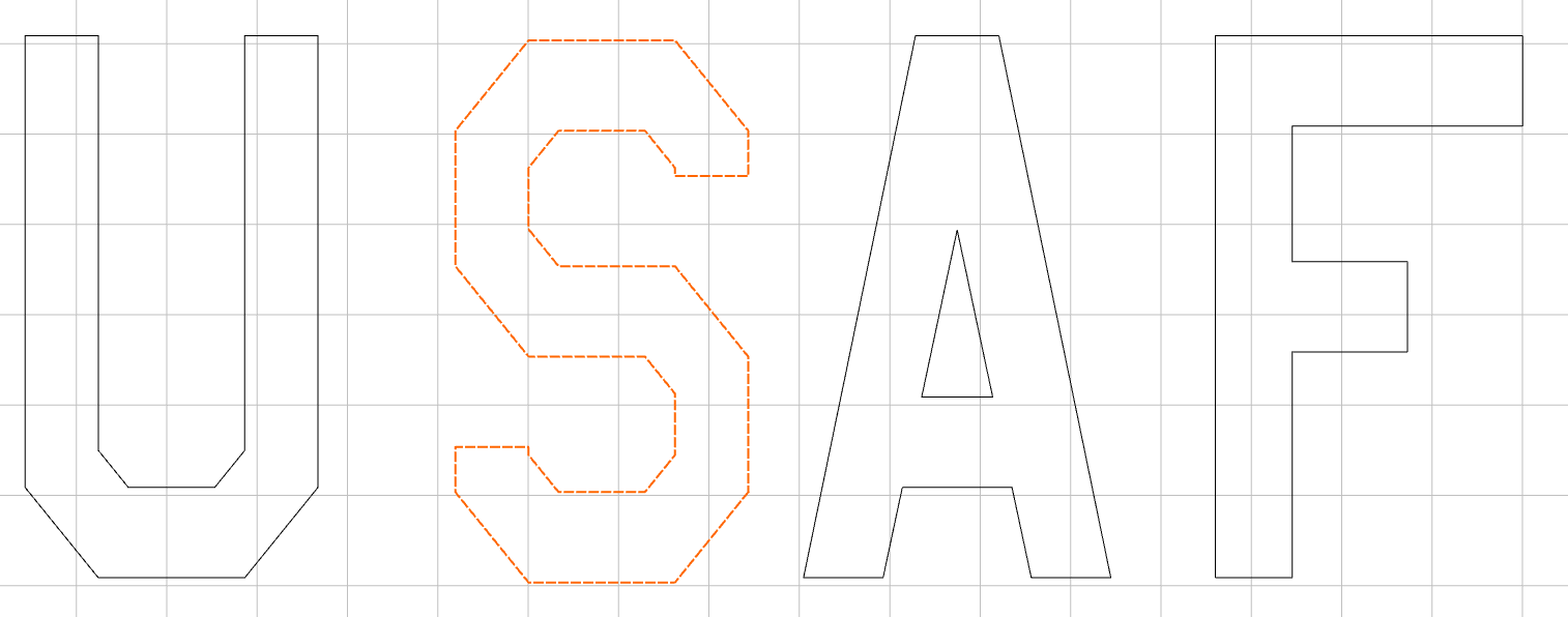

FYI, the font used on AF planes and a lot of other military stuff is AmarilloUSAF . I had to download and install it. It’s about as plain as a font can be.
Since U A and F each only consist of about a dozen vectors, I’ve been able to take them apart using Node Edit and reshape the letters as needed, like the U :
When I got to the letter S that’s pretty much what I said.
Any easy way to accomplish what I’m trying to do?

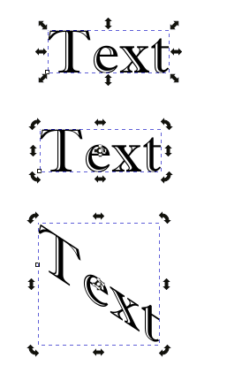

In Inkscape
Create the Text you want.
When you select the Text the normal resize arrows appear.
When you select a second time Rotation and Skew arrows appear.
