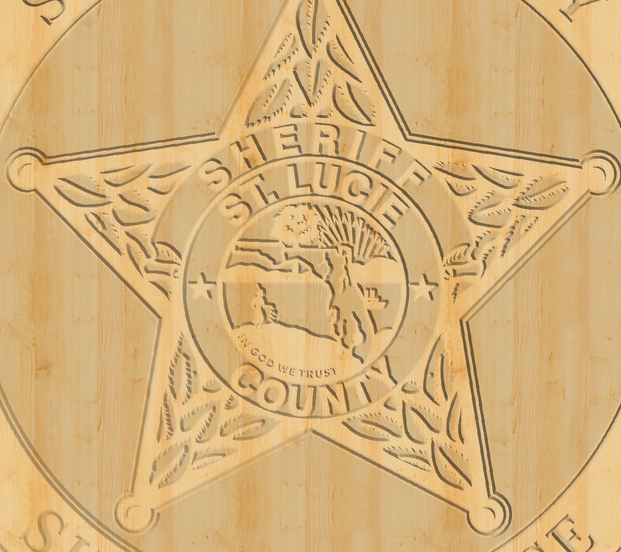

As this is just a vector file, unless you have Carbide Create Pro, you can only perform 2D toolpath operations with this. This would require setting up various parts of the vectors to be pocketed or cutout at various depths using both large & small endmill diameters.
If you have CC Pro, you can 3D model all/part of the vector for 3D carving toolpaths with ballmills.

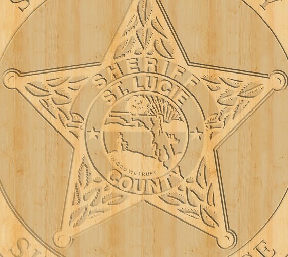

I’d probably do a couple of V-carves, like this.
SLCSO emblem for podium.c2d (928 KB)
(That’s not optimized in any way, it’s just to show another approach)
I didn’t look at @robgrz file but here was my kick at the cat.
Rev SLCSO emblem for podium.c2d (1.9 MB)
Thank you, The vcarve on the outer band makes it much cleaner.

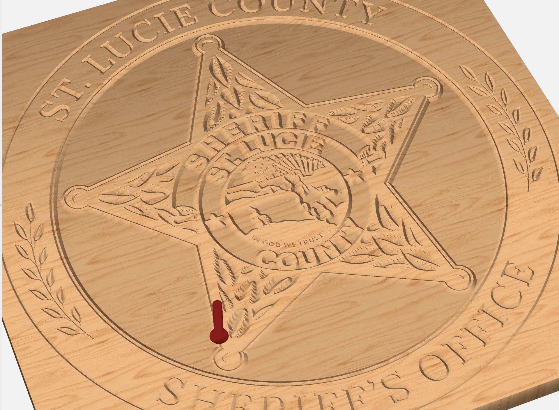

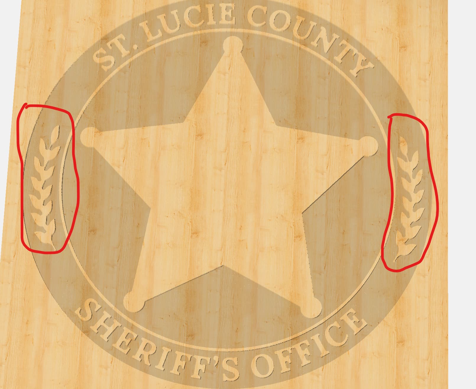

How do I get the details in the leaves to appear better with the carve?
I changed the 90 to a 60 degree bit for better detail. I think that makes the letters pop a little more.
The V-carve toolpath is great for getting into the tighter areas.
A finer point lets you get deeper into tighter areas, and a wider V cutter gives a nice taper on the walls of larger areas. It’s purely personal preference.
Ungroup the laurels then select each of the lines and apply a shallow vcarve to them…Sorry I didn’t catch that
SLCSO emblem for podium EDIT.c2d (1.5 MB)

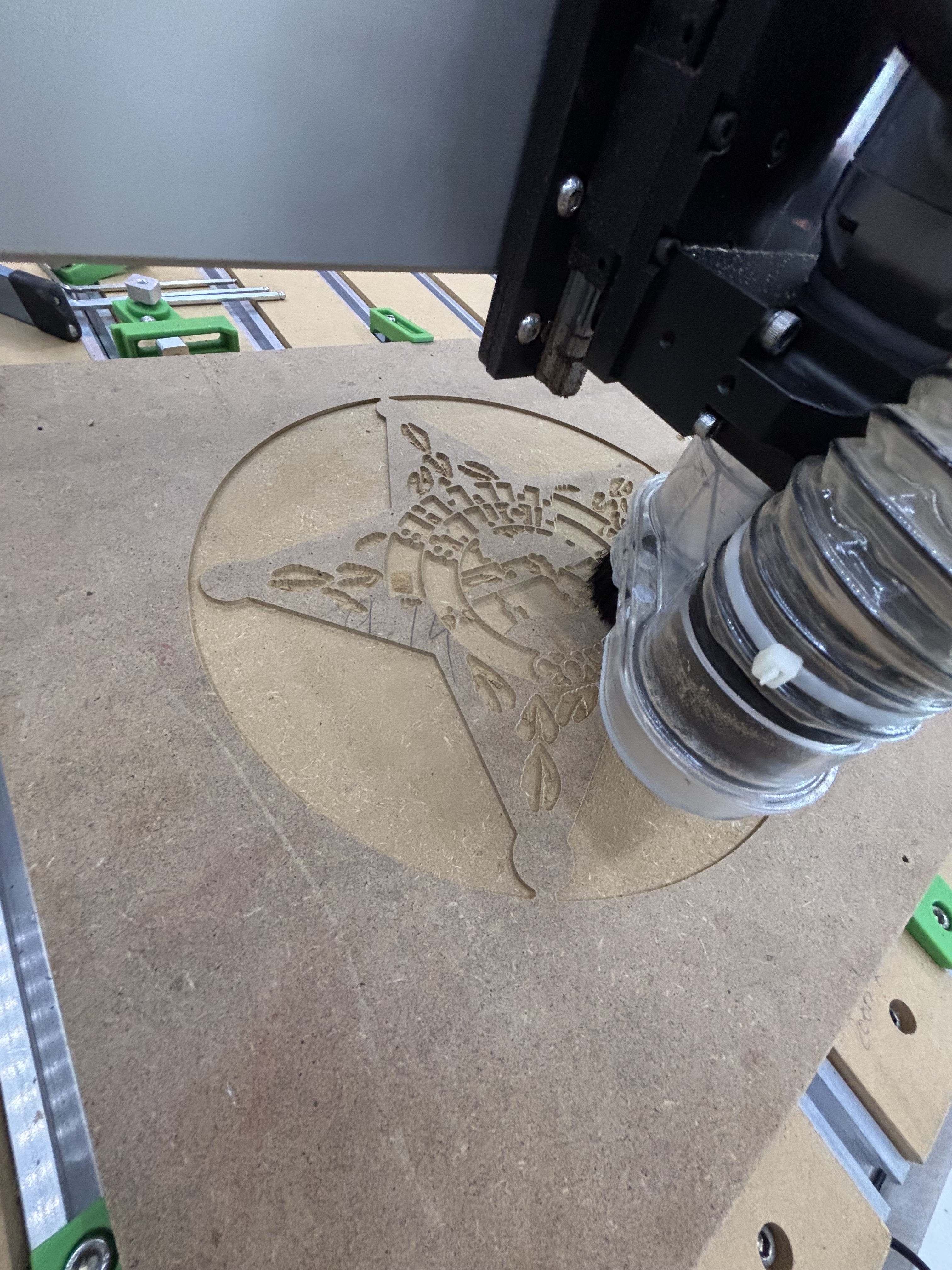

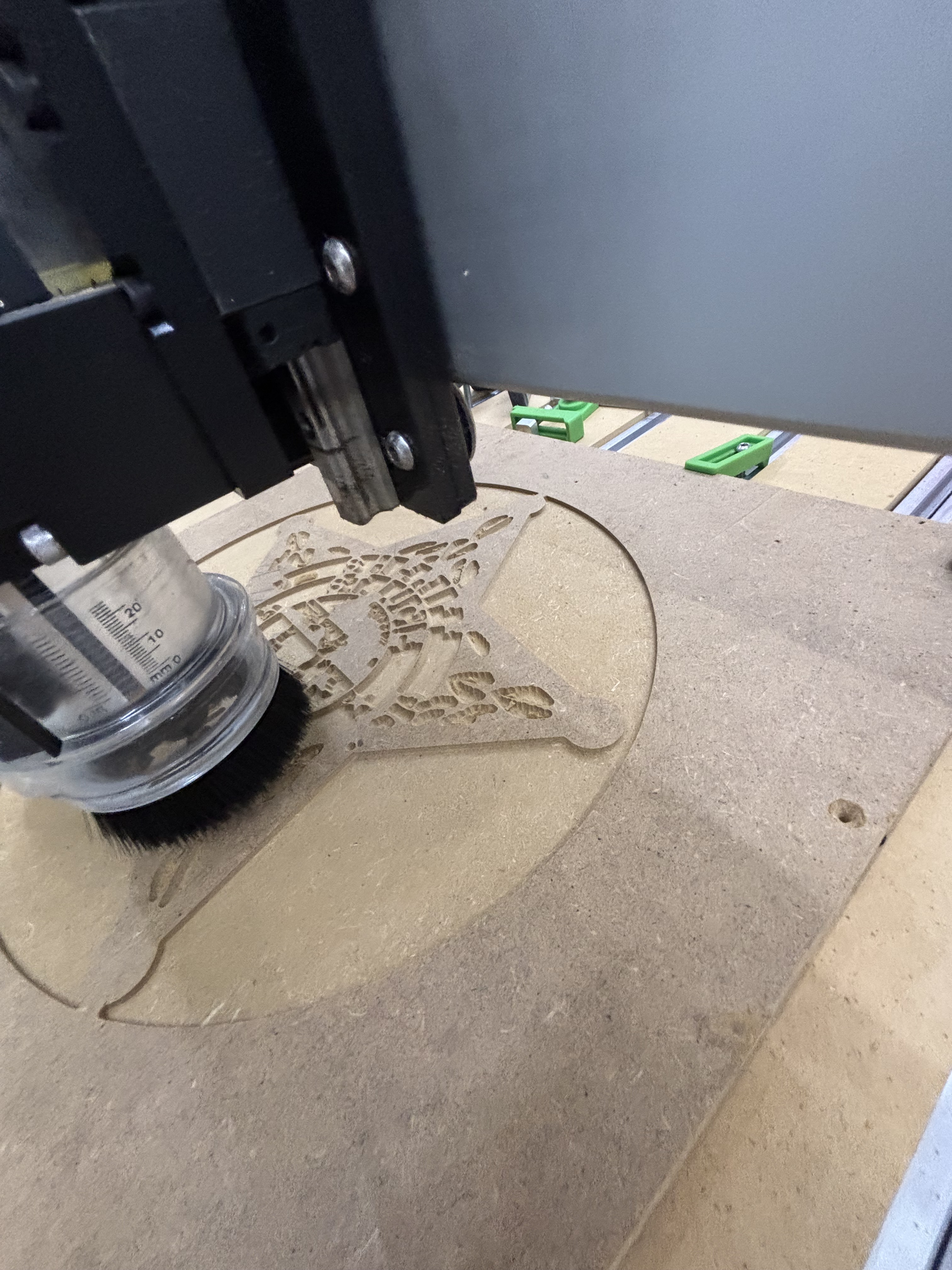

I made some changes to the file and worked the tool paths. Maybe this will work. The tool paths will still need some optimization.

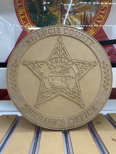

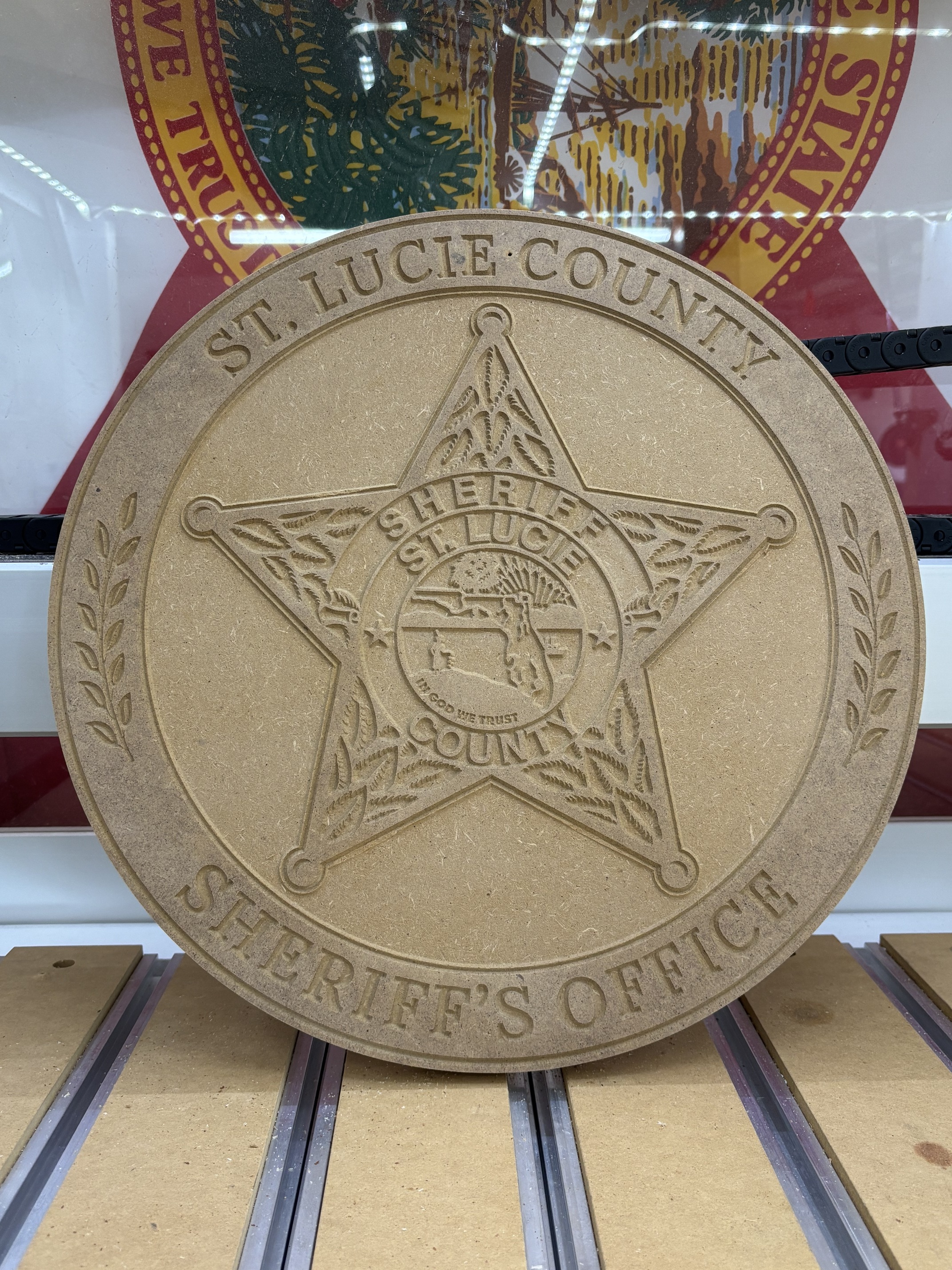

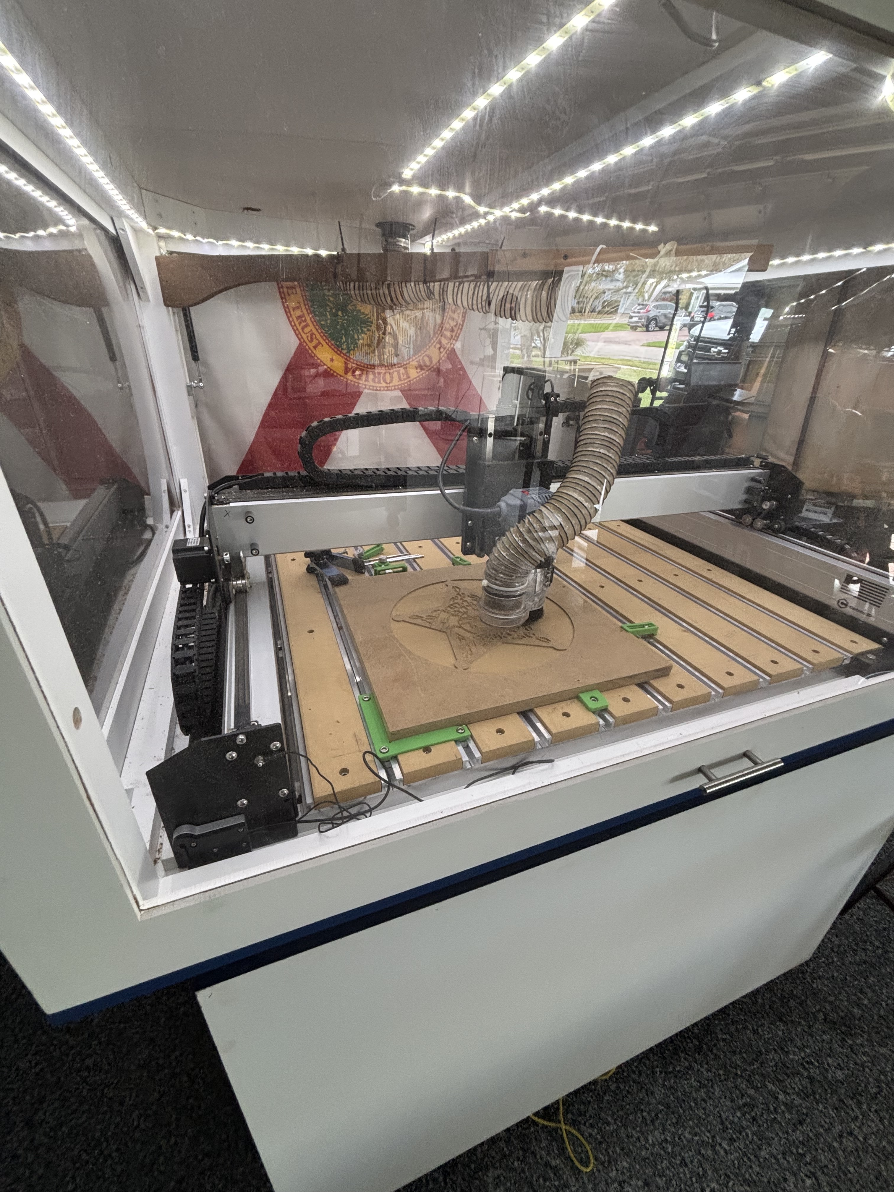

Running a test on some MDF before going to walnut. So far so good.

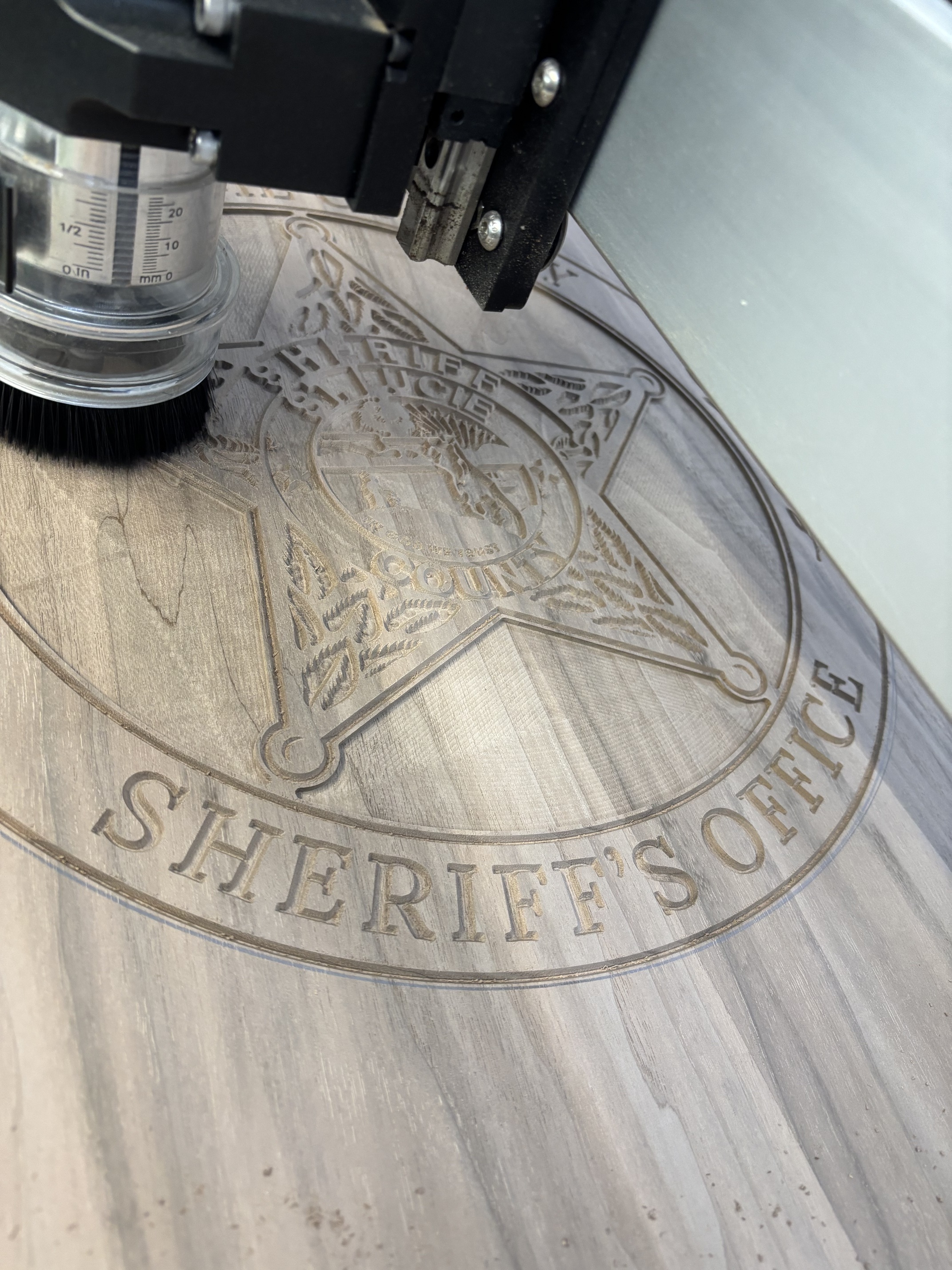

Not bad fellas! I’m pretty happy with that. I’m gonna try one more example from another suggestion.
The hole on the top was there already. Just a piece of scrap.
@SwatBoss226 That trial run looks pretty good!

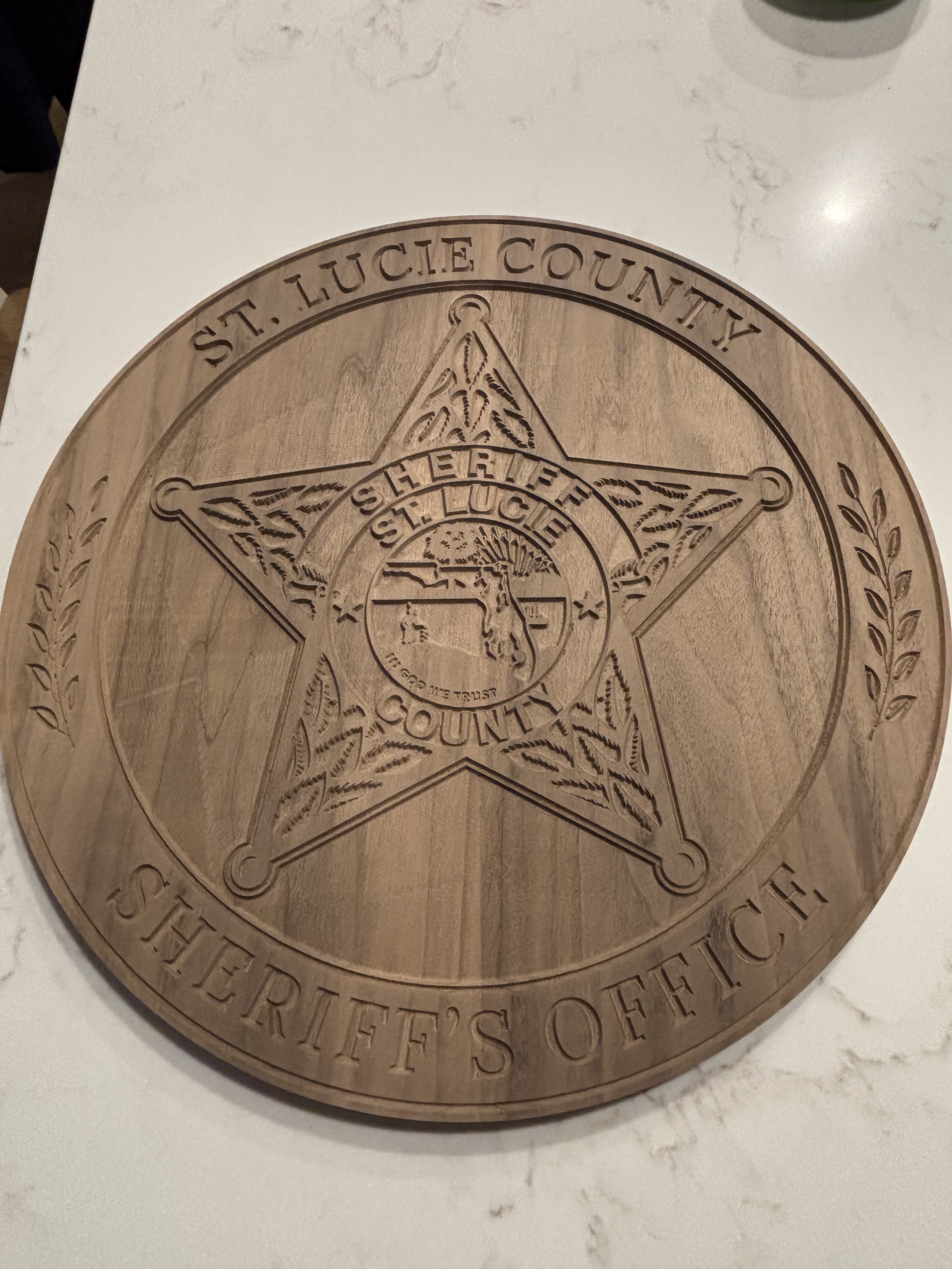

The Final Cut went well. Now to sand it and add it to the front of my custom podium. Final piece will be presented soon.
