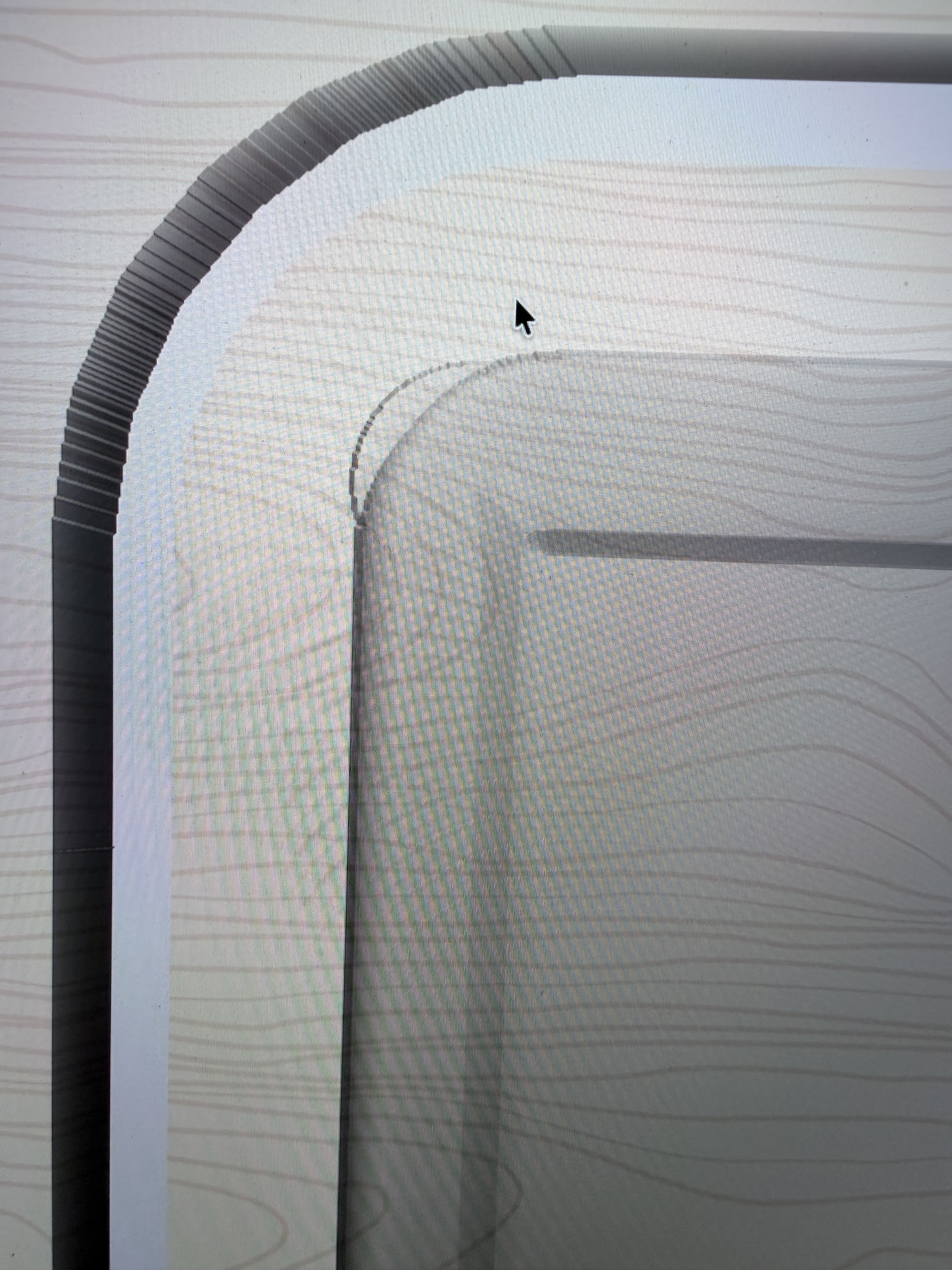

Am I missing something? I have gone through all my toolpaths and cannot figure out what this is.
Upload the file?
I am going to guess that there is a stray contour assigned a No Offset or Outside Contour or Inside Contour.
Anytime you have a question about a file, it’s better to upload that file here so we can take a look.
Yes, that’s what it was. My contour toolpath was too close to that pocket path.
