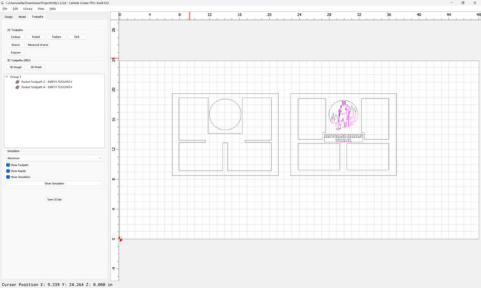

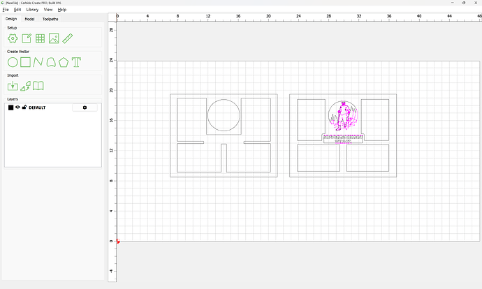

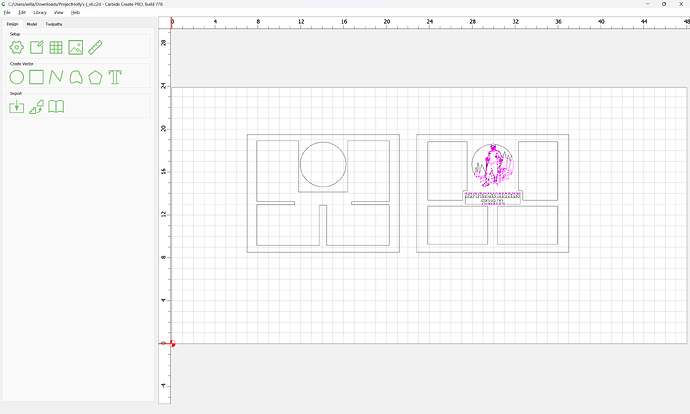

This is a v6 (or earlier?) file:
It will need to be opened in v7:
and re-saved, which will then allow opening in v8:
The design is pretty straight-forward, except that there are a number of unclosed/open curves (indicated by being magenta) which will typically only cut as expected when one applies a No Offset Contour toolpath.

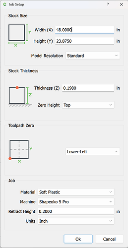

The dimensions are well-within what an SO 5 Pro 4x2 can cut:
(and if cut one side at a time, should fit in a 2x2)
Attached as a v8 file:
ProjectHolly’s {_v8.c2d (236 KB)
For toolpaths see: Types of Toolpaths
