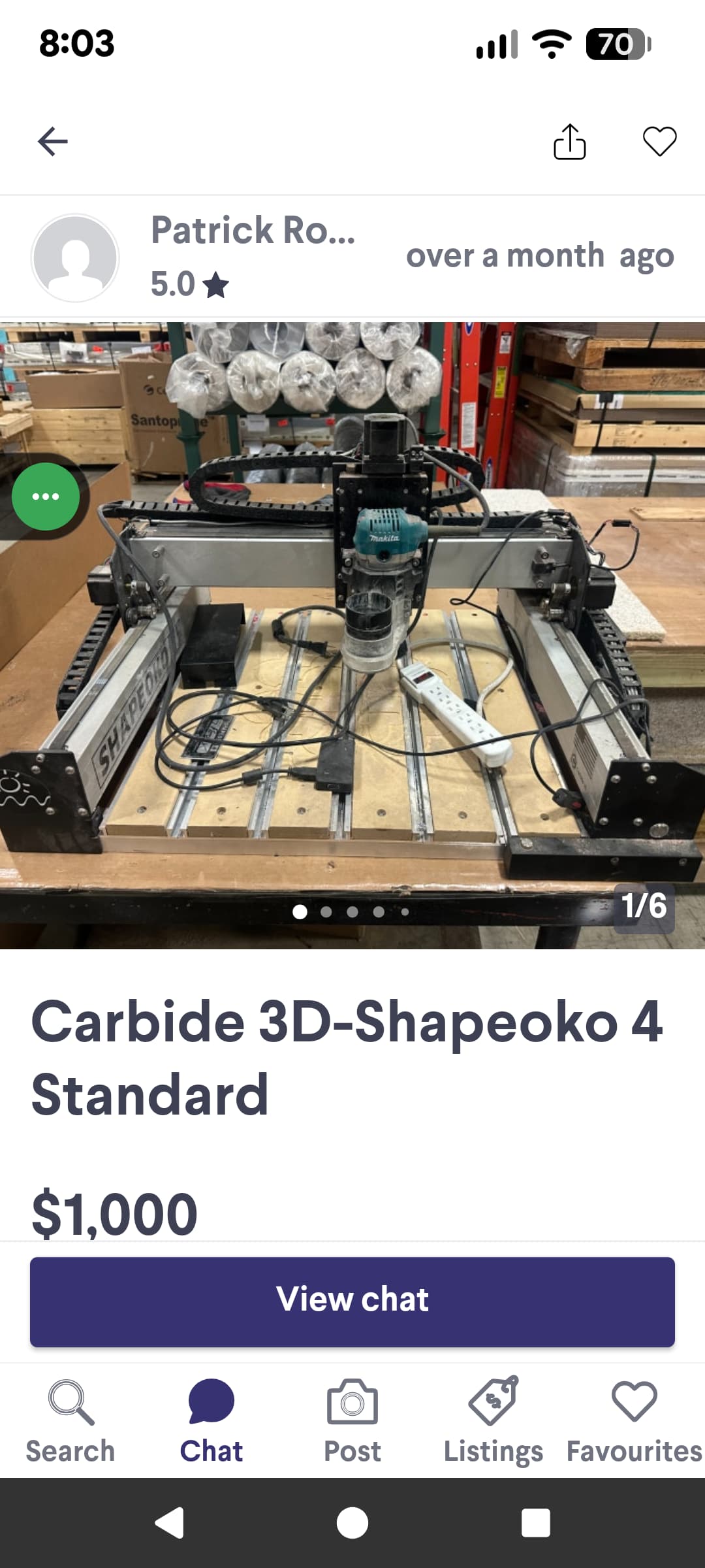

Hi…I’m thinking about getting into CNC routers… there is a shapeoko here for sale at 1,000 dollars is that a good deal??
It’s a 4

Thanks okay Will do…I posted a picture of it
It’s a 2.5 hr one way to go look at it and weather is awful here so just want to make sure I get all the information… would like to see it run of course
Well, considering the new price is $1,800 that is in the ballpark of what I would be willing to pay.
It now comes down to what you want to do with it. It’ll do everything you want - unless you want to cut aluminum. What I mean is - you can cut aluminum with it just fine. I have a SO3 and I can cut aluminum. The problem is once you learn how to cut aluminum it becomes frustrating with a SO3 or SO4 because of the V wheels. You have to take very shallow cuts and you can’t go too fast compared to the Pro or the SO5. If you feel like you will be doing more than a tiny bit of aluminum I would look for something with linear rails. Otherwise it’s a great machine and a pretty good price.

A huge factor should be - how a big are the projects you might want to consider? This machine is listed as the ‘Standard’ size, which is the smallest.
There’s also how much room you are willing to dedicate to the machine (the footprint)
Size (Standard)
Cutting Area 17.5"(X) x 17.5"(Y) x 4"(Z)
Footprint 33" (X), 24" (Y), 19" (Z)
Size (XL)
Cutting Area 33"(X) x 17.5"(Y) x 4"(Z)
Footprint 50" (X), 24" (Y), 19" (Z)
Size (XXL)
Cutting Area 33"(X) x 33"(Y) x 4"(Z)
Footprint 50" (X), 41" (Y), 19" (Z)

@Dano77 I’m SW Ontario here and I have a 4 Standard as well. From the pic you posted it looks like a decent setup. If all you are going to do is brands from brass or copper then the standard size is a good choice. $1k is a decent starting point.
Find out how old it is. As I found out with my recent purchase of a used 4XL if the V wheels are white then its an older machine. Look at the belts for condition. Are there endmills, workholding clamps, spare parts and tools with it? Does he have Vactra2 oil for it? sounds weird but its impossible to source in small quantities in Canada.
Have the seller run it for you. When he is connected to the machine have him open up the settings in Carbide Motion and see how many hours are on the machine as well.
Good thing is that you can likely get a maintenance kit ($125) new wheels, belts and stepper motor pulleys from robotshop.com who is the Canadian reseller of Carbide3D products. Check out their website.
