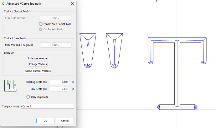

No matter how deep I set max depth in “Create” the cutter seems to have icxx own max and it’s much less than I want or what the max depth is in “Create”. I’ve tried the latest version of Create with the same results.
Is it hitting the lower physical limit of the Z axis? If so, you may need to move the router/spindle down.
If you are using V-carve to cut between 2 close vectors, it will only go deep enough to touch both vectors. It will only use the max depth if it is less than that distance.
Worked just fine 2 days ago. I’ve been trying different fonts and when I came back to the old file this depth thing happened.

It’s all narrow text. Looks like the deepest/widest spot is the apostrophes. This is at 0.040" max and you can see it hitting that in the apostrophes. About 0.045" is as deep as it will ever go. You can set the max depth to 10", and it will still only go 0.045"
If you want the letters a little wider, you could set your Z zero a little bit below the top of stock.
Otherwise, the only way to get it to cut deeper would be with a smaller angle V-bit.

Hi Tod1d,
I was wondering this myself … Would setting the Starting Depth to something other than 0.000 in here accomplish the same thing as “setting the Z zero a little below the top of stock”?
That way you could have a “true Z Zero” for other operations and be able to widen just a particular VCarve.
Yes, it would. It will trace the width of the vectors at the start depth, making the width at the top of stock wider.
It will also calculate the depth per pass starting from the start depth, so the first cut will be deeper if that material hasn’t been removed.
