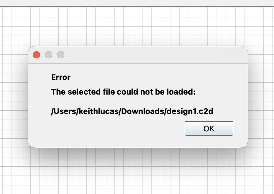

Hi folks! I’m wanting to do some of the projects on CutRocket, but the two I have tried to download will not load in Carbide Create. I get the following error:
The latest this has happened is from this listing.
Any thoughts? I’m on the latest version of Carbide Create Pro… which, weirdly, I can’t find a version number for in the Help menu.

It’s an old file …You need to open the file in version 7 save it then open it in version 8

That… is a useful piece of info! Thank you Jeff!
