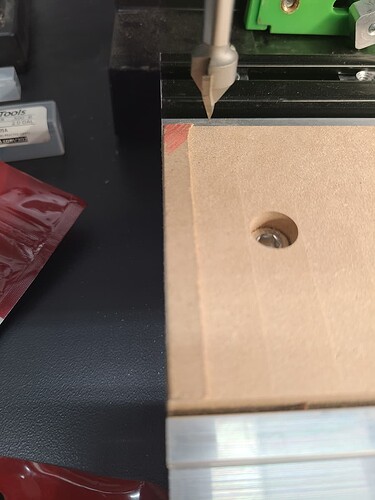

It did not cut on a diagonal, it cut the first couple of slats further to the front. In the below photo I chalked the raised, uncut portions of the slats to better show what was and was not surfaced. I also removed them from the machine to better show the differences. Slat 1 is the furthest one to the right of the machine when standing in front of it.
I made my own file, but it is accentually the same thing. I think my stock size was larger to actually match the 25" length of the slats. I don’t think it would have matter as when jogging the machine, the Y axis just does not go all the way forward. See photos below in my follow on reply to Guy…
The short answer is yes, I can physically move it forward more than the machine will go when just jogging it.
This is how far forward it will jog on its own (note, that is in the front left or SW corner)

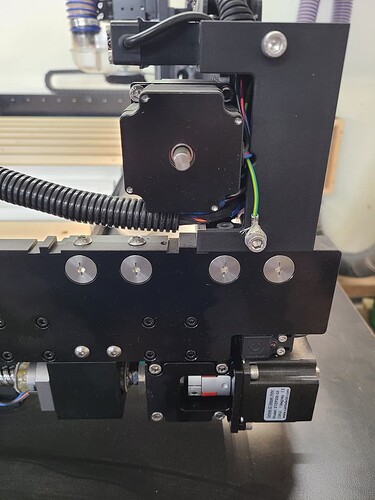

This is a photo of the left side Y screw in that same position.
After powering the machine off and manually pulling the gantry as far forward as it would go, this is where it stops. (note, the machine is in the SE position in these photos)
And finally the Y screw in that same position.

Again, it is my understanding that you may be making some incorrect assumptions here. The “official specs” list the machine travel at less than the slat length, so when you have jogged all the way forward the “center” of a V bit will not reach the front edge of the slats.
The difference is made up by the extra large diameter of the surfacing bit.
You included a picture of the machine jogged all the way forward with a V bit in the chuck. Maybe put your surfacing bit in and repeat that picture?

I appreciate all response Charlie. Good or bad that is how we learn. I can retake the photo in that location with the 1" McFly, but the photo I already posted above shows where the McFly actually cut to. So I know the extra width of that cutter did not compensate for the additional length of the slats. What is really odd to me is that it cut further forward on the first two slats.
Do you have a 5 Pro 2x4? If so, would you mind jogging all the way forward and then taking a pic of the Y screw on the side? I’d be interested to see how much screw you have showing compared to mine.
